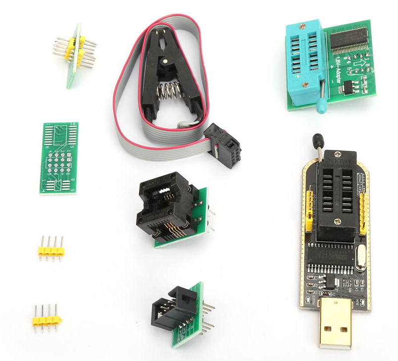

    I have the exact same laptop as the others, Lenovo IdeaPad 330S-15ARR - 330S_ARR_V06.
    I have exactly the same problem as everyone else. I turn on the laptop and see the power led. I can hear the CPU fan, but the screen is black.
    If I understood correctly, I need a CH341A programmer. With the help of the programmer, I have to get the flood bin from the chip.
    I load the flood bin and bin from the manufacturer into the hex editor.
    From the old bin, I copy what is important (uuid, product name, sn, etc.) to the manufacturer's bin.
    I burn this resulting bin into the chip using the programmer.
    Did I write it correctly?​

    I want to buy a programmer in a local e-shop. In NTB I have this BIOS 25q64fwsig. This BIOS supposedly works at 1.8V. Do I also need a 1.8V adapter for the programmer?
    The eshop shows that the programmer also supports WINBOND W25Q64.
      yes, if the chip works at 1.8v...
        • 20475
        #144
        There`s more info about the CH341A here https://www.badcaps.net/forum/troubl...21#post1622421 .

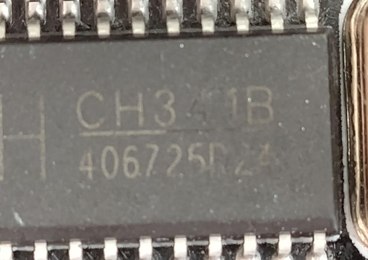

          I ordered this programmer and I am waiting for delivery. I've read this thread and now I'm confused 🤔

                    Hello, I would like to ask a question. After a lot of problems with the delivery company, I finally received the programmer (see # 145 post). However, when I looked at the chip, I found out that it is not CH341A, but CH341B (the eshop declared CH341A).
                    Will this programmer also work?

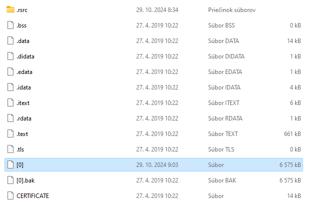

                              #156
                              Thank you. I followed your instructions in post #29.
                              First, I downloaded the official bios for my NTB from lenovo's website.
                              I'm not sure if I extracted the bios bin correctly from the exe file.
                              I used the 7zip program to extract. From the extracted files, it seems that bin will be this file [0] (6575 Kb). However, when I open file [0] in HxD, I don't like it at all (I am attaching file [0]).
                              Can you please check if [0] is really correctly extracted from the exe file?​
                              • volinakis
                                • Jan 2021
                                • 2666
                                • N/A
                                #157
                                you have to use innoextract to get bios image from update. Then edit with any hex editor to get right length - 8.388.608 bytes. Then transfer DMI.

                                • gusto
                                  • Oct 2024
                                  • 34
                                  • Czech Republic
                                  #158
                                  I used innoextractor and extracted bios.cap, but there was no match out of 8,388,608 bytes.
                                  So I uploaded the one you gave me to the bios. I started NTB and it works great.​

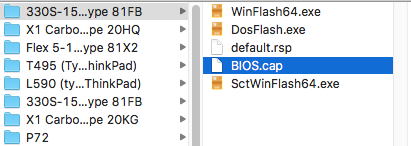

                                    #159
                                    Click image for larger version  Name:	Screen Shot 2024-10-29 at 10.50.14.png Views:	23 Size:	25.1 KB ID:	3494803
                                    try this one:
                                    I would like to ask again.
                                    Using innoextract in Linux, I extracted this from the exe file
                                    Code:
                                    -rw-rw-r-- 1 gusto gusto 8946928 dec 18  2019 BIOS.cap
                                    -rw-rw-r-- 1 gusto gusto      55 dec 18  2019 default.rsp
                                    -rw-rw-r-- 1 gusto gusto  524800 dec 18  2019 DosFlash.exe
                                    -rw-rw-r-- 1 gusto gusto 7191544 dec 18  2019 SctWinFlash64.exe
                                    -rw-rw-r-- 1 gusto gusto  465912 dec 18  2019 WinFlash64.exe
                                    If you notice the BIOS.cap has 8946928 bytes. However, the file BIOS.bin.zip that you uploaded to the forum has 8388608 bytes.
                                    Code:
                                    -rw-r--r-- 1 gusto gusto 8388608 okt 29 11:21 BIOS.bin
                                    Am I making a mistake somewhere when I open BIOS.cap in the hex editor?
                                    Do I still need to do something with BIOS.cap?​
