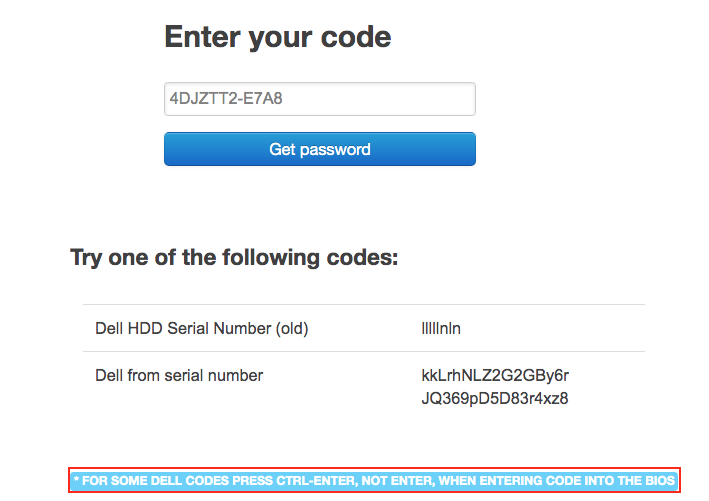

                        • Razvy
                          • Nov 2024
                          • 3
                          #154
                          Can you please help?
                          System number is: 4DJZTT2-E7A8
                          Tried https://beta.bios-pw.org/, but is not helping. Gave me kkLrhNLZ2G2GBy6r & JQ369pD5D83r4xz8​, but none of them are working, and i can't boot from USB to reinstall windows on new SSD

                            • Razvy
                              • Nov 2024
                              • 3
                              #156
                              Originally posted by m.sabry2110
                              upload your file
                              MAnaged to do it with first password, seemed i needed to predd Ctrl + Enter, not just Enter.

                                #157
