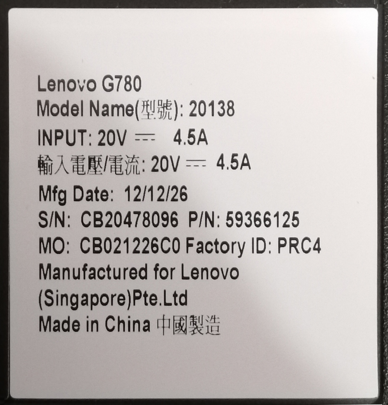

    I need bios dump for G780 QIWG7 LA-7983P with whitelist removed. Thanks.

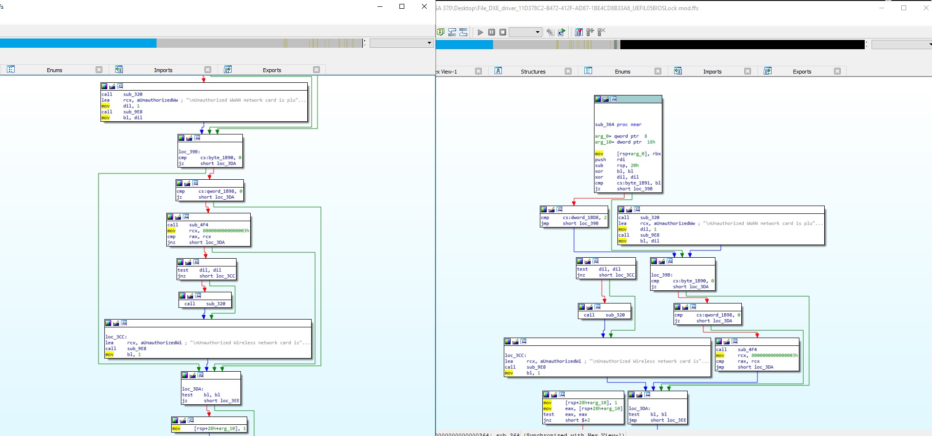

      Thanks, but still "Unauthorized Wireless network card is plugged in. Power off and remove it".

        @imranromi might be able to help,post your bios .
        https://www.badcaps.net/forum/showthread.php?t=76727

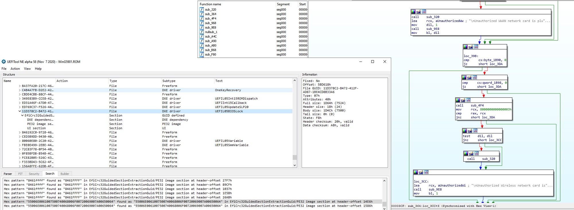

              Originally posted by NemoSUN
              I have Lenovo G780. Please, remove whitelist from BIOS WinG5901.ROM. Thanks.
              Try this
              UEFIL05BIOSLock
              11D378C2-B472-412F-AD87-1BE4CD8B33A6
              75 17 to EB 17
              75 18 to EB 18
              74 10 to EB 10
              75 F8 to 75 00
