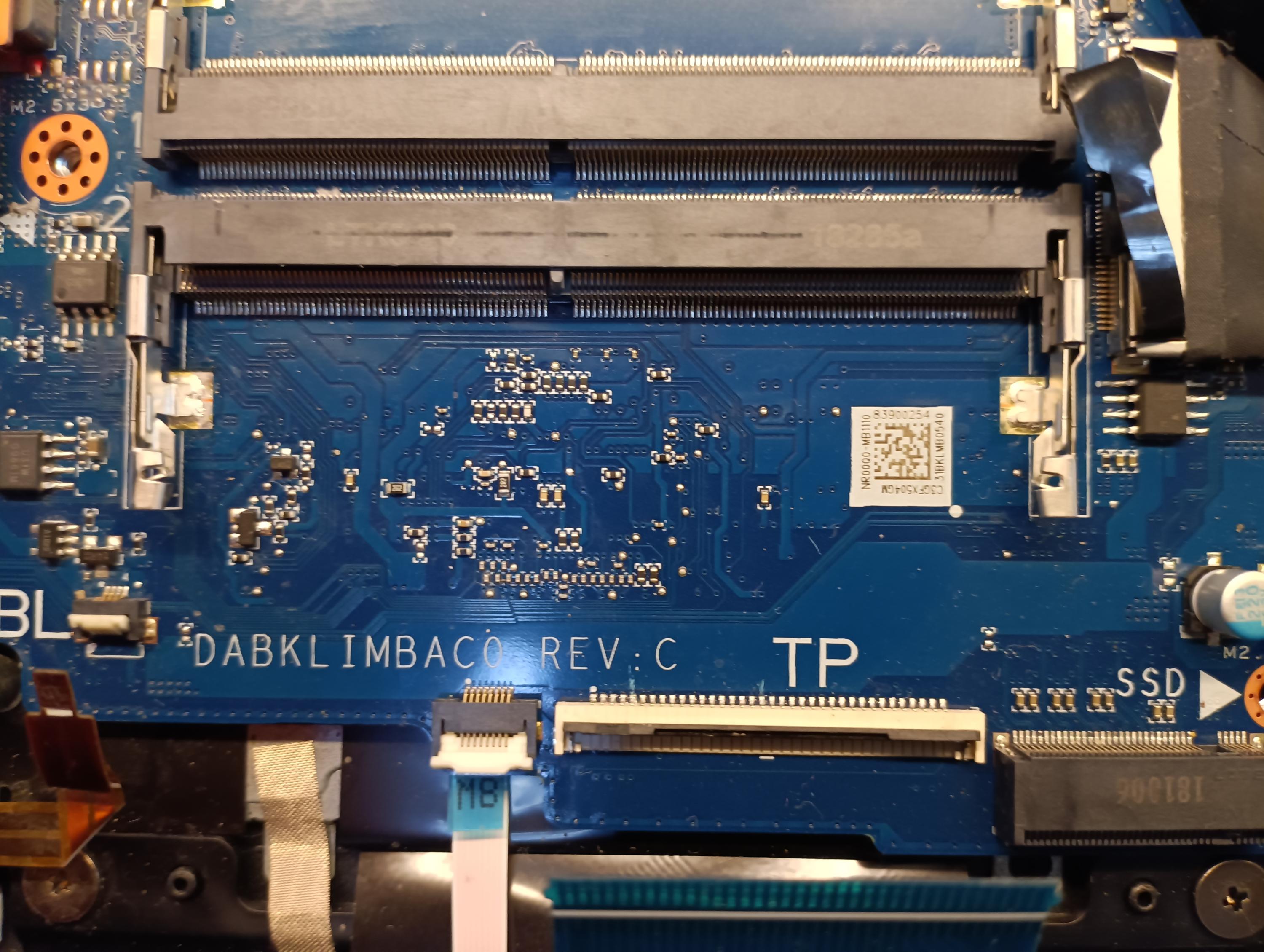

            Re: ASUS FX504 bios dump needed!
            Hello. I need dabklimbaco rev c bios for repair. I have got corrupt bios but need complete bin. Thanks

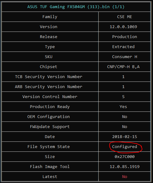

                                Is this a clean me bios ? I am asking because i need it to be clean me.
                                I have replaced the kbc (sio chip) with a new blank one and i want to flash the bios with a clean me one so that at first power up the kbc will be self programed and hopefully my machine will work.

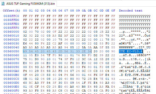

                                  Please, it is very important that i flash the correct bios firmware with clean me since i only have one shot for correct programming of the SIO chip.

                                    Yes, the ME Region is clean and the BIOS has EC firmware inside it.
                                    Remember to do verification after flashing the BIOS.

                                      By the way , which program do you use to read the.bin file ?
                                      • hardware1
                                        • Sep 2021
                                        • 2916
                                        • N/A
                                        Re: ASUS FX504GM bios dump needed!
                                        Originally posted by HellasTechn1
                                        Thanks !
                                        If you asking for which Hex Editor I use to open the bin files, I use HxD.
