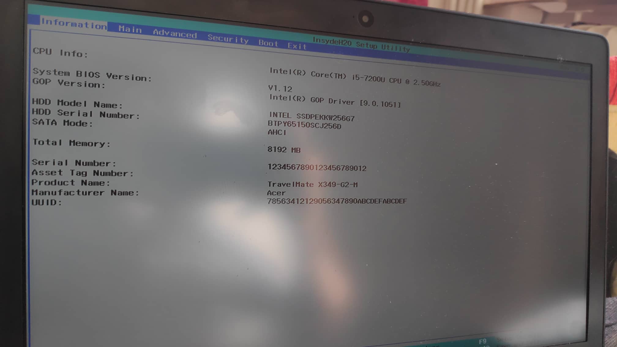

    It's possible somehow with bios bin to change serial number? bought laptop for cheap, but have custom serial(1234567890123456789012) and it is bothering me...

    Yes but need bios dump file

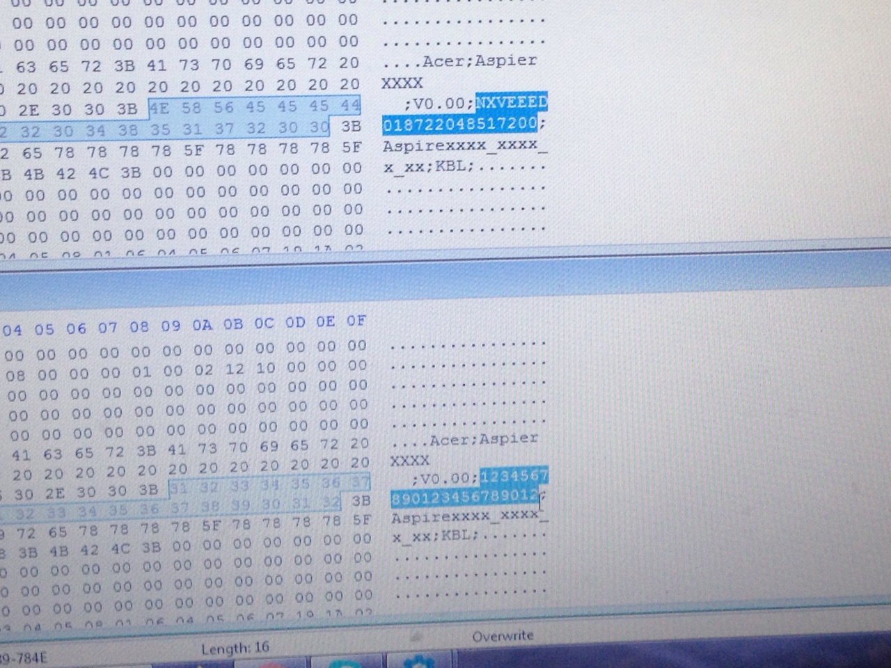

      Re: Acer X349 Serial number change
      Could you make it ?
      SN: NXVEEED018722048517200
      SNID: 72201851372
        Try this file
          After flashing with CH341a, dosent post..
          • imranromi
            • Jan 2015
            • 1288
            • Pakistan
            You try old bios again show display?
              Yes, flash back the original, works again..
                I dont know why not work but change success.Hmm maybe i/o is programmable this board.
                  could i push this serial number with bios update executable ? and what program do you use and which line ? I will play with it myself... Thanks!
                      It won`t work that way altering DXE.
                        • 21282
                        Originally posted by ala_borbe
                        It might not work as its a pegatron board .The bios update has a DMI area in it,another dump is needed to compare.
