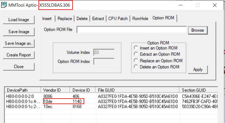

    Hi, I post in this section because I think I not request a bios dump, if I'm in error ....
    In the original bios, there isn't a vbios option rom, in a dump that it work well there is a wrong vbios option rom.
    At the moment I not be able to use uefi tool so I try with MMtool Aptio to replace the 10DE 1140 (nvidia 820m) with 10DE 1299 (nvidi 920m) .
    The option rom is replaced but with strange result, other option rom in the list have the Vendor ID and Device id as not detected.
    Obviously there is a secure problem with UEFI infact MMtool classific when I save it as unsecure. I don't know if original bios works after insert vbios.
    I attach , if someone can hel me
    X555LD_BAD_VBIOS.bin -> 10DE 1140 instead 10DE 1299
    X555LD_ORIGINAL_NO_VBIOS -> not VBIOS

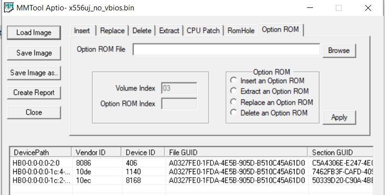

            i7 5-xxxx I tryed with bios in old post but it not work. original bios is in my first message but there isn't vbios. All files I download from asus related to this model (I try with F555LD, F555LDB, X555LD, seems to be 10DE 1140 but for example if I download another model as x556uj that has 920m , mmtool return correct pci idd.

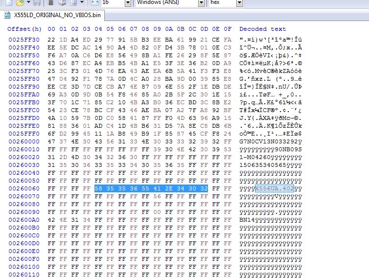

              You have wrong bios,see post 3.The X556UA has a 940M ,maybe 1299 is vendor id .

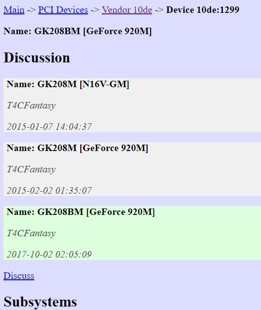

                  https://devicehunt.com/search/type/p...ny/device/1140

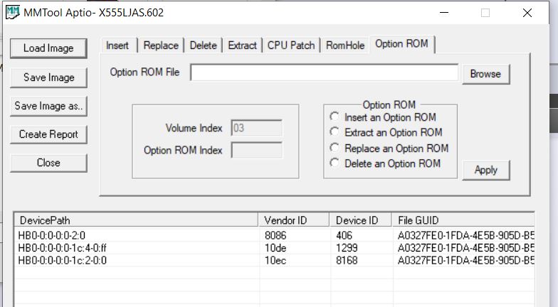

                    Finally solve but or I made a mistake or asus it's a nightmare.....
                    On the notebook rear label I read F555LJ on motherboar X555LD rev. 3.3 on
                    label near the keyboard I read F555L .
                    I download the bios on asus for the F555LJ and finally appears the correct PCI ID . Remain only for my knoledge how it's possible to change and validate option rom ?
