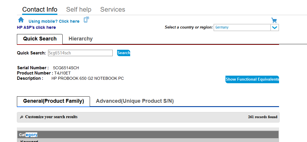

              Re: HP Probook 650 G2 won't turn on after bios chip replacement
              What do I have to enter for Feature Byte and Build ID? I have entered all other values, only with the two I am not sure what needs to be put in here. Or can I enter any values here?
              For the file the notebook starts up and is in programming mode.
                • 21841
                You can find the build ID and featurebyte here: http://pro-psurf-web-glb.austin.hp.com/search.aspx
                Enter your serial number and country.
                Your featurebyte should also be on a sticker somewhere
                3Q3X47676J6Z6b7H7M7Q7W7s9AaBaEapaqawbhdQdUeh.Tm
                • BADJACK80
                  • Mar 2020
                  • 21
                  • Erde
                  I find only this Info on Partsurfer
                    • 21841
                    #29
                    Click on Advanced(Unique Product S/N)

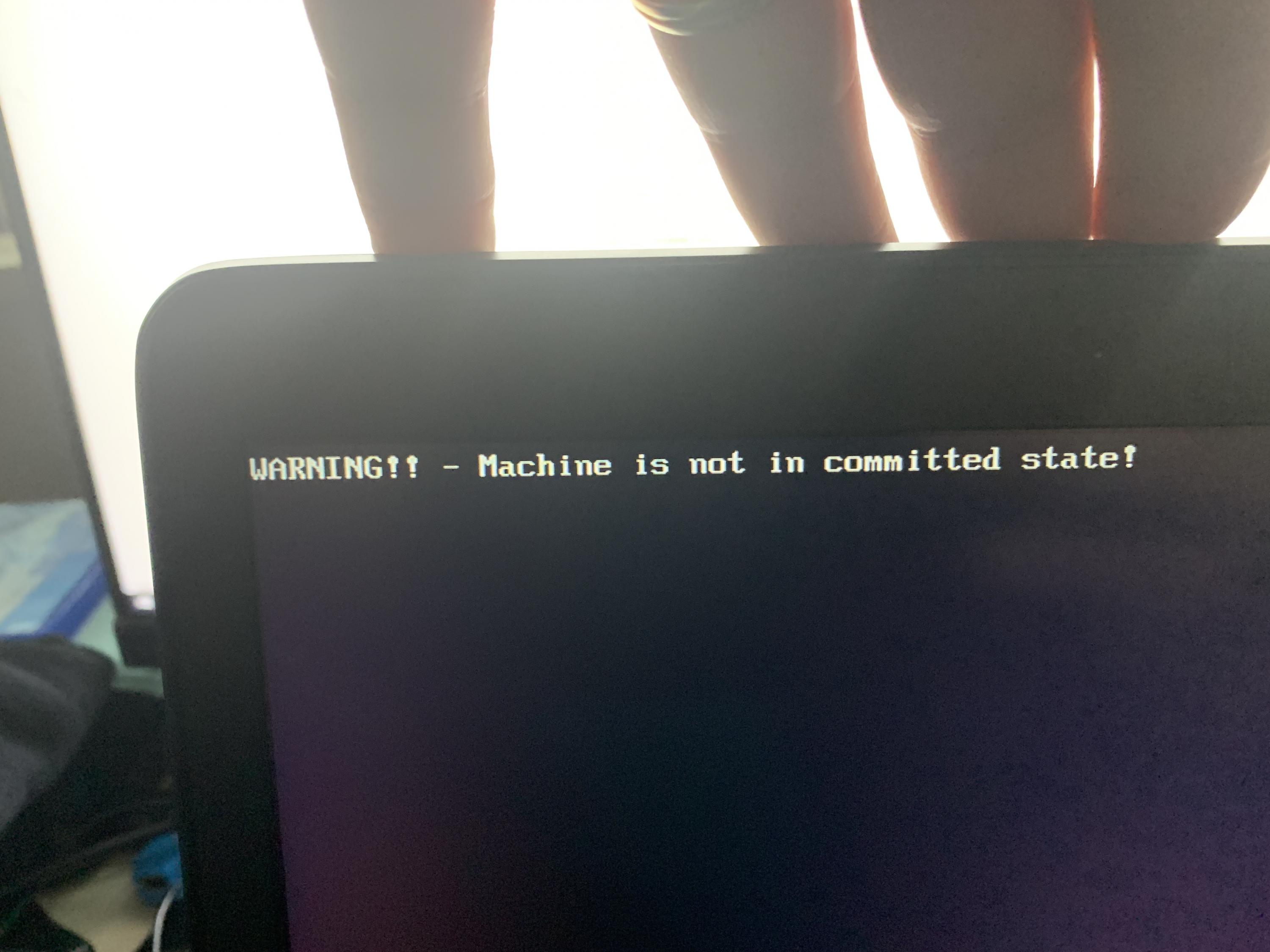

                      #30
                      Thanks for the information. I have entered all the data. Now this message comes
                        • 21841
                        #31
                        See post #155: https://www.badcaps.net/forum/showth...t=52848&page=8
                        You can try that,or clean the ME firmware to make that error go away.Which bios did you use,its always a good idea to use one that has clean ME firmware.
