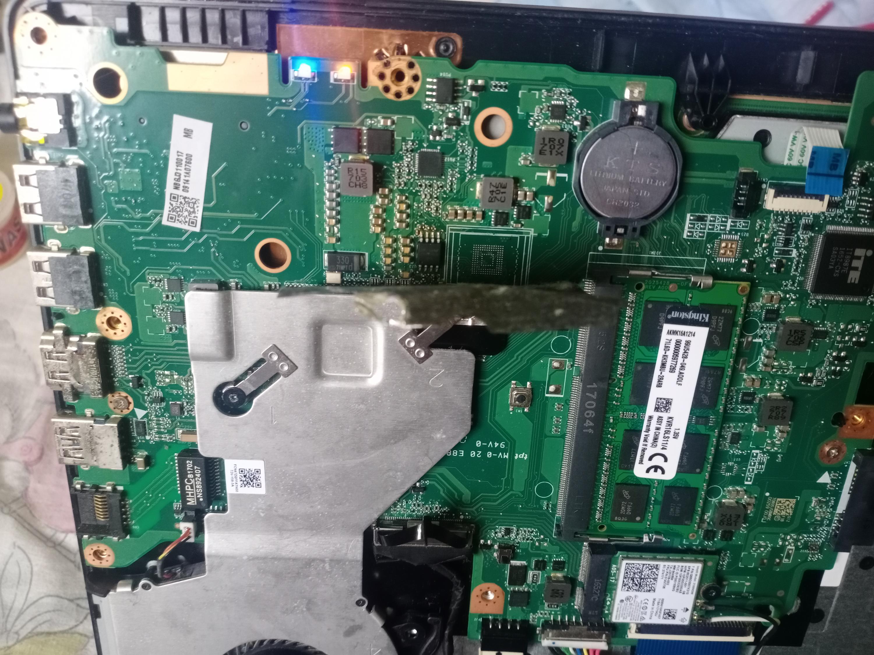

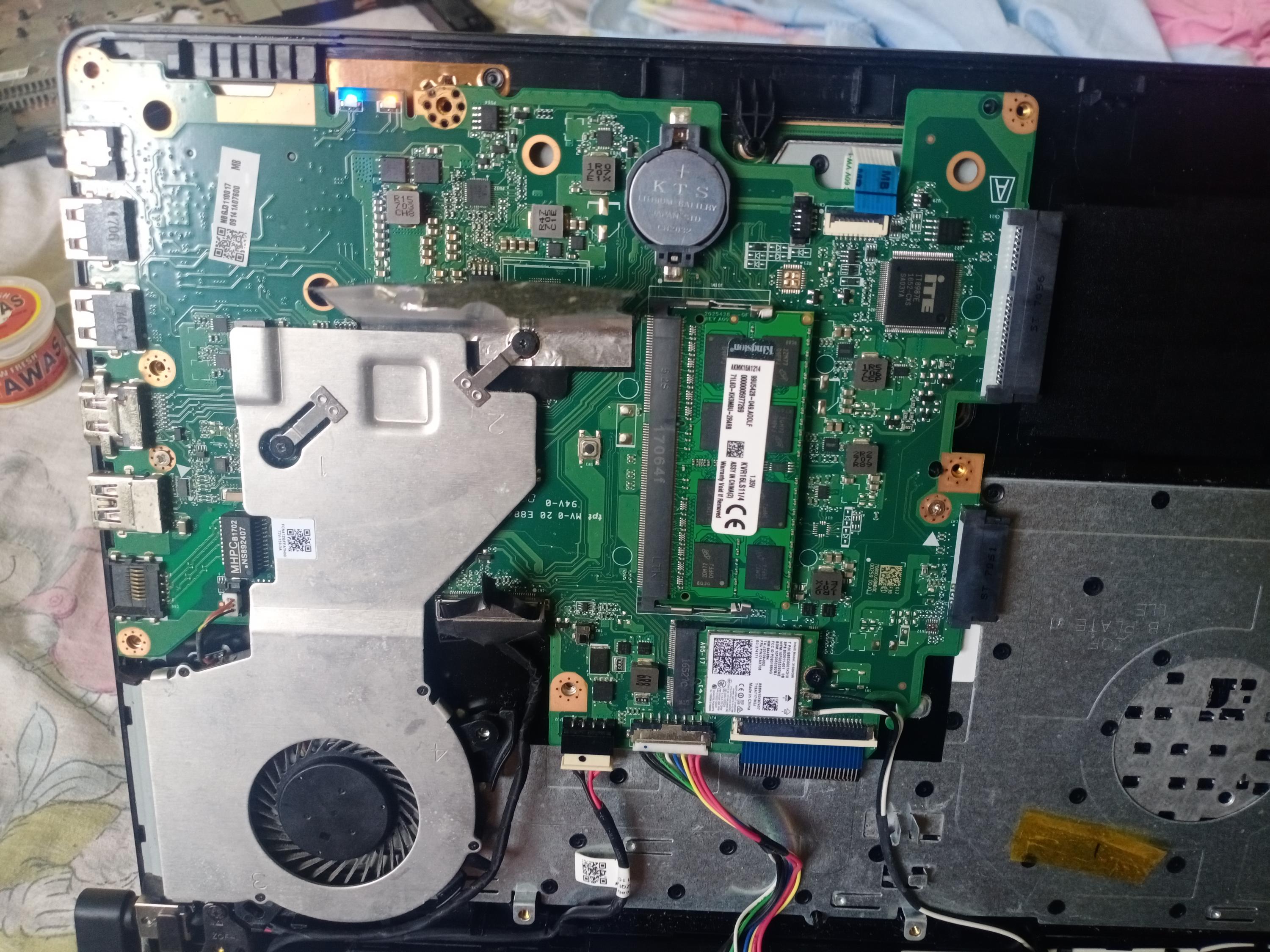

    hi i really need a bios for this machine because it just boot on acer logo after then it turns black
    here is my back-up

          why this laptop still in white screen

            change the mosfet 6414a

                  I already resolve the issue sir it was a 6414 ic voltage regulator near cpu
                      Is it possible?? Even it is not shorted... 6414a..
