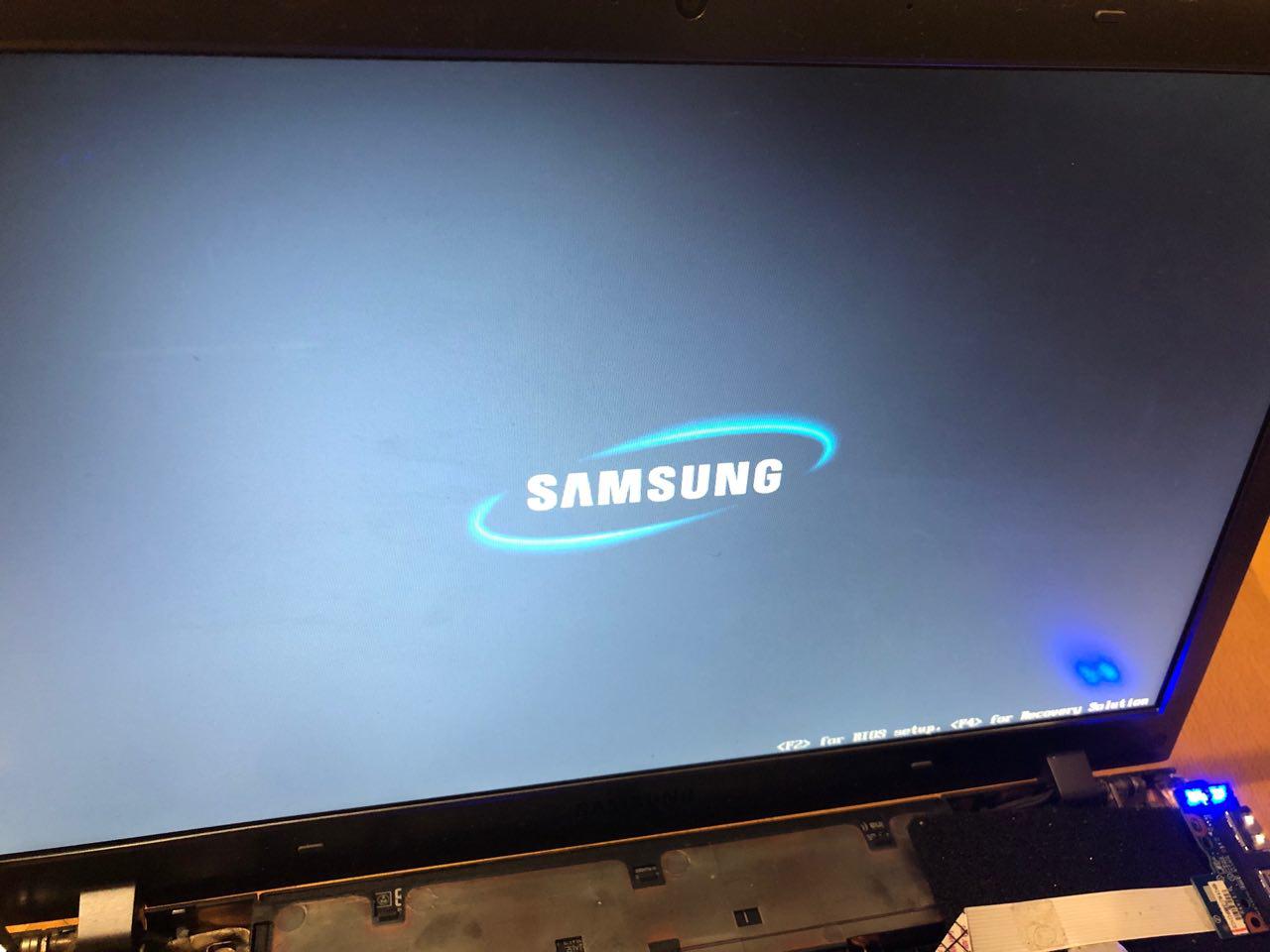

    i replaced again UCL1 and now laptob working but until start page
    i can see samsung logo and not more. similar freeze in first page.
    i changed CPU and Ram ,but Ineffective
    any person have experiment about freeze in bios ?

    Re: &lt;&lt;Freeze Bios&gt;&gt;
    bios problem
    make backup and go to bios subforum and flash bios
      Originally posted by ala_borbe
      bios problem
      i Tried another bios but ist same
      Attached original Bios

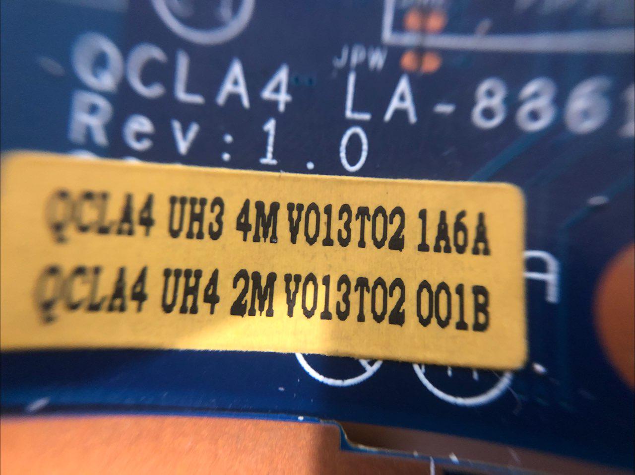

        i found this label
          try...
            Originally posted by peste
            try...
            very thx for reply
            This morning i found this file and programmed in bios chip
            it working perfect
            thx
