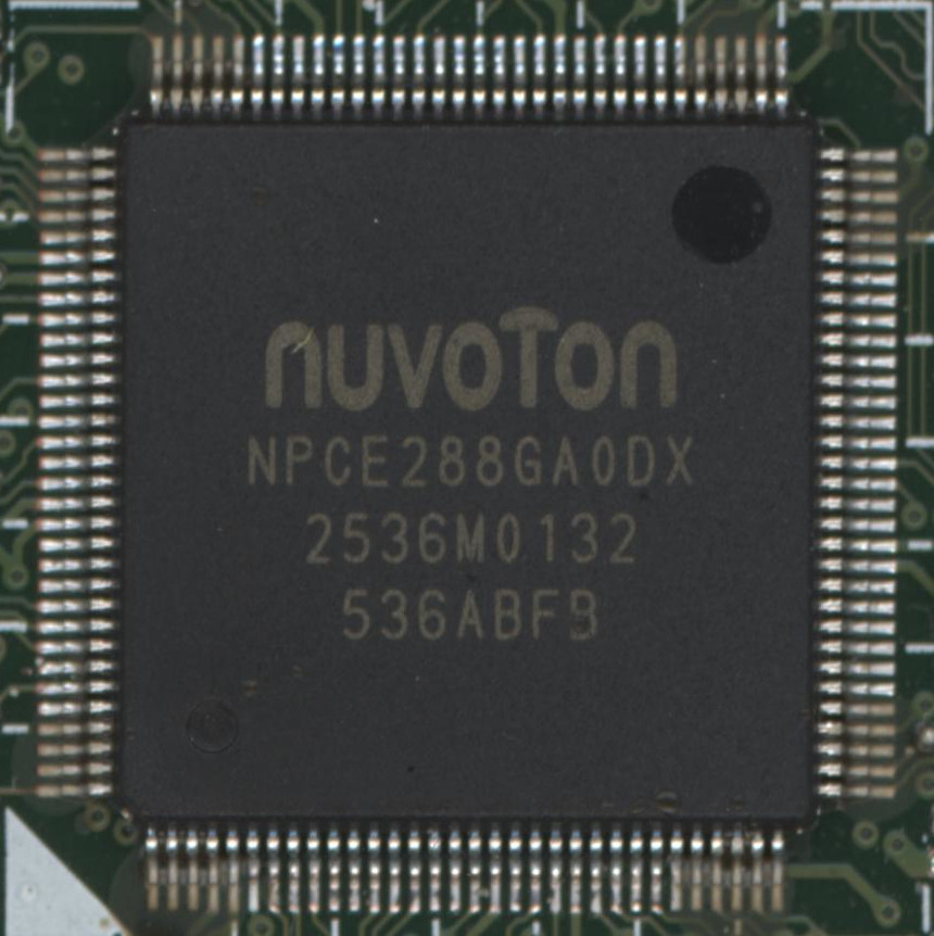

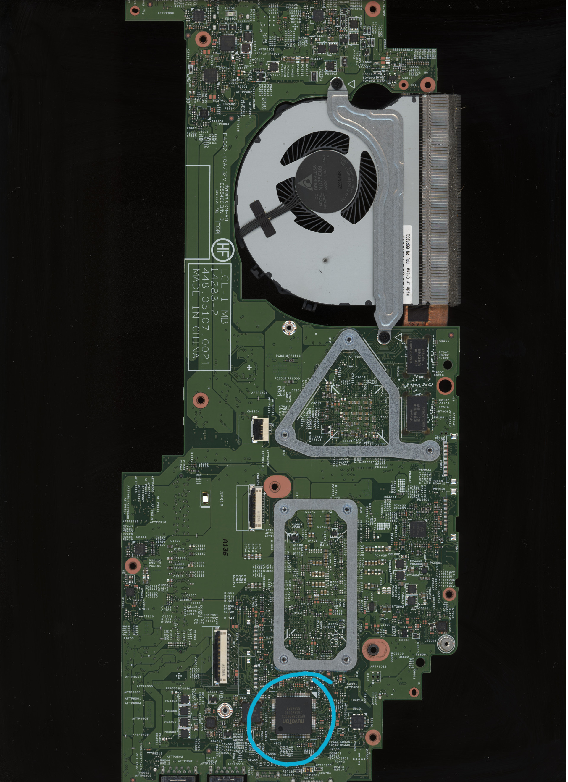

              • genbox
                • Jul 2019
                • 3
                • US
                Re: Can anybody help me with a dump for Lenovo Yoga 460
                Originally posted by imranromi
                I think have ITE... which i/o this model program i/o remove password
                Thank you for your response
                Just to verify I attached an image of the chip, novoton npce288ga0dx, I think is responsible for IO. I didn't see an ITE chip on the board. I can attach / send higher res images of both sides of the board if you would want to take a peak if I am incorrect.
                • imranromi
                  • Jan 2015
                  • 1290
                  • Pakistan
                  Yes password store i think this chip Npe288... if you have svod or other programmer then you can.If dont have buy patch is better i think.
                  • genbox
                    • Jul 2019
                    • 3
                    • US
                    Thanks for the info. I do not have a svod programmer. I do have another one of these laptops for parts. I'm thinking of swapping the chips.

                      • mcplslg123
                        • Jun 2015
                        • 7262
                        • india
                        @genbox, NPCE288 is programmable. If you replace this io chip it has to be from same motherboard, else will not work as you dont have tools to flash io chip. Just double check it before replacing npce288 chip.

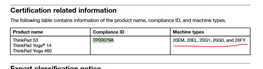

                                • 21690
                                Re: Need Lenovo Yoga 460 Bios dump
                                Originally posted by bilen
                                serıal number deleted.
                                complence ıd : TP00079A
                                machine types picture attached. The first machine type is a 20EM ,do a google search for it,find the support page ,go to Drivers & Software, Manual Update , Bios. Click on the "README for BIOS Update Utility" https://download.lenovo.com/pccbbs/m.../r05uj20ww.txt .The bios ID`s are R05ET**W .Download all the bios posted on this thread,open each one with a hex editor, use the text search R05ET .If one matches youve got a bios to try .
                                  Originally posted by SMDFlea
                                  machine types
                                  there is no text
                                  how can I find ?
                                  motherboard full code LCL-1 MB 14283-3 448.05106.0031
                                  possible type 20EM - 20EL
                                    • 21690
                                    there is no text
                                    how can I find ?
                                    See post #16 ,its been edited.You can find the bios number easily
