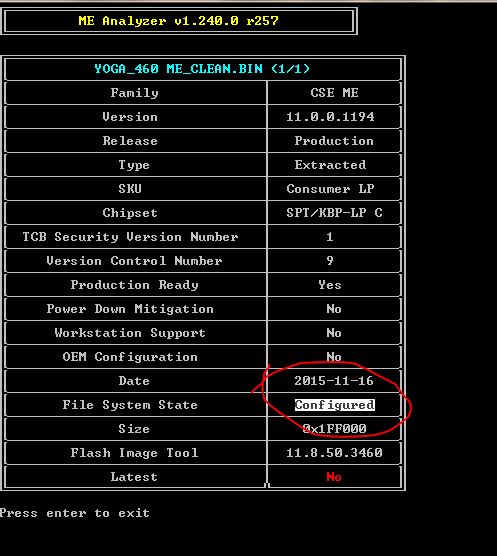

    If the bios at post #3 isn`t a R05ET look for a bios at other sites,you only have to google search with the motherboard part number "LCL-1 MB 14283-3 bios"
    https://www.alisaler.com/yoga-460-la...ad-14283-bios/
    https://forum.laboneinside.com/viewtopic.php?t=7818
    Check each with a hex editor for R05ET ,if one or both are ok then open each one with MEAnalyzer to check if the ME firware is clean "Configured" . If it is "initialised" then the ME wants cleaning
    both bios not working.
    alieser and labolinsde bios not start..
    the 3. post bios start and 4 beep. not screen.

      I did say check them with MEAnalyzer ! ,files from both sites are "Initialised" the ME is not clean,they will not boot,or boot slowly. "Configured" is clean ME Firmware.
      Try the bios at post #5 ,it is an R05ET bios.The number i posted previously was the EC .If the bios doesn`t work the problem is somewhere else.

        thank you. 5. post working
