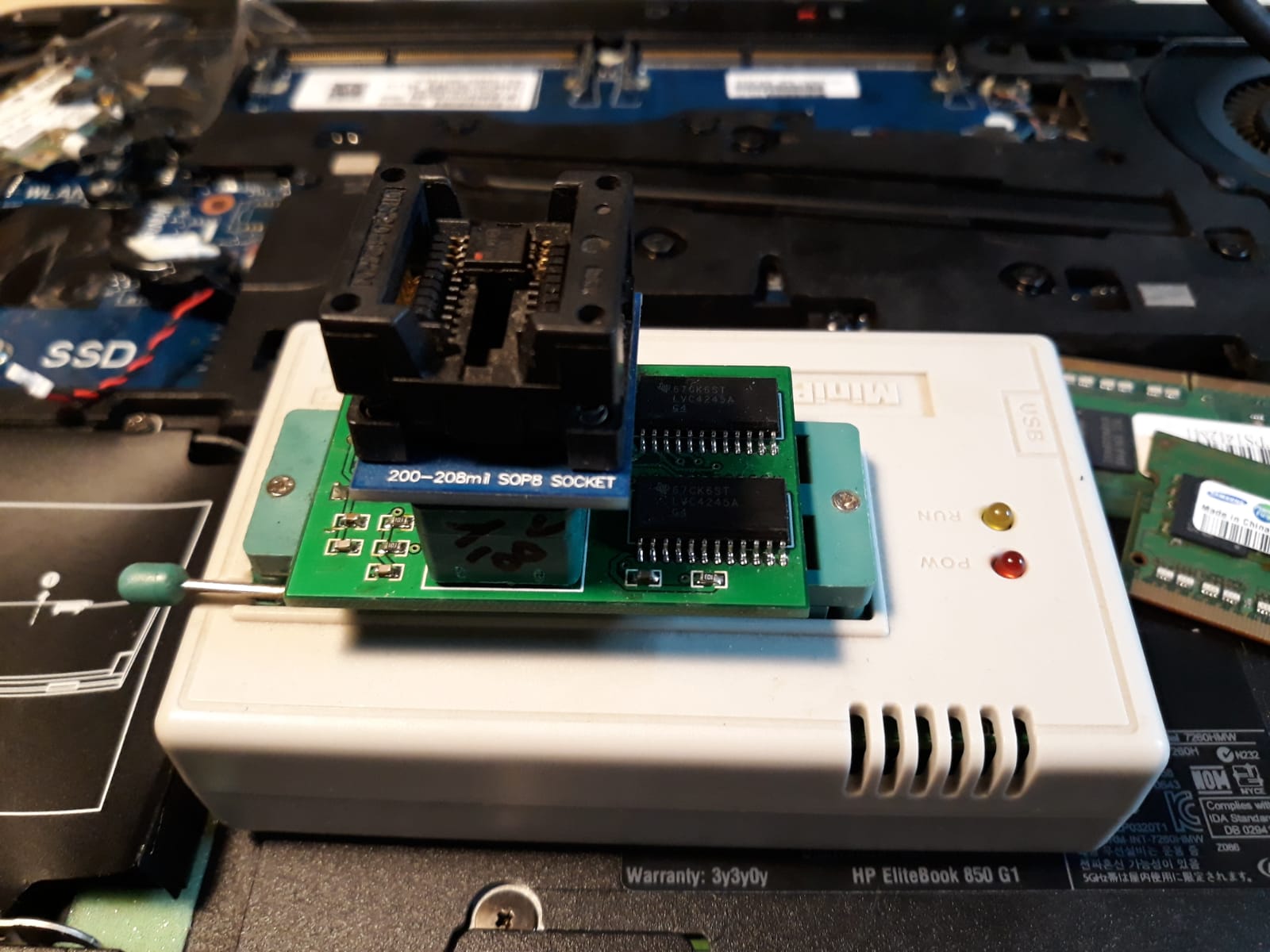

        Re: Bios need HP elitebook 850 G1
        I have difficulty with my tl866 read the source of the two chips, I have to remove (chek-id) on the program minipro to be able to read them and I think the empty content. Both the bios and the ec chips.
        the laptop does not show signs of life no LED but there is voltage at the ends of the battery.
        attached the two sources
          There was a little bit of code in U366Old ,check your tl866 firmware and reseat in zif socket . Are you using a clip ? ,if so desolder them.
            Yes they are desolder, I did the upgrade but did not improve, I will buy the new version tl866 2 plus
              ok finally the new TL866 2 plus arrived and read the source without problems.
              I attach the source. If anyone has the original thank you
                • 21517
                Try these. The first bios old1_ME CLEAN is your bios with clean ME.The 2nd has the latest update merged,but you will lose DMI info,you may have to use nbdmifit/BCU to add the DMI info.

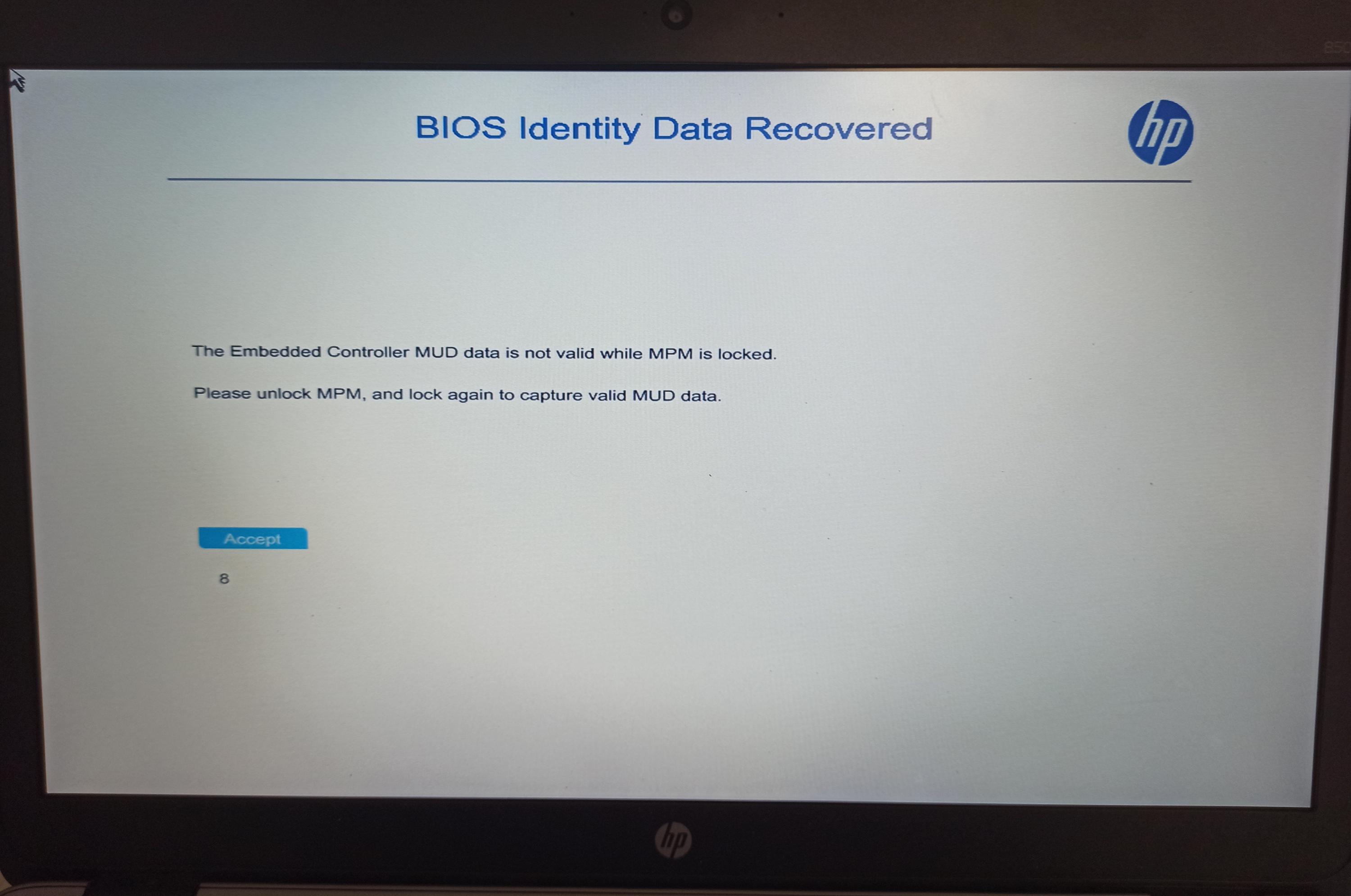

                                      • perzyk23
                                        • Mar 2017
                                        • 31
                                        • Poland
                                        Hello!
                                        I have problem with Hp 850 G1 - The laptop is my wife's.
                                        When she starts the computer, the following message is displayed as in the photo.
                                        I am also attaching the bios files downloaded from this laptop.
                                        Configuration:
                                        I7-4600u / 16 MB RAM/ 256 SSD/ Intel HD + AMD RADEON HD8500M/ FHD
                                        BIOS ver: 01.49
                                        Does anyone know how to fix this? Please help.
