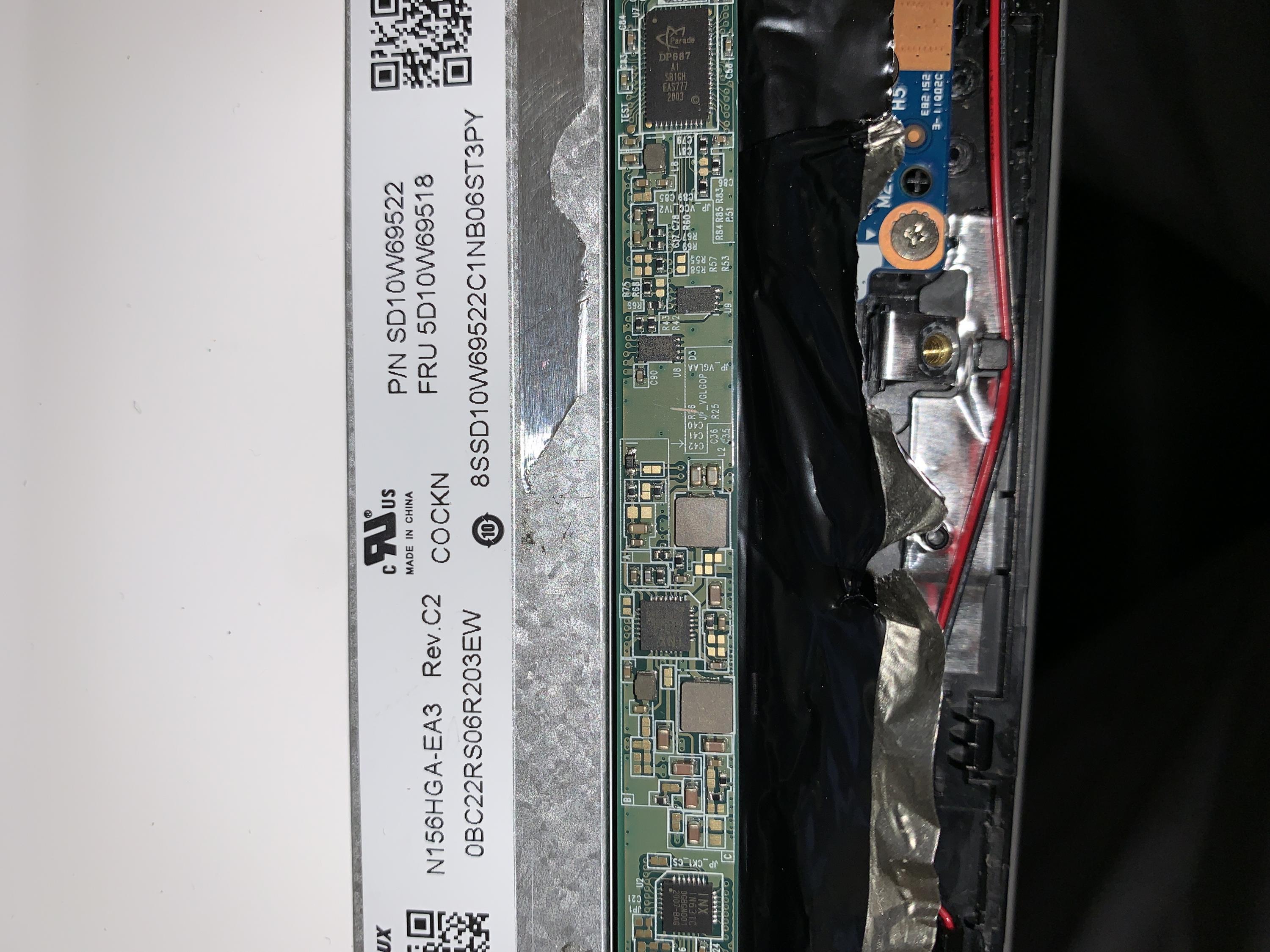

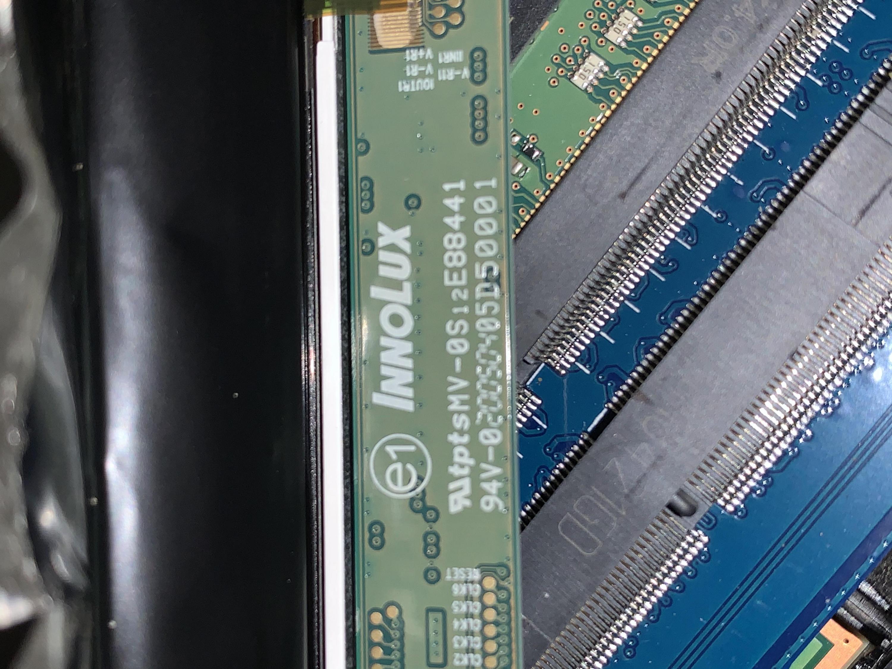

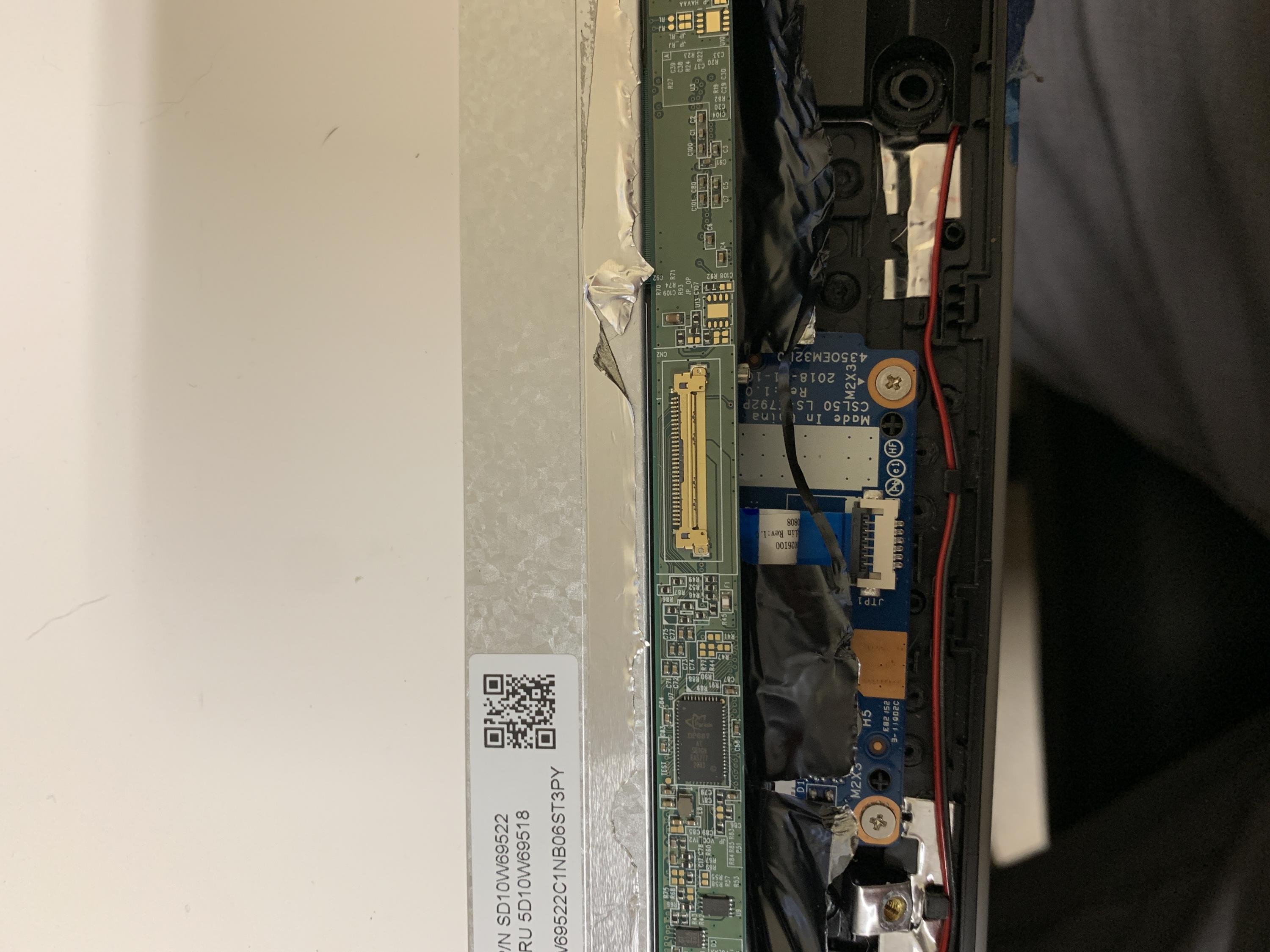

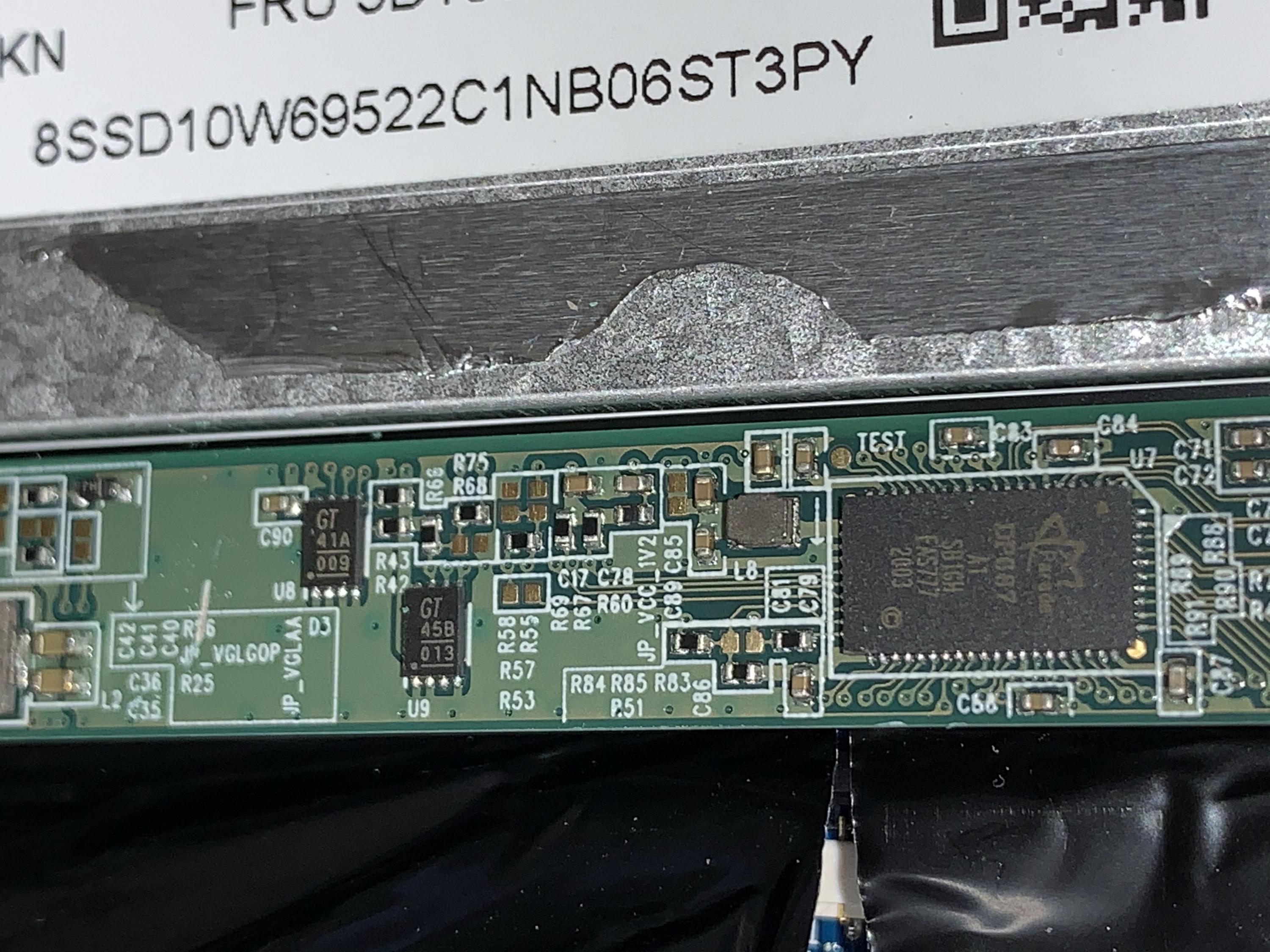

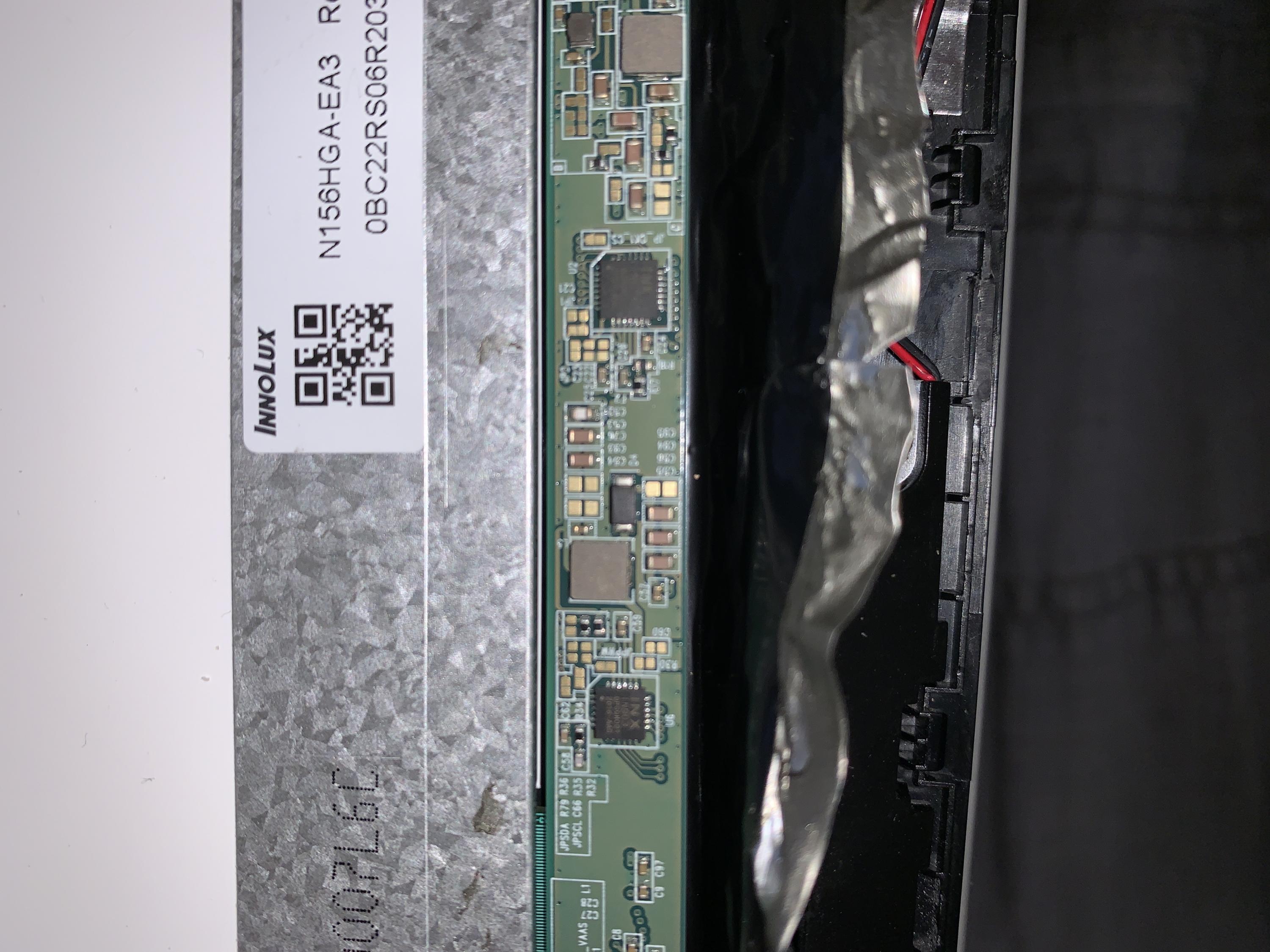

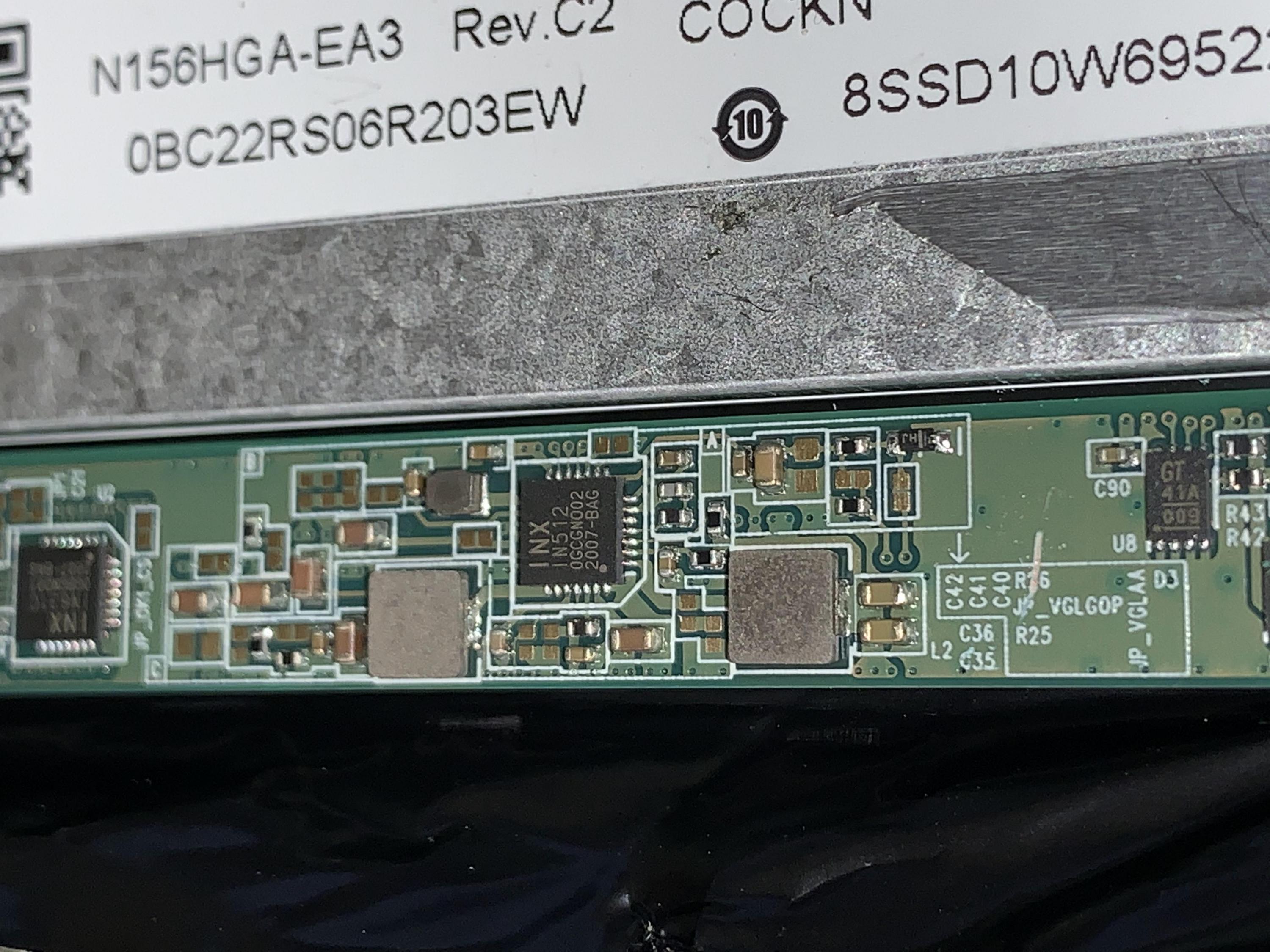

                  @SMDFlea I have N156HGA-EA3 Rev:C2 panels in a bracketed versions and a bracketless version if you can advise where I need to solder to on the PCB for programming with an RT809H unless I can solder to some of the eDP 30pin connector pins for programming?
                  Also is there a specification sheet for this model anywhere?

                    Identifying the WP pin would be helpful if you happen to know what other names it would be on the PCB.
                      You can`t read the EDID through the 30pin connector with a programmer (afaik), its not the same as LVDS.You can read the EDID using linux,or with windows software. If you can ID the chip then desolder it and use an adapter,just put plenty of capton tape and foil around it,and something under the PCB to protect the screen from damage.Sorry,can`t find a datasheet but found a linux hardware probe log file.Copy the edid into a hex editor,save as bin
                      https://linux-hardware.org/index.php...60658&log=edid
