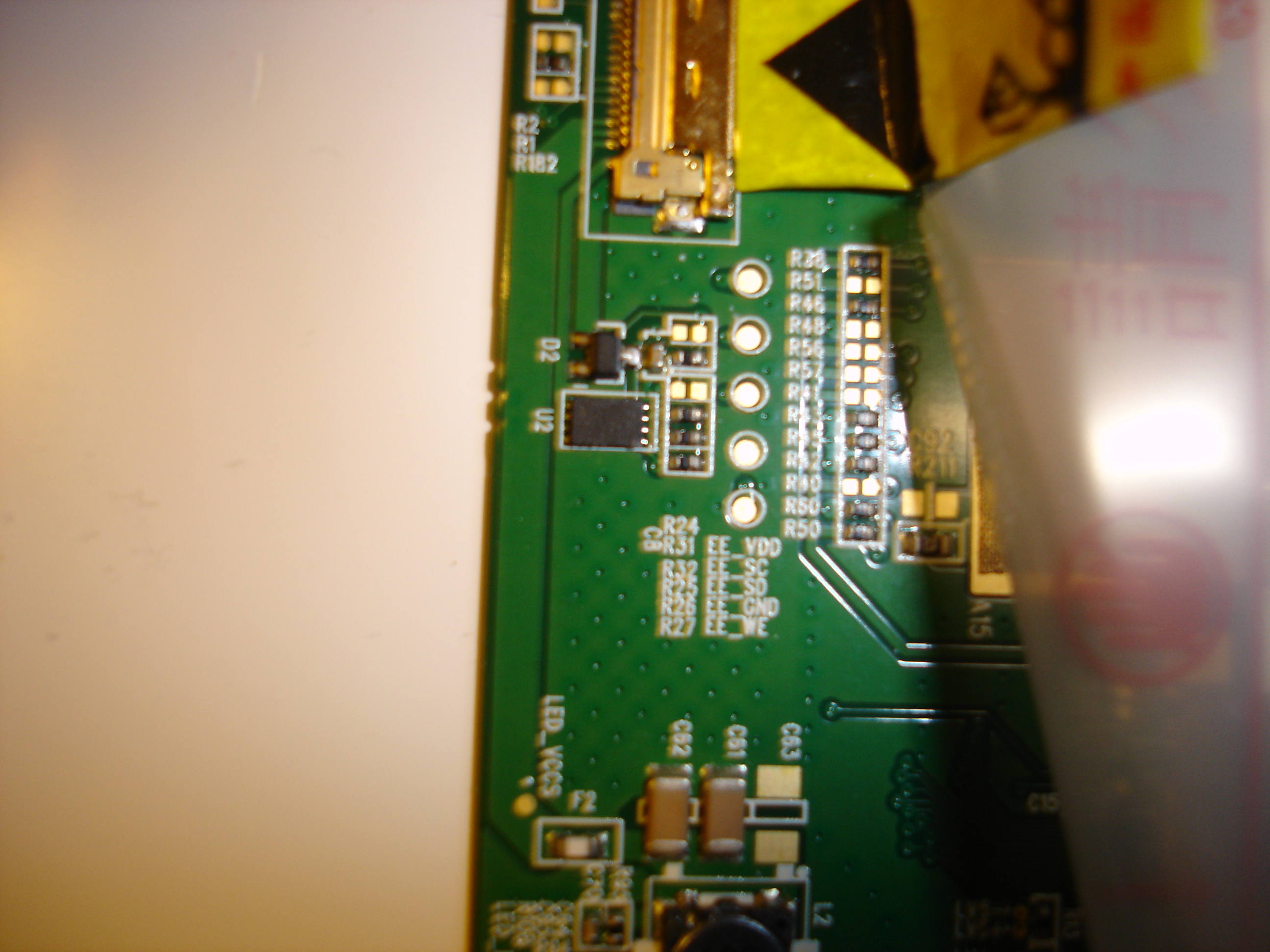

    thanks smdflea already tried different screen still cannot detect.i have a question how to determine the type or manufacture of 24c02 chip on lcd screen?

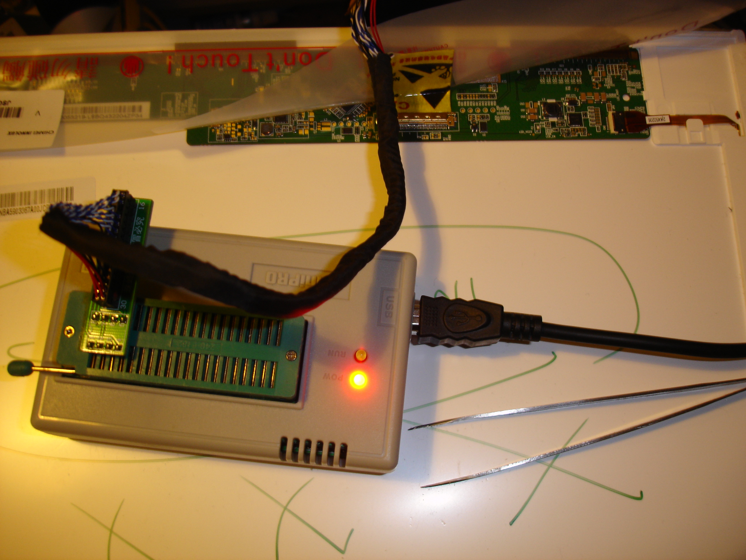

      Ok, so i got a screen and programmed it with my old TL866 by jumping 2 test pads together with tweezers. The screen is a AO N156BGE-L11 .I jumped EE_GND and EE_WE (from pin 7 write enable/write protect) and it worked without having to desolder or solder wires from pi4 to 7.Check if your pcb has a similar silkscreen .

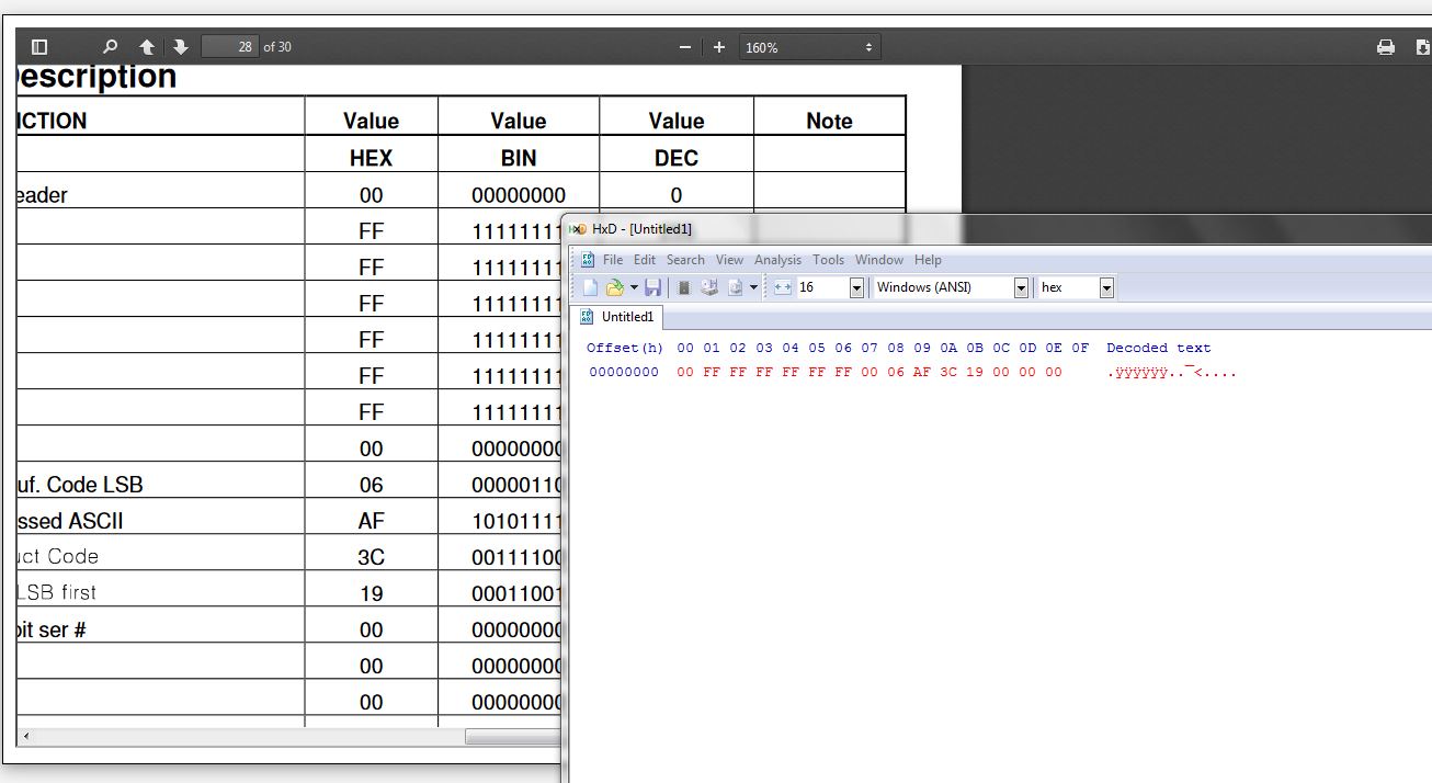

                    thanks smdflea. i keep searching for this endid bin do you have this N156B3-L02 REV C1

                      No, i don`t have it. Heres the datasheet,on page 15 is the EDID layout:

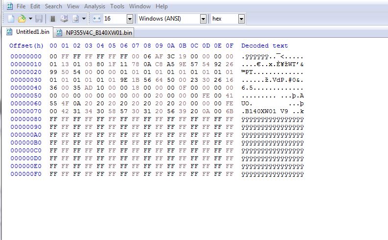

                        @SMDFLEA I need a EDID eeprom file for this AU B140XW01 V.9 please!!I try to flash the corrupted screen

                            Here you go.

                                @smdflea not working because your file has 128kb and the flash size for this is 256kb

                                  You can use a hex editor ?

                                    i dont know how to use it to make a file size larger, can you please make it 256kb file please

                                      Heres a 128kb FF file,copy and paste it onto the end of NP355V4C_B140XW01.bin
                                      https://mh-nexus.de/en/downloads.php?product=HxD20

                                        B140XW01 V9 256kb.bin
