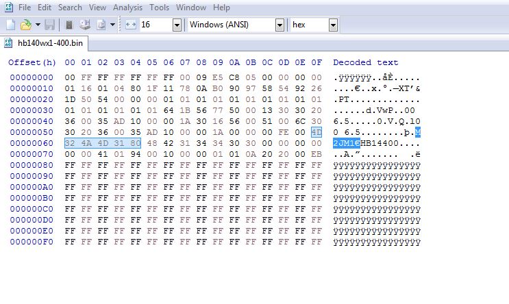

    Originally posted by rediii
    looking for edid .bin for dell latitude e6440 - boe - hb140wx1-400. got this dump is it correct? i found it via edid list (github), but i'm bit insecure
    Did you mean unsure ? . It looks ok to me , google this: hb140wx1-400 M2JM1
      unsure/insecure, whatever . yeah unsure, if the .bin is the correct one. thanks!

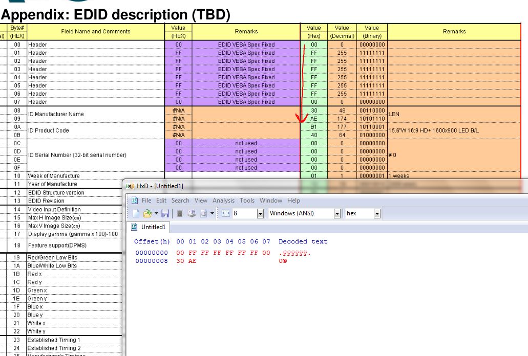

                                    Re: LCD LED EDID EEPRom Dumps
                                    Originally posted by Ghamidi
                                    Please need eeprom B156RW01 v1
                                    Attached is a dump from a lenovo W510 and a B156RW01 datasheet. The lenovo dump might be different to the standard one. You can make a standard dump from the datasheets EDID description on page 33 and 34. With a hex editor just type everything in the 2 green vertical columns into a new file.Copy the 128bytes FF`s from the end of the W510 dump or type all FF`s to make it up to 256bytes.
                                    EDIT:
                                    https://linux-hardware.org/?probe=4b6be936e4&log=edid
                                    https://github.com/linuxhw/EDID/blob...E/4AD0A1347398
