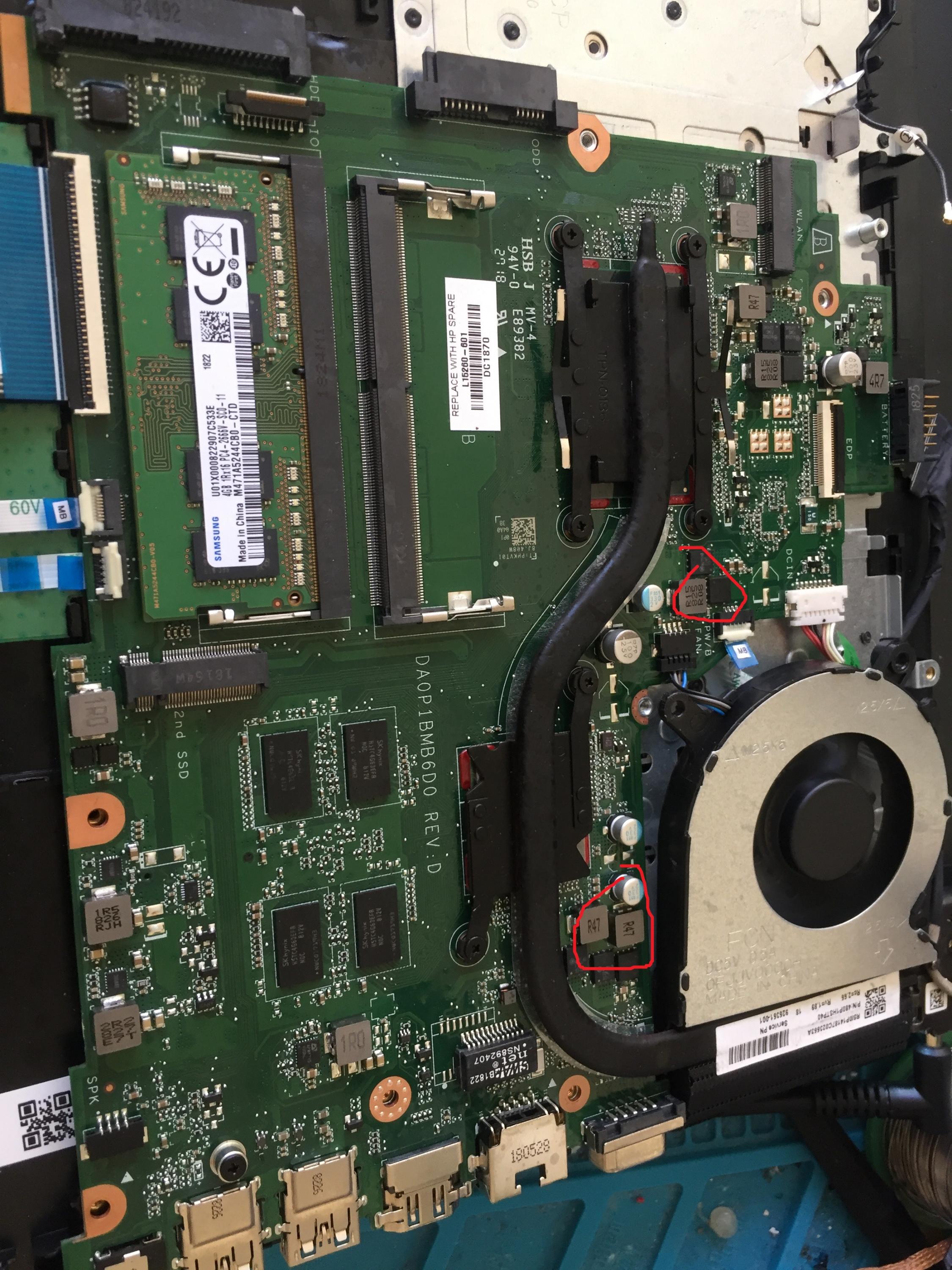

                    • Romy2018
                      • Sep 2018
                      • 174
                      • japan
                      Re: HP 14-BS507TX bios needed
                      i have attached the image of the board the r47 coil near the fan has no voltage and the other one coil the rest have voltages also vcore is present 1.05v
                      • on/off
                        • Oct 2016
                        • 333
                        • Indonesia
                        Check this: https://www.badcaps.net/forum/showpo...41&postcount=1
                          still cannot figure out this problem anyone can help on this please
                            • 22279
                            HP error codes https://support.hp.com/us-en/document/c01732674
                            Try another bios chip , and flash the EC .
