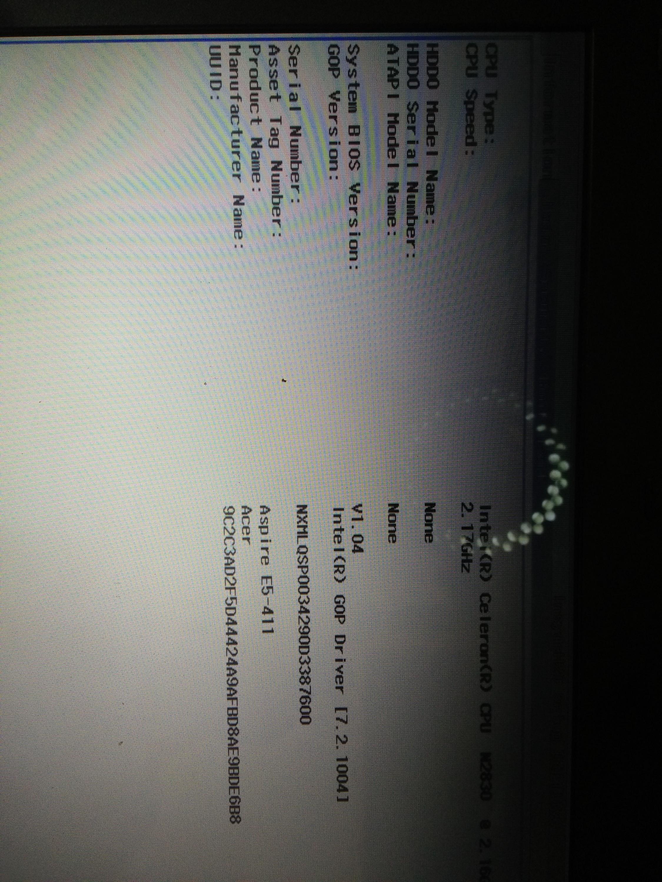

              Helloe bro can you help transfer the dmi of this from dump to my working bios many many thank Brother
              s/n NXMLQSP0034290D3387600

                Re: Clearme Bios Acer E5-411G
                try this..
                  Originally posted by peste
                  try this..
                  Smooth like butter , Thank you so much Bro.
