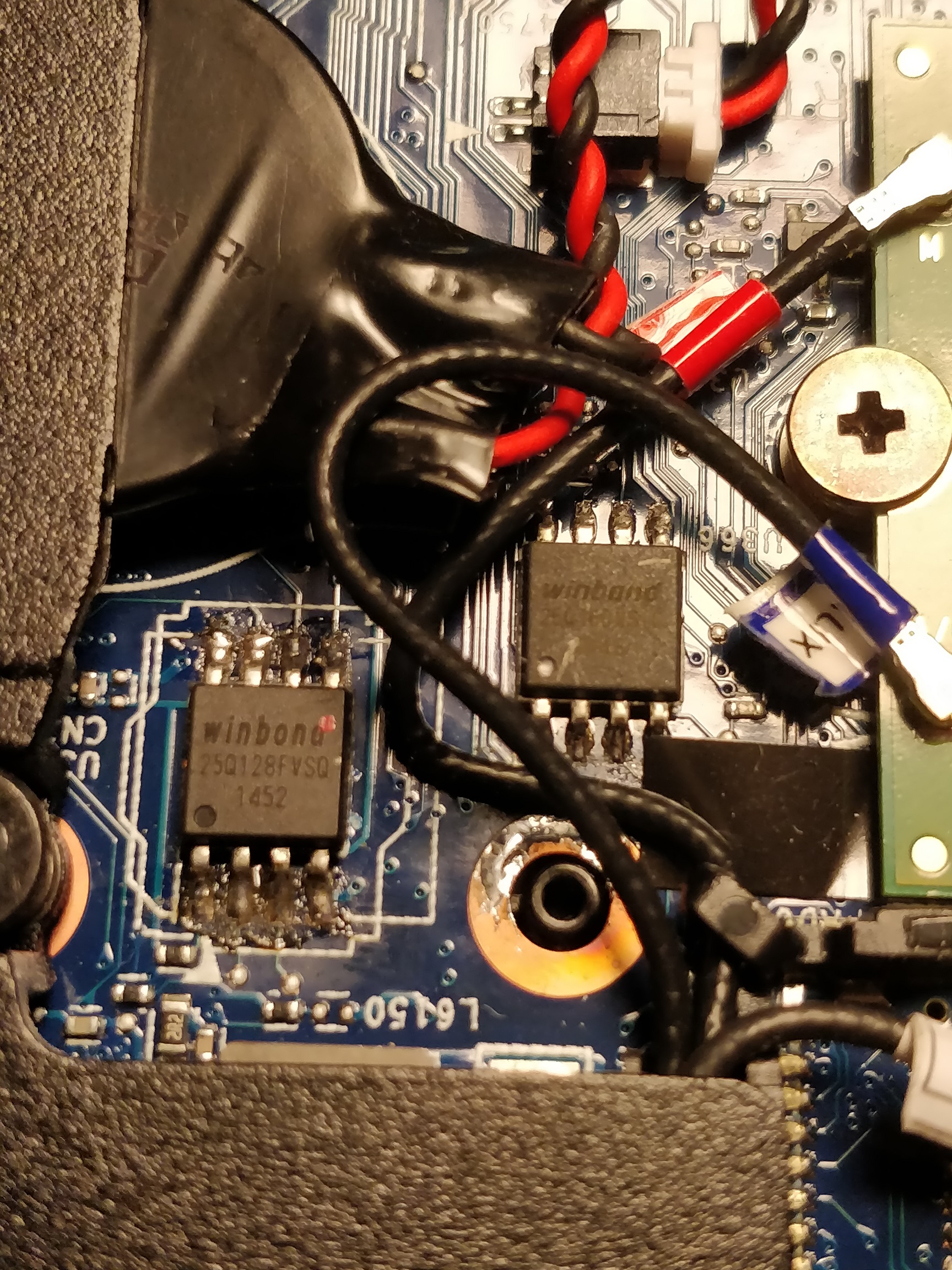

    What is programmer?? Hardware or software??????
    If you mean I have to unsold the chip, we can forget it, then the machine is destroyed.
    THX

      Re: HP 850 G2 is not in committed state
      You don`t need to desolder the bios, you can use a 8 pin clip with a bios programmer .
        I've ordered such a tool. Now I'm waiting.
        But I have further questions:
        Is there a preferred software to extract the bios?
        From which of the both I take the bios.
        THX
          Sorry for bumping an old thread but I have an HP 850 G2 with the same error of "not in committed state" as well as missing "system board", "product name", "serial" and "sku."
          I attached my 16mb dump.
