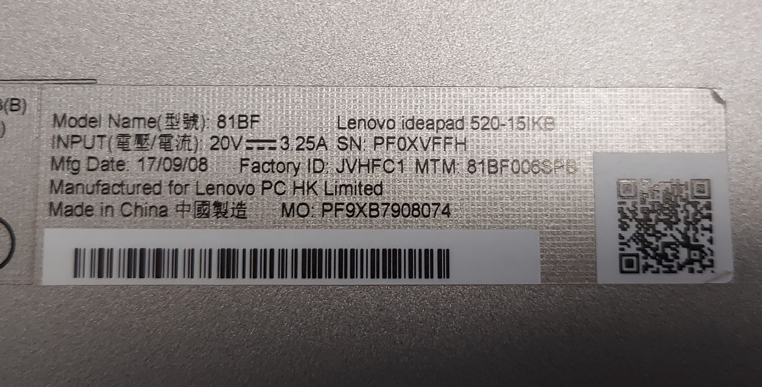

                Re: Lenovo 320-14 320-15 320-17 520-15 B320-14 V320-17 BIOS
                I have a problem, none of them work, this is original
                  • 22108
                  Post the serial number and Model Type thats on the case sticker
                  • ChrisNL
                    • Jun 2022
                    • 3
                    • Polska
                    #29
                    thanks for the quick response
                    • hoaca388
                      Badcaps
                      • Jan 2022
                      • 12419
                      #30
                      520-15IKB (Type 81BF) Laptop (ideapad) - Type 81BF
                      • ChrisNL
                        • Jun 2022
                        • 3
                        • Polska
                        #31
                        unfortunately not working, black screen
                        when turned on, the power indicator and the power indicator below the power button come on. the keyboard lights up, everything goes off.
                        I press the switch and the keyboard lights up, the fan starts, after the chili the fan starts to work at higher speed, the screen is black
                        • hoaca388
                          Badcaps
                          • Jan 2022
                          • 12419
                          #32
                          If after 15 minutes it shows no other improvement then you don't have bios error. Look for other hardware causes.
