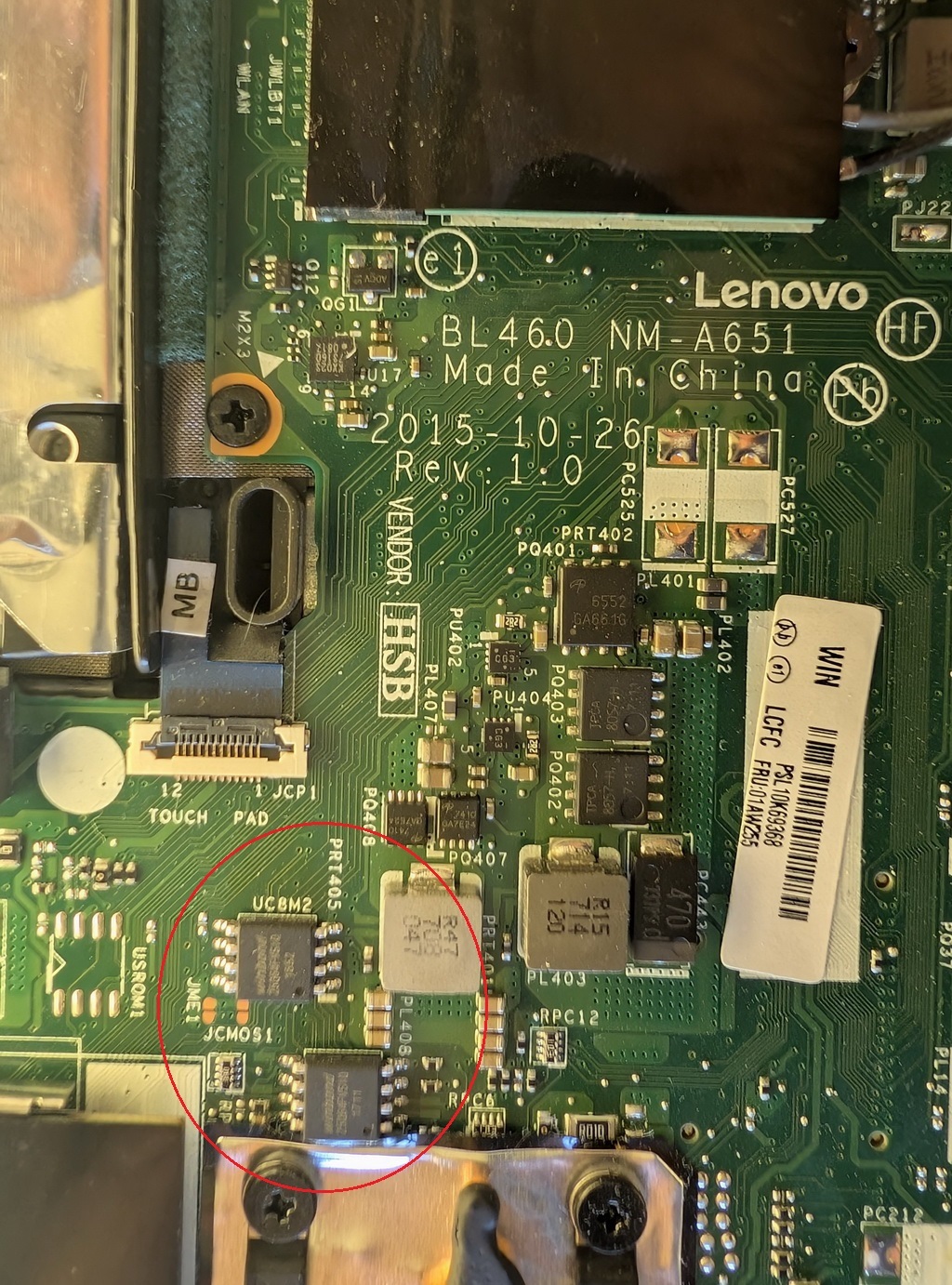

        Hello Everyone, I suffered a BIOS upgrade issue and now my laptop is dead...
        I was able to fins the UC8M2 chip closer the CPU and besides is there is a similar chipset, is this the UC8M1 ? because it is not labeled in the board. Both are Winbond 25Q64FVSIQ
        My intention is to re-write both with different files from this post.
        Thanks in advance !

          #85
          Thanks in advance !
          If that is your intention i would recommend you make some good backups first, just in case something goes wrong

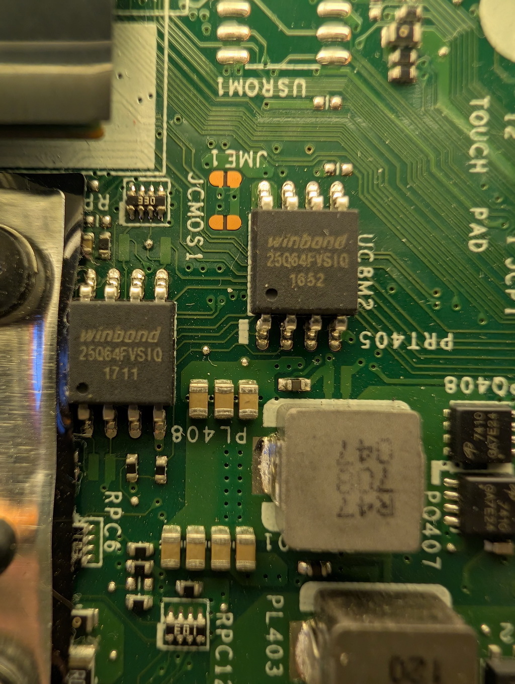

            #86
            If someone could confirm the other is the UC8M1, or where it is located I would really appreciate !! 😉
            I assumed it is due to the chipset model, as I could check in the schematic document. Also I followed the schematic connections for the UC8M1 pins and it looks to be it.

                #88
                SMDFlea could you validate the files ? Today I received the programmer and I´ve read the chipsets
                • federikg
                  • Nov 2024
                  • 6
                  • Spain
                  #89
                  Re: Lenovo Thinkpad L460 Type 20FV NM-A651 BIOS (Main + EC) Needed
                  Try this one, it could solve your Lan problem.
                  I fixed the issue with these files !! after some minutes after the first start, it became to life again !
                  thanks everyone for the sharings
