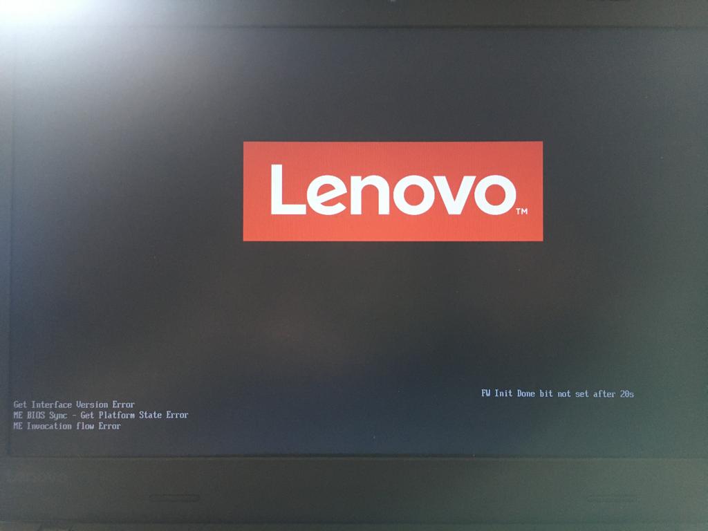

        Re: Lenovo Thinkpad L460 Type 20FV NM-A651 BIOS (Main + EC) Needed
        This is the message I get when turning on the laptop
        Fw init donde but versión error
        Get interface version error
        Me bios sync-get plataform state error
        Me invocation flow error
        I tried clean me but I got error in image flash tools
        I appreciate any help
            hey guys i need help..i updated bios from Lenovo site and after reboot no post. Screen black.....laptop turns on.....after sometime it switches off....here is my dumps
            just two note i have programmed the two chips with bios bin from this thread and elsewhere still no post..i used an isp serial programmer

              • ismaelstepheno
                • Jun 2020
                • 231
                • UE
                hi 4G comm try this bios dump this one solve my problem i wish it can help you
                • 4G comm
                  • Sep 2021
                  • 53
                  • kenya
                  this worked for me guys....thank you all very much

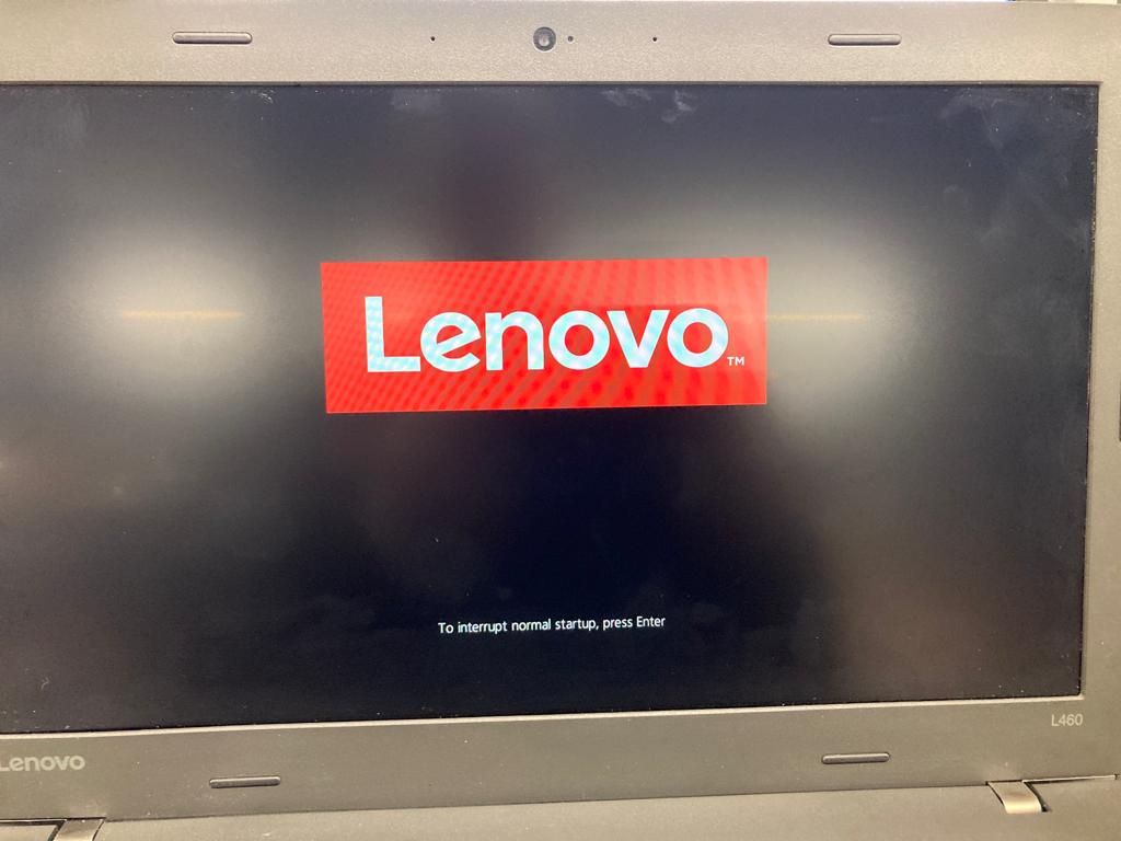

                        • hardware1
                          • Sep 2021
                          • 2948
                          • N/A
                          #32
                          Originally posted by Mr.Nobody
                          Hi everyone,
                          I have black screen and power led is ON.
                          MB Model BL460 NM-A651, I5-6300U (vPro).
                          Here are my dumps if anyone can fix them...
                          I have downloaded a pair of dumps from here and with them the laptop started ok and everything is working BUT LAN...
                          Thanks!
                          Upload the Working Bios, and we will try to make your Lan works fine.
                          all donations are welcome,
                          • Mr.Nobody
                            Retired
                            • Apr 2022
                            • 73
                            #33
                            Hi hardware1!
                            The working files where downloaded from here - ismaelstephenos post #27.
                            Thanks!
                            • hardware1
                              • Sep 2021
                              • 2948
                              • N/A
                              #34
                              Hi hardware1!
                              Thanks!
                              Try this one, it could solve your Lan problem.
                              • Mr.Nobody
                                Retired
                                • Apr 2022
                                • 73
                                #35
                                Hi hardware1!
                                Thanks for your effort and time, but got black screen and after approx. 50 sec. reboots...
                                Update : after 9 or 10 restart loops the power led stays ON and black screen...I'm back where I started...
                                Big thanks anyways!
                                • hardware1
                                  • Sep 2021
                                  • 2948
                                  • N/A
                                  #36
                                  Hi hardware1!
                                  Big thanks anyways!
                                  So if you program back the Bios from post #27 the device will works?
                                  • Mr.Nobody
                                    Retired
                                    • Apr 2022
                                    • 73
                                    #37
                                    Hi hardware1!
                                    Yes it's working fine (except LAN)...
                                    The images are in apparition order and the last one is from Device Manager...Code 10
                                    I don't know if it's important or not ...
                                    MAC on the board sticker is - C8:5B:76:BF:15:ED
                                    MAC from ipconfig - C8:5B:76:52:05:63
                                    Thanks!
                                    • mazoot
                                      iFixit
                                      • Jan 2019
                                      • 41
                                      • Moldova
                                      #38
                                      Hi hardware1!
                                      Thanks!
                                      Try to clean ME Region
                                      Try this bios

                                        • Mr.Nobody
                                          Retired
                                          • Apr 2022
                                          • 73
                                          #40
                                          Try this bios
                                          Hi mazoot!
                                          I have vPro with 2 x 8 Mb bios chips.
                                          Wich one is this ? UC8M1 or UC8M2 ?
                                          Thanks !
