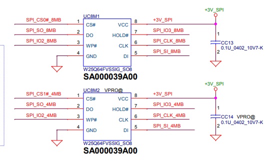

              HI, it's the same content in UC8M2 and UC8M1? can I use the dump for both spi bios.??

                Post both your bios backups. The L460 Type 20FV bios is split across 2 X 8MB bios chips, it has vPro support.The other 8MB bios versions are non vPro.

                    Both bios at post #2 are both non vPro, checked both with MEAnalyzer and they`re both "initialised" which means the ME needs cleaning. If you don`t know how to do that one of the members will sort it. The bios should be flashed to UC8M1 only
                    EDIT: i see you`ve edited your post now. What do you have vPro 2 X 8MB or non (not) vPro 1 X 8MB

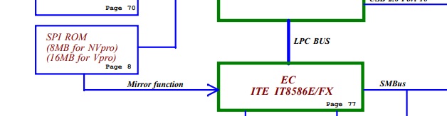

                      referring to the schematics the vpro model is with 2x16 Mega and non vpro like mine is 2x8 mega see attachhed picture,
                      I did clean ME and flash UC8M1 with, board power on for 40 sec and restart in loop (every 40 sec ) I attached my clean ME dump

                        I confirm as you mentioned that for the non vpro is 1X 8 mega spi and for the vpro 2 X 8 mega spi
                        for my case I have two 8 mega spi which means vpro model I am dead bro
                        see page 8 in schematics
