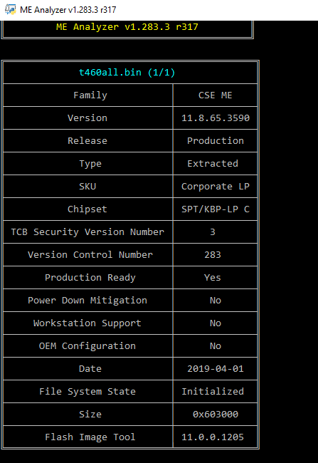

                #47
                Re: Lenovo Thinkpad L460 Type 20FV NM-A651 BIOS (Main + EC) Needed
                i have this ME analyzer status:
                do I need to reset the ME region?
                if so please some help me reset it?!
                this is the original backup of my L460 non vPro with 2 x 8MB uc8m1 and uc8m2
                i merged both files into one to test the ME.
                I already tried other files posted in post#27 and others
                the computers turn on but with no post. and with some other BIOSs it restart for every every 30 seconds or more
                please help
                thanks

                    #49
                    please help
                    thanks
                    OK try this Me Clean file. I think outimage1 is the correct one, the other is empty ..

                      #50
                      thanks, but it did not work.
                      it powers on but no post.
                      thanks
