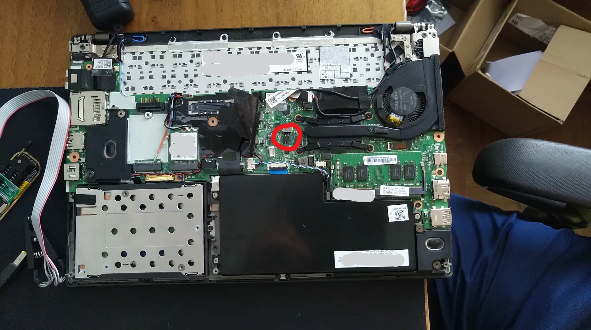

                                      Re: Lenovo x270 bios+ec
                                      Can any gentleman confirm to me that the bios of the x270 is in this pointed location on the atached photo?
                                      Thank you
                                      • Lornet
                                        • Mar 2021
                                        • 27
                                        • France
                                        Hello XIBASE,
                                        That’s the exact location. However, the eeprom being very close to the other components, I advise you to file both sides of the clip to guarantee a correct contact and therefore a correct bios dump...
