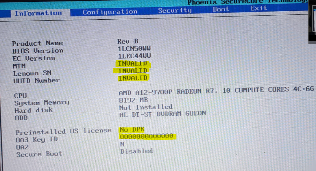

                      • redtrash
                        • Apr 2023
                        • 3
                        • IT
                        I've used it too with CH431A programmer, the laptop I've found in the trash is now alive again. 😉😁
                        Just one info about, the BIOS was edited to delete all the personal info about the original owner, I guess, but are those info needed somehow or I can leave it "invalid"?
                        Also, the bios is not recognizing the external RAM (4gb ram stick) but only the soldered one, but this may be a problem on the ram stick.
                        Thanks!
                          SMDFlea commented
                          Editing a comment
                          If you saved a backup before flashing the bios the DMI should still be in your backup

                        • redtrash
                          • Apr 2023
                          • 3
                          • IT
                          I did it, but looks too corrupted.
                          Anyway, about the RAM, I was mistaken, I've cleaned the contacts and now works.
