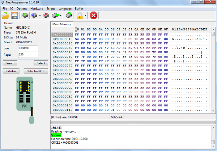

                      Try NeoProgrammer software,it supports the GD25B64 Post #7 https://www.badcaps.net/forum/showth...=NeoProgrammer
                        Hi thanks for help
                        Here is what happend , i flashed bios file which you provided 08217F48 to chip
                        using Ch341a programmer and it identified chip giga device but showed 2 chips in selection
                        1- GD25B64
                        2-GD25B64C
                        i flashed both one by one with this file , first i read file and it did read it successfully showed me bid number 08217.
                        One more thing in IC list of the programmer there is no IC list for gigadevice
                        GD25B64CS1G, list starts with Gd25Q

                            NeoProgrammer has a search function,just type in GD25B .If the virgin bios is written correctly you should have something on the display.Erase the chip first,then write,then read back again and compare with HxD ,if there are any differences the bios chip is bad. If it has written correctly then i can only assume that the EC may be corrupt, as it was working ok before the bios update ?

                              #34
                              Re: HP Omen 15-ax201ns bios dump
                              Hi
                              Neo programmer has support for GD25B64C chip confirmed
                              Now what to do with files? and which one is valid for flashing.

                                      Write the 08217 ,read it back,compare what you read back with the 08217. Both should be exactly the same. If they are the same and still no boot then it is no longer a bios issue and the problem is somewhere else

                                          #40
                                          Hi all
                                          here are the results , something wrong with mobo STILL NO BOOT AND NO DISPLAY. i see backlight when i put torch at LED.
                                          Both files were identical when compared
                                          IC identified and detected correctly
                                          capslock led disappeared for 5 sec then again appeared.
