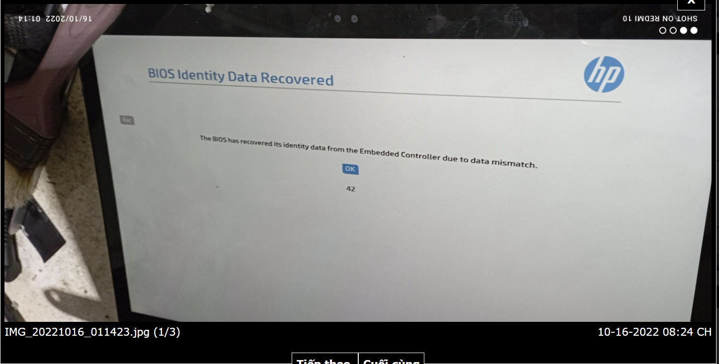

      Hello freinds so after tested many bin file uploded in bios i lokk to this file is worked only in start up after started returne againe to black screen and f10 led blink
      Please help i need this laptop wored again

        Hello friend, for this new lap we can t try bios from another lap, maybe only to confirm if it was a bios issue or not
        Try this file it s official with your dmi
        your win key : B7F720--B7F74F

            nothing just reboot after 20sec and black screen
            • lapfix
              • Mar 2020
              • 2756
              • my workshop
              #166
              Re: bios for HP EliteBook x360 1030 G2
              post the bios that you mention at #165
              post the serial number that you have at the back of your lap

                thank you freind
                serial -----> 5CG7433XYS
                model ----> HSN-104C

                  My doubts are confirmed , not the same serial so someone has mess with the original dumb...try this !

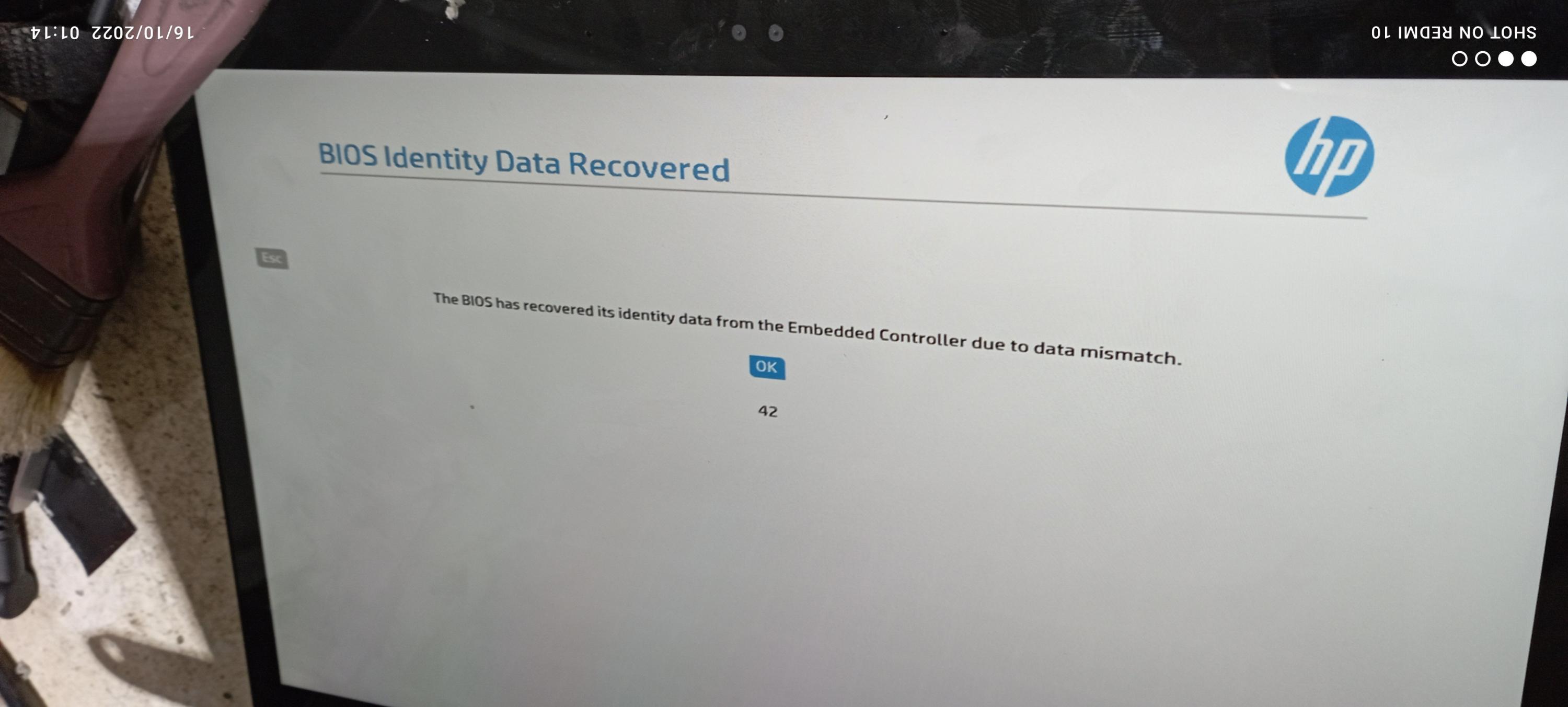

                          i tested to upload this file is show only this screen and after that still rebooting
