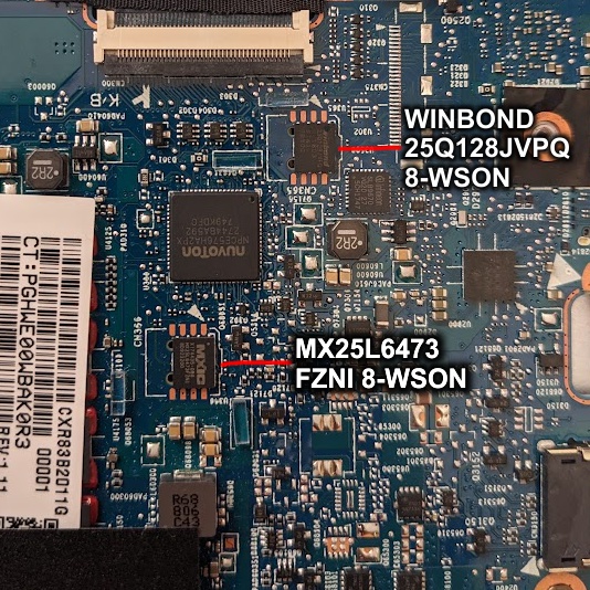

          Re: bios for HP EliteBook x360 1030 G2
          I need to clear the bios password on an HP Elitebook x360 1030 G2 (OLDMAN-6050A2848001-MB-A01)
          Which of the following chips do I need to dump and edit/replace?
          WINBOND
          25Q128JVPQ (8-WSON)
          MXIC
          MX25L6473FZNI (8-WSON)
          Best regards
            WINBOND
            25Q128JVPQ (8-WSON)
            MXIC
            Best regards
            Backup both, using RC Unlocker with the file from the Winbond chip first.
