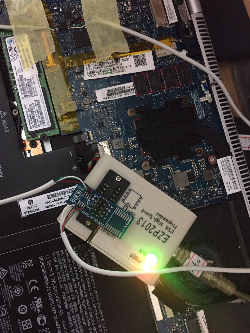

            hp elitebook x360 1030 G2 BIOS!!
            i have already posted in this forum about this pc !
            i need bios with no password for:
            HP EliteBook X360 1030 G2
            motherboard : OLDMAN-6050A2848001-MBA01
            bios chip : MX25L128
            dump readed by EZP2013 programmer.(attached file).
            any one can help !! thanks

              Try this one .

                But black screen with tis file.
                  • 21917
                  Re: hp elitebook x360 1030 G2 BIOS!!
                  Your bios was corrupt, i tried to fix it. Try this bios it should be ok this time, but you will have no DMI info, you have to use nbdmifit .
                  nbdmifit. https://www.badcaps.net/forum/showthread.php?t=69204

                    same thing : black screen and fun speed high than normaly.
                    my pc is clean from virus.
                    here another backup try to verify if corrupt or no!
                    thanks

                        The flash descriptor is missing,same as the other backup you made.The previous bios i posted should have worked ok, but i think you`re not writing the flash descriptor back. If you`re using a sop8 clip that might be the problem,always better to desolder the bios,or the bios chip is faulty .

                          i solder bios directly from mother-board to programmer using wires.
                          and erasing/writing operation was successfull.
                          must i desolder the chip and solder it on adapter ?? in oreder to get more success ?
                            • 21917
                            #33
                            You must disconnect the laptop battery, and also the CMOS bios battery first before reading/writing or removing the bios.

                              other thing what about buffer offset and file offset settings ??
                              value is "0" . Do i change it ?

                                where is located "the CMOS bios battery" don't see it !!!
                                  • 21917
                                  #36
                                  I don`t know where the cmos battery is on the board,i looked at some motherboards on ebay and can`t see a soldered bios so it must have a connector somewhere.Some boards don`t have a cmos battery,they use the main battery. Unplug the main battery,press the power button for 30 seconds or more to discharge.Unplug every connector you can see, check bios volts, if 0 then flash the first bios i posted. Good luck with it , i`ll check your progress tomorrow.

                                        bios unlocked ok thanks to all !
