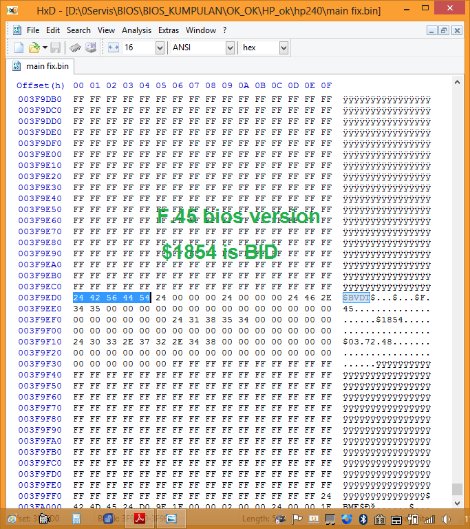

    There are 2 ways to know BID for hp Laptop I think.
    in example:
    - Usually On bottom Case or behind Battery slot
    - In Hex file. Try to search with key"$BVDT" (without qoute, I think if quanta's mobo and insyde bios. Didn't know if from AMI bios)

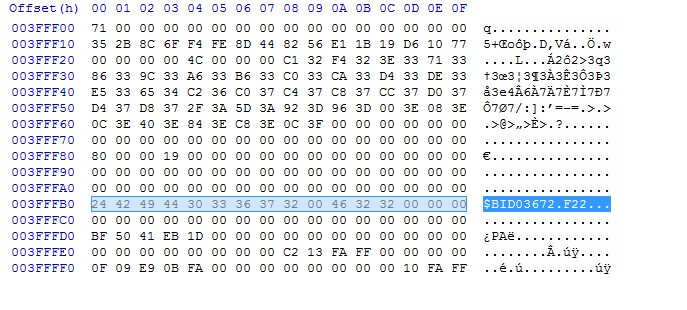

      In Hex file:
