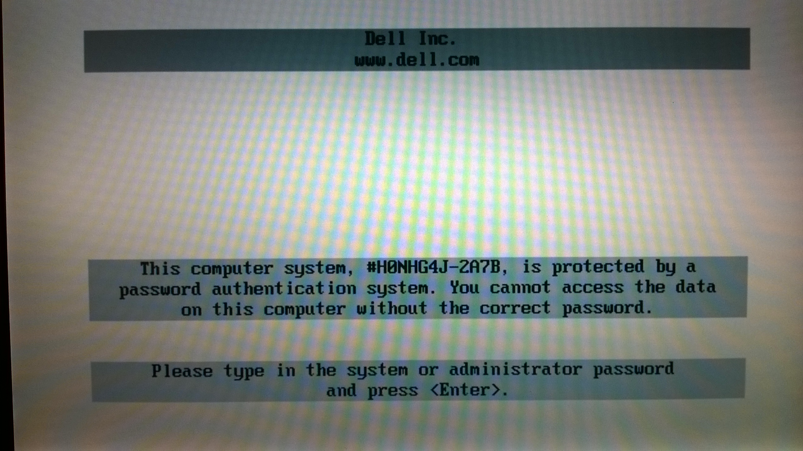

    Hi, is it possible to remove password from this laptop? Bios replacement did not help.

    show bios password pics.

      We got it with out hard drive.
      When typing in nothing is shown on screen, I am not even sure I typed anything in at all.

        TRY THIS LINK IS WORKING.
        https://bios-pw.org/
        ENTER COMPLETE PASSWORD NOT ONLY ENTER CTRL/ENTER BOTH PRESS
        KEYBOARD USE QWERT CAPITAL WORD USE CAPSLOCK NOT SHIFT.
