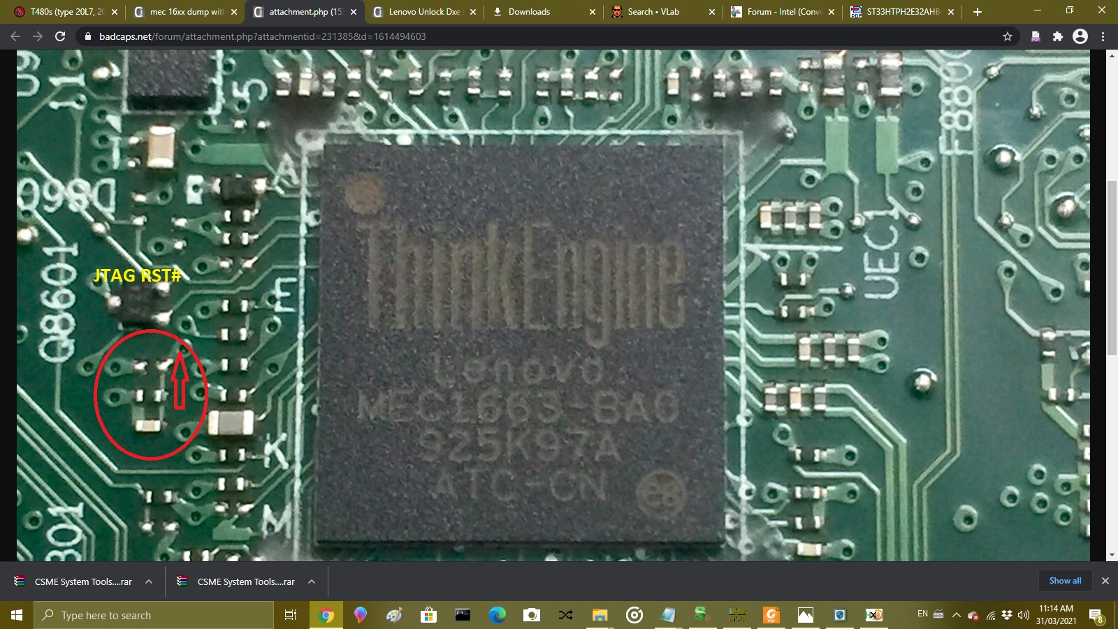

                                      Tried unlocking T14 through JTAG and was successful in reading MEC1663 .. but
                                      serial numbers were nowhere to be found in the dump, but they were in the bios instead. I blanked the MEC and waited in the hope that the Bios will rewrite it but nothing happened. So I wrote a clean dump into the chip and booted the Thinkpad (holding my breath..) and was greeted with a Supervisor password prompt..(WTF??!!) SO I said to myself perhaps the pass is in the Bios , since it's the first time I've seen serial numbers in the Bios.. I wrote back Clean firmware from Lenovo website and still.. password prompt!!.. SO that leaves to believe the password is now stored elsewhere.. perhaps in the TPM chip?(ST33HTPH2E32) since that chip also has flash memory.. For those who want JTAG_RST# location, I've posted it below.. hope we all put our heads together to come up with a solution..
                                      • AAAC
                                        • Jan 2020
                                        • 458
                                        • Mexico
                                        #1299
                                        Re: Remove_SMM... UEFI.
                                        @siddiq
                                        After you have READ, ERASED and PROGRAMMED EC/KBC seems as the Supervisor Password is still set (most likely still in EC/KBC RAM), so try disconnecting all source of energy for 2-3 minutes, reconnect and try again. You will then need to program laptop DMI like serial number, model number, etc. using Lenovo EFI utility.
