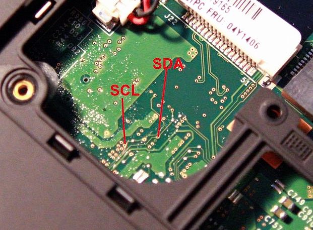

    ThinkPad T430
    Here you have point connection for SCL SDA from security eeprom L08
    I here from the internet that if you keep connected SCL & SDA together. And start the notebook with F1, you can bypass the password and change it.
    I never did this. So you have a risk.

      I know the away but I want try ThinkPad T430 Patch

        The pass will still be there on the L08 chip,no point patching the bios.
