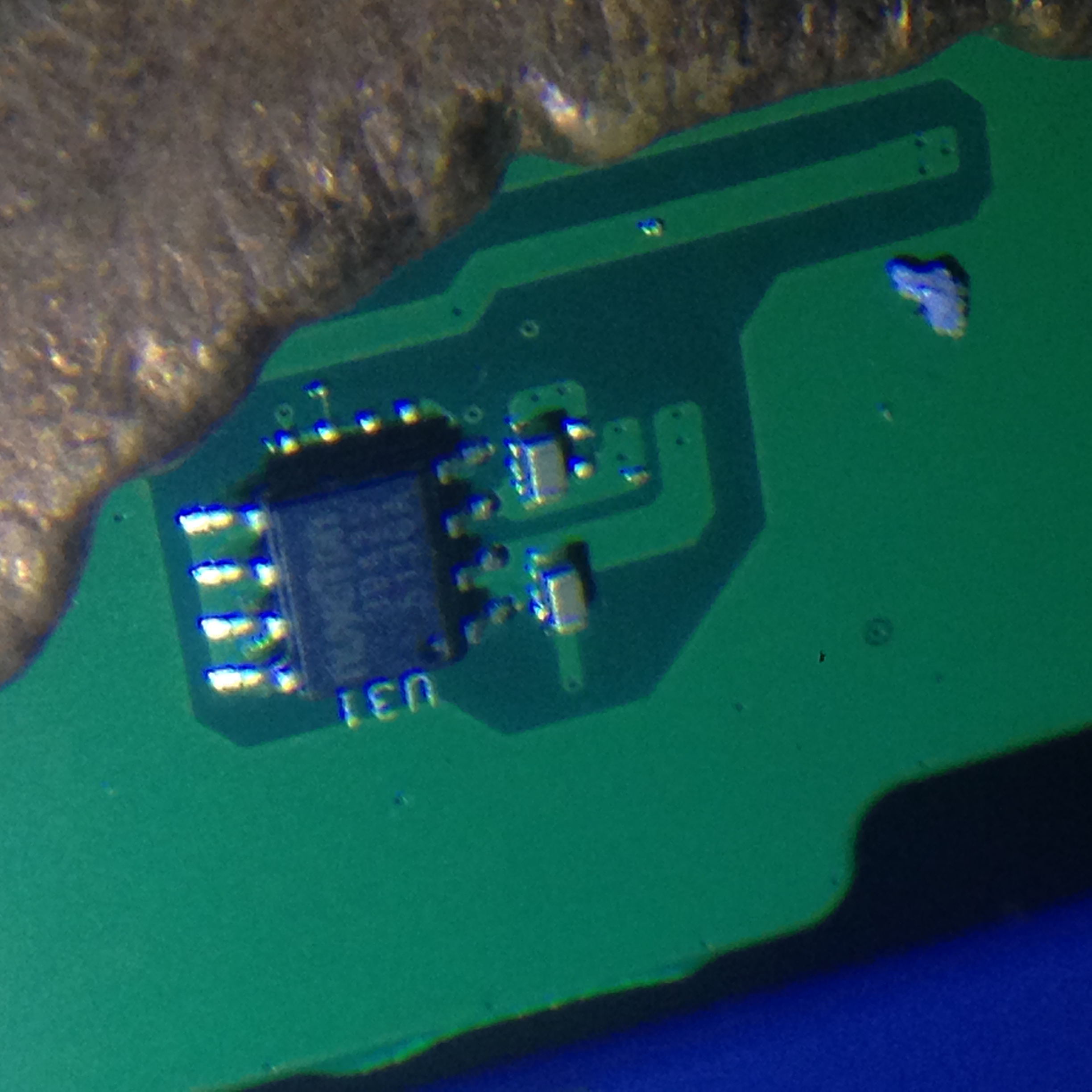

                Re: acer e5-473g bios needed
                Can you share pics ec chip?
                • Romulo
                  • Nov 2016
                  • 484
                  • Philippines
                  ok here it is the ec chip novuton 39425

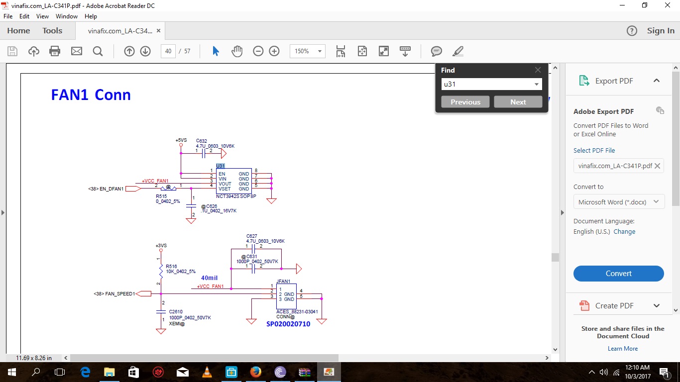

                    This chip is not ec.check schematic page 9 and search u31 you know what is.
                      that is the U31 in the board imranromi and schematic you upload it is NCT3942S SOP 8P novuton
                        I know i think is not ec bios if i not wrong ec bios not 4pins ground 1 pin ground check u31
                        5.6.7.8. pin ground no scl ,no sda.
                          @imranromi there is no other u31 on the board that is the only u31 and i cannot find any ec chip rather than that novuton it is 8pin chip and im sure this is the ec my only problem is cannot program because programmer not supported there is no voltage on each pin of this chip but in the bios main chip voltage present and also 3.3 and 5v ALW is present.can someone help me on this
