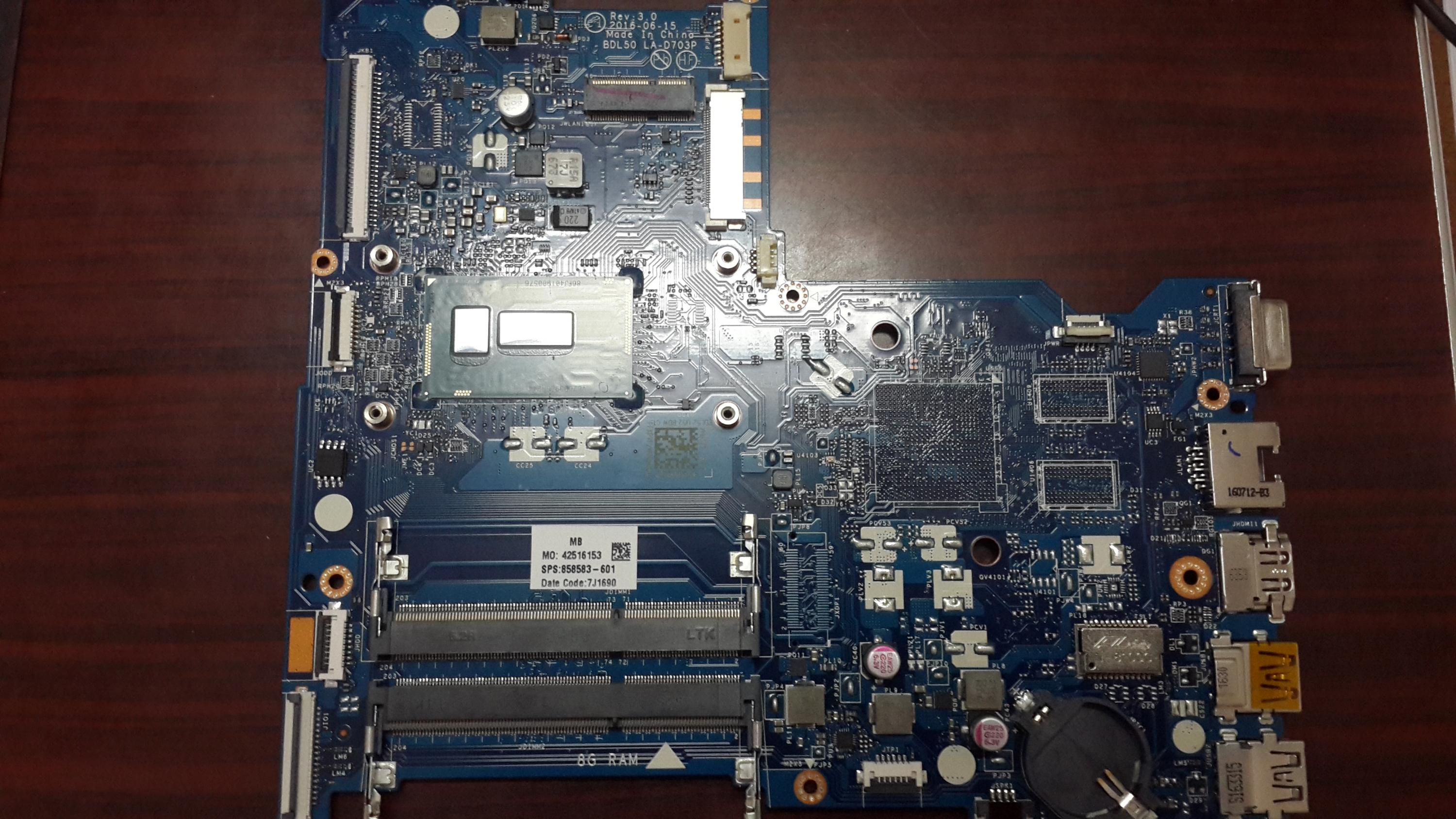

    Hi everybody,I am in great despair about a laptop HP 250 G5 which wont turn on.When power button is pressed, power led comes out, fan spin for 5-6 seconds and stop,power led also cuts off, only the led for charger in remains on.
    May be its a bad bios, as there is 3 volts on the bios chip.
    Please can some one send me a working bios bin file.Thanks in advance.

    M/B Part No???? Is it D702P??

      Hi, i will check it @ home, its a core i5 with no discreet graphic and 4gb ddr3.

        M/B part No: bdl50 LA-D703P - REV3.0

          check all powerswitched rails for short or no woltage

            1 Recap having not come across any 5 volt on the mb, 19v & 3.3 volt were present.Where should i look for the 5v, as i dont have schematic.

              Any schematic for the HP 250 G5? please.
              Here is the bios dump

                        No luck with bios flash, now board on & off every 5-6 seconds.

                          Pq 13 pin 1,2,3,5,6,7,8 grounded, Is this normal

                            Fault on chip 8A 3G B59, can someome give me the exact reference

                              Re: Hp 250 g5
                              Maybe this one

                                  Check on charger there you should have 3.3 and 5v output.
                                  If not then possibly need to change charger is

                                      3.3 volt rail is shorted in my mb, after injecting voltage, nothing but pch is getting warmer, anyone will tell me that if cpu is really damaged?
