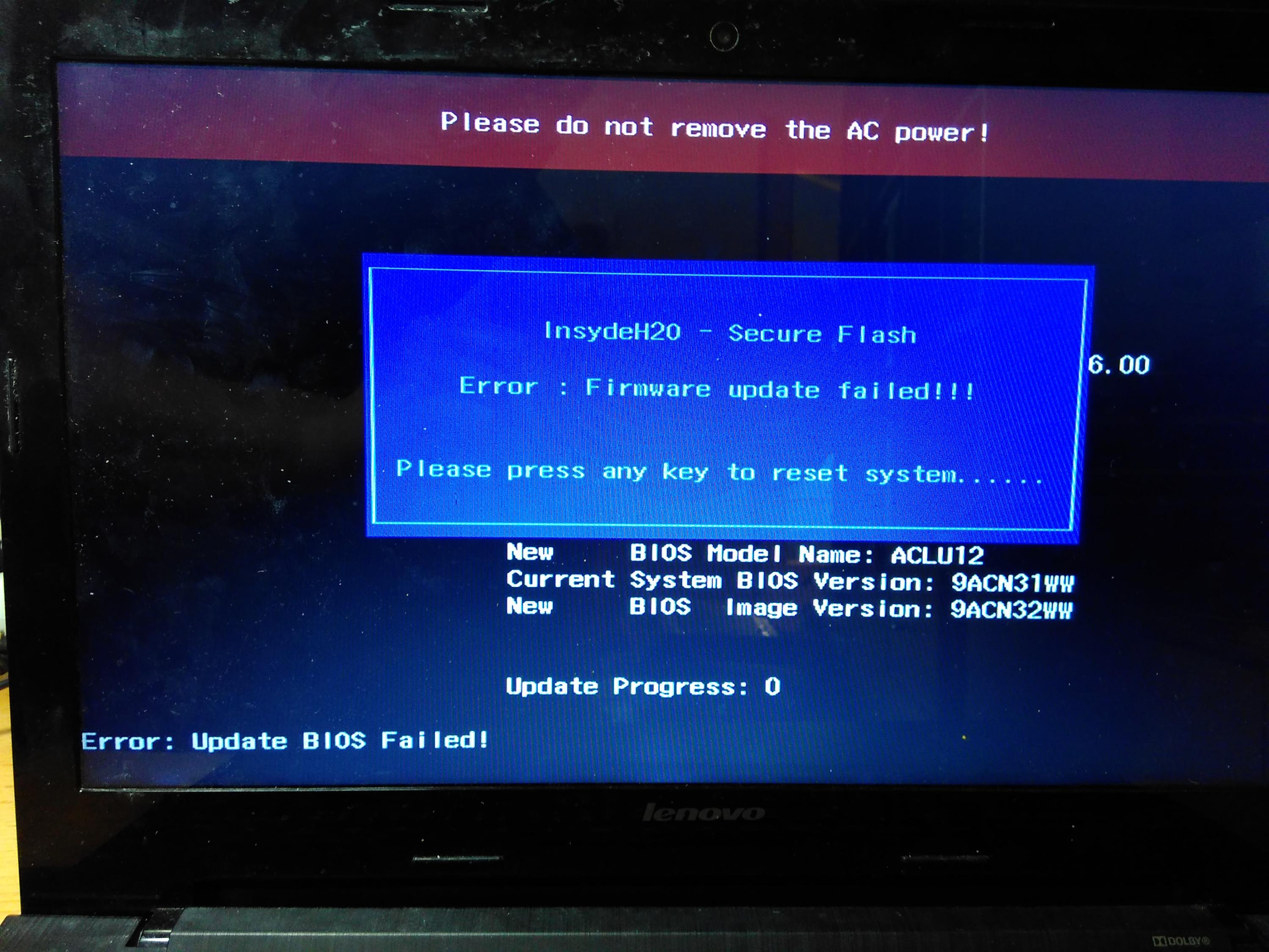

    I would like to ask for help with BIOS.
    I got Lenovo G50-70 ACLU1 NM-271 with no image and shut down after a while, so I downloaded BIOS dump (in attachements), reflashed, system started about 20s with no image and than I can see LENOVO on screen I can boot.
    Tried anothed image with the same result.
    If I try reflashed with downloaded BIOS, it failed (see attached picture).
    In some thread on this forum I read about fixing this issue by editing crashed BIOS with some part from working dump.
    Can somebody more practised and senior fix my BIOS please? It would be very helpful for me.
    Or recommend some BIOS utility for editing Insyde dumps.

    Re: FIX BIOS for Lenovo G50-70 please
    Updated information. When I reflashed "corrupted" dump to a new SPI ROM, laptop started like a charm. So I guess the problem was bad BIOS chip as I cannot erase a rewrite it anymore.
    So problem solved
