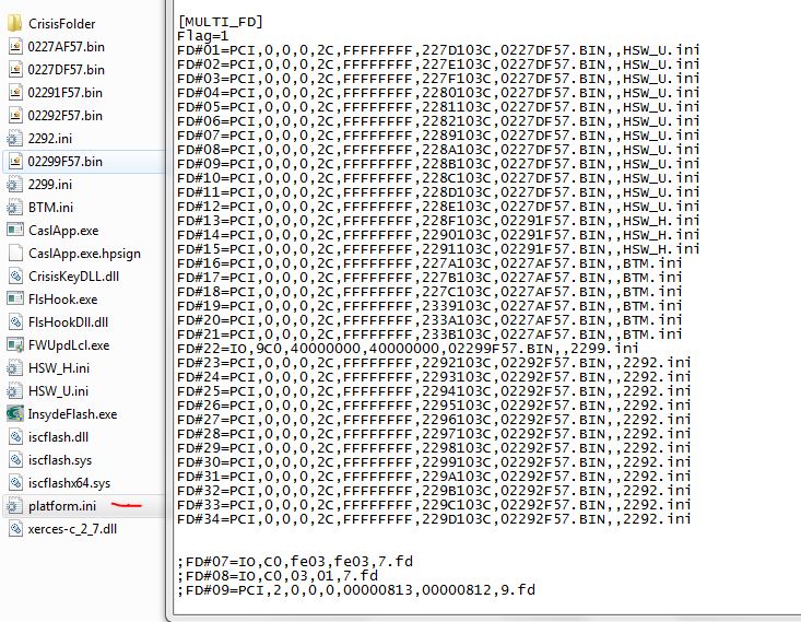

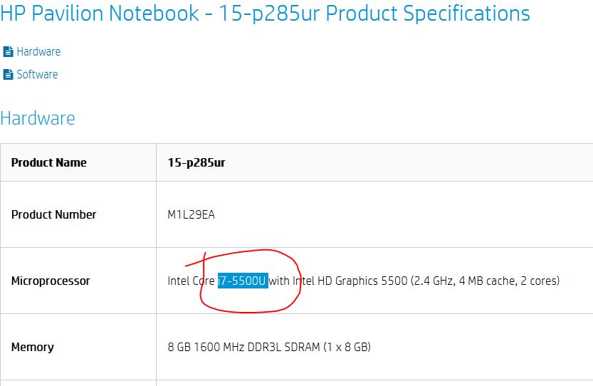

                          Go to the HP support site,enter the serial or model number, download the bios sp92961.exe ,run the exe ,choose copy to save the extracted decrypted bios to a folder. Extract the same exe using winrar or 7-zip to another folder,(don`t use the bios in this folder its encrypted) ,open the platform.ini file ,and check which bios is for Haswell-U .

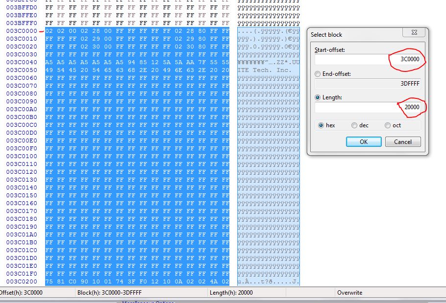

                          Open the bios with a hex editor,search for the word ITE ,select the offsets in the picture,copy the EC to a new file and save.
