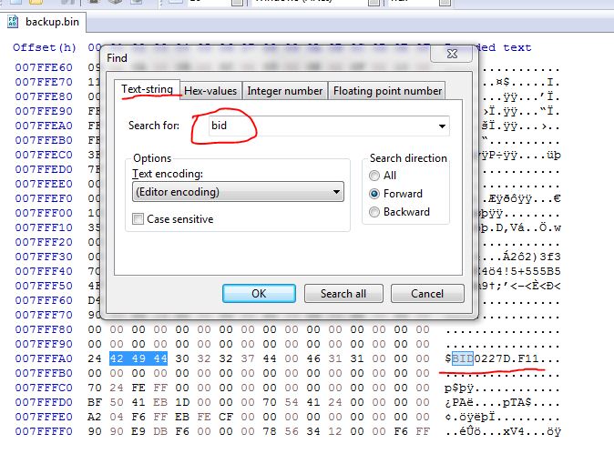

                            • BlueRay
                              • Jul 2018
                              • 20
                              • Indonesia
                              #54
                              Re: HP 15 DAY11AMB6E0 revE bios needed
                              [QUOTE=peste;1092684]
                              Originally posted by chalabi_mf
                              bios extracted from the HP site update, the laptop has five variants of your bios is 0227D
                              DMI 75E000 - 75E0FF
                              how to check version from backup bios?
                                • 22275
                                #55
                                [QUOTE=BlueRay;1097097]
                                Use a hex editor and search for the text word BID .Some others don`t have the word BID just the numbers/letters so you can search those instead for example 0277A,0227D,02291
