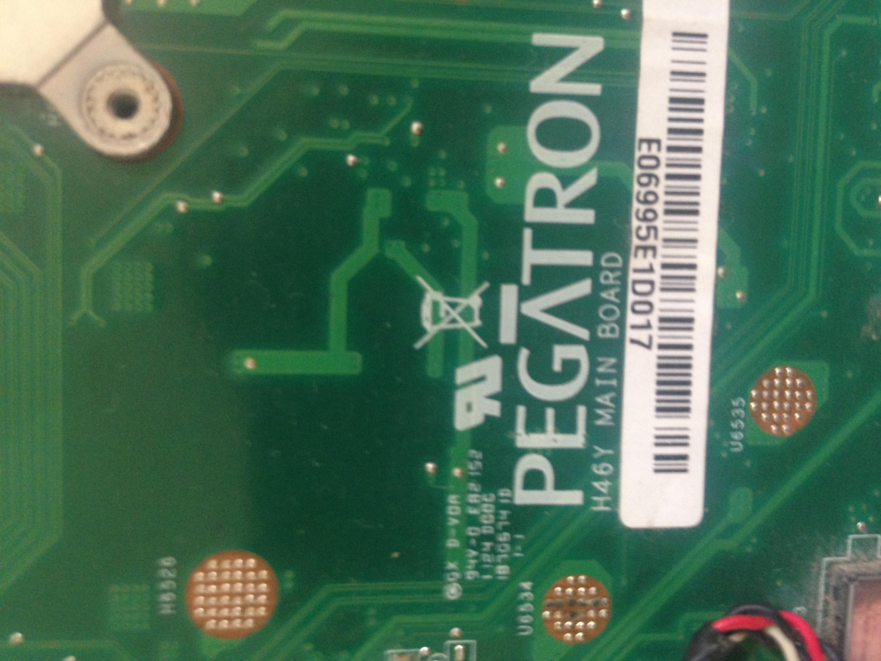

    I have thos Lg c500 at first laptop turns on display comes then after 20 seconds shuts off and nw when i turn it on again nw it shuts off for 2sec please help any advise please thanks in advance

    Anyone has a working bios dump file for this model please help me i need a working bios for this I have attached the image of the board id thanks

            I flashed the bios above dump still not working laptop turns on fan spinning very fast but no display.I have attached the original bios file can someone please fix this bios file please i need this file urgent. thanks in advance

                          If your laptop turns on automatically, i think the problem with the RTC battery. Please check it and reply.

                            Likely hardware fault, not software.

                              Rtc battery is ok I need a working bios dump file for this model or somebody can fix my original bios that i posted please

                                    1. Nothing wrong with biosfile was i uploaded above...cause that is from lg site...
                                    2. I think you must try to find ECBIOS... mx25l512 (64kb)...,or maybe someone in this forum have a backup?? Hard to find for free...pegatron h46y ecbios for it8502
                                    3. Backup your original ec first...
                                    goodluck bro

                                      Thanks for the response rioreno I already done flashed the EC with the file uploaded by tibd because the same size 64kb but it is not wrking after i flashed ec laptop has no power.can someone please share a working EC dump file for this model please.thanks in advance
