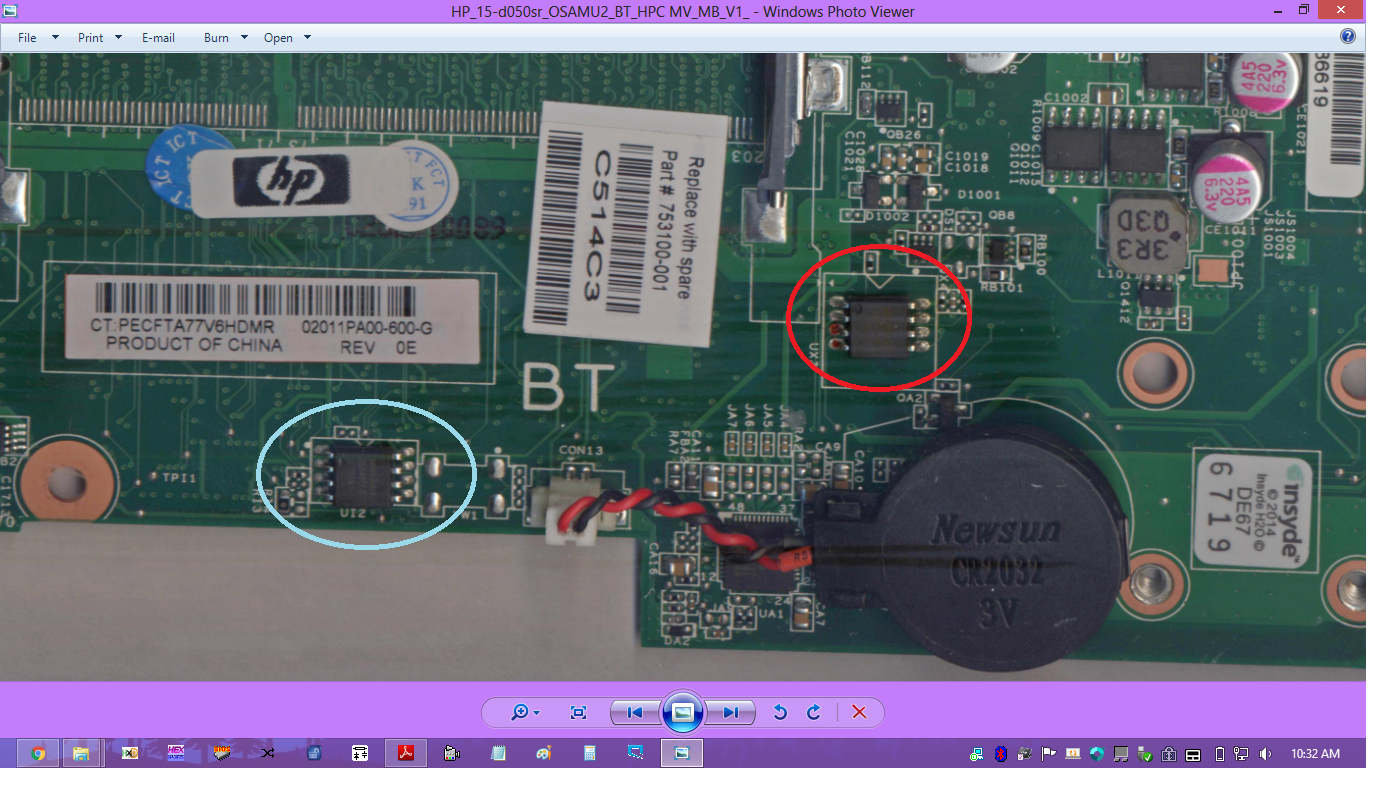

    Hi i m working with this hp
    (Main Board): osamu2_bt_hpc mv_mb_v1
    its come with black screen i need to flash bios first . i attach my dump .
    i need dump for hp 250g2 the original from HP website is different also the dump (Vinafix.vn_HP 15-d035dx OSAMU2_CR_HPC MV_MB_V1 SLJ8E 1M.bin) is different.

    Are you sure the size of bios 8.192kb for this unit?
    I've take look at osamu2_bt_hpc_mv_mb pics, there are two kind pieces of BIOS chips. one for EC and the other for Main.
    May be someone have been touched to modify .bin file the bioses.
    I've try to fix that file.
    Try and report back

        Thanks for your replies. my main ic is 8mb, and ec 512kb.
        i try all this dump but the same problem no video, no caps lock .
        all coils are powered , i have tried too reflow of cpu but no change, this machine come to me with scratched screen maybe is anything on board damaged. thanks anyway

                  Is UMA with logic i have tried near lvds connector i have 3v stable , and i checked the ram
                  on aspire-e1 and is ok. but the battery is scratched and lcd also i think this machine is dropped . i just bought osciloscope to check signal on bios ic .

                    try this UMA version bios MAIN and also here it is EC

                      tried this dump too , same problem no image.
                      i will check the slot of ram on microscope, this mobo have only one slot of ram.
                        Re: Hp 250-G2 osamu2_bt_hpc black screen
                        Thanks. It is working

                                for me the fixed bios from this post worked( 250 g2 fix.zip )
                                My board is OSAMU2_cr_hpc and it does not have dedeicated video and the bios is split in 2 parts:4MB and 1MB
