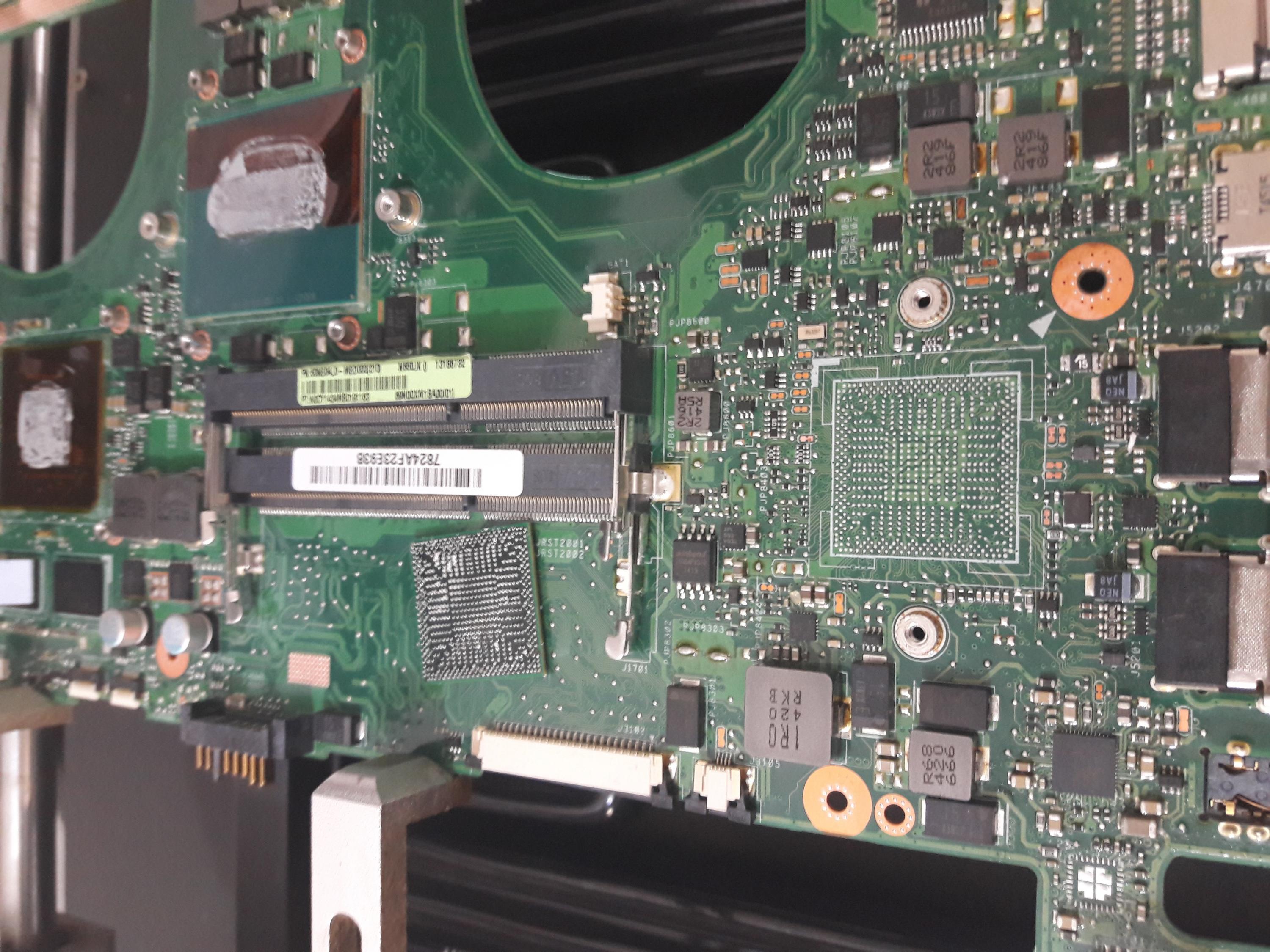

    Hello, i have this ASUS N550JV which out of the blue shorted both ITE and PCH chips, it just shut down never to power on again. I have replaced both, but now i need the firmware for the ITE IT8585E. I have the SVOD Programmer to write it, i am successful in communicating with the chip but i don't have the firmware to program it.
    Thanks in advance guys.

        My experience with IT8985E is that you can program it with the data that Asus included in bios you can download from Asus website, but, at least, in motherboard Asus X200MA, what you write into ITE, is re-writed again with data included in pch-bios, (when you power on laptop again) so at least in Asus X200MA, is a waste of time. (Probably this behavior is common in all laptop Asus motherboards)

            Any news? I have same problem, Short on KBC, changed, reprogrammed but no boot, no fan activity, only led and heat up.....

              Will take a look at it again tomorrow. In your case you may need to also replace PCH.

                    ok, next graphic chip order buy one PCH and try, thanks

                      PCH replaced, all OK!!! thank's my friend
