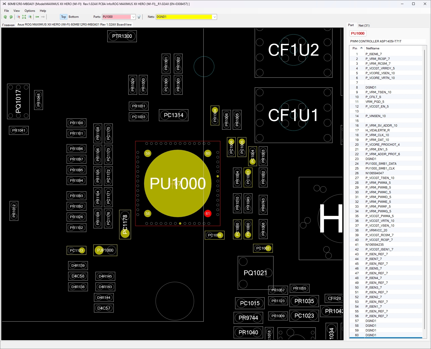

    Below I attach the PWM datasheet and the boardview for this board, maybe somebody hase a same problem to overcome.
    LINK to boardview -> https://www.badcaps.net/forum/troubl...ew#post3297189

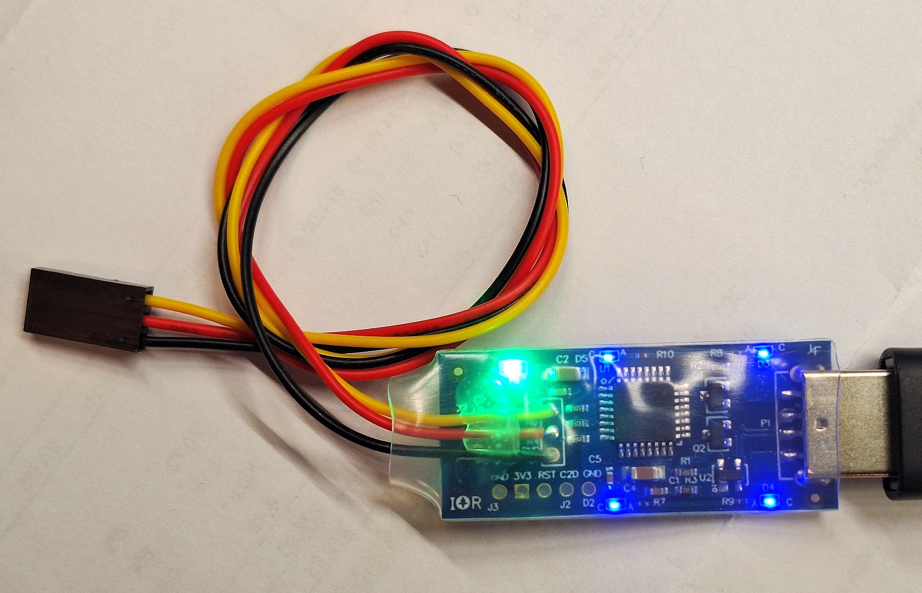

                      I have just received the chinese version of the USB005 and it works perfectly with the PowIRCenter software. Been able to read configuration file and registers from both ASP1405I controllers on ASUS MAXIMUS XII HERO (WiFi).
                      The "case" is pretty simple 😀, but cost is ca 2/3 of the original.

                            I also got me a USB005 Adapter but I really have problems getting it to talk to the chip. All I get is "usb error" or the software just freezes.
                            Were you able to read/write to the chip while soldered in or did you have to unsolder it first?
                            Did you just power the whole board or have you added a seperate 3.3V supply?
                            On my board the i2c pins seem to be connected to the superIO chip, might this make some problems?
                            • DynaxSC
                              • Apr 2021
                              • 475
                              • Poland
                              USB error means problem in communication between the adapter and the PC, as long as this is not ok it will not be possible to access any vrm by i2c. Look into device Manager if you see the adapter there and whats the status. I will on the adapter tomorrow, as I do not remember if there was anything to do, to make the adapter working. Let you know.
                              • C0dR
                                • Sep 2023
                                • 15
                                well I found the error, I had a small short between Data and CLK line, after removing it I got normal results. But still have some problems. If I use the I2C Adress scan I find 3 devices (0x08, 0x70, 0x71) but all of them just say UNKNOWN. I tried adding the device manually but it just says "wrong device" and I can't get it to detect the chip correctly. Any advice?

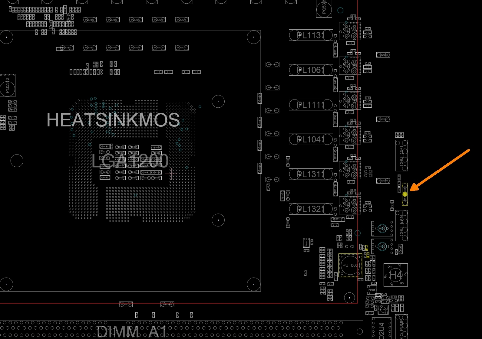

                                  Hi, 3 devices this is strange, I'm not sure what motherboard you test, but on the ASUS MAXIMUS XII HERO, I wrote about, the I2C bus has dedicated connection pads on the board (edge of the board near the VRM), there are no other devices on this bus - see attached screenshot from boardview:
                                  Click image for larger version  Name:	ASUS ROG MAXIMUS XII HERO_BV_shot.jpg Views:	0 Size:	444.2 KB ID:	3502657

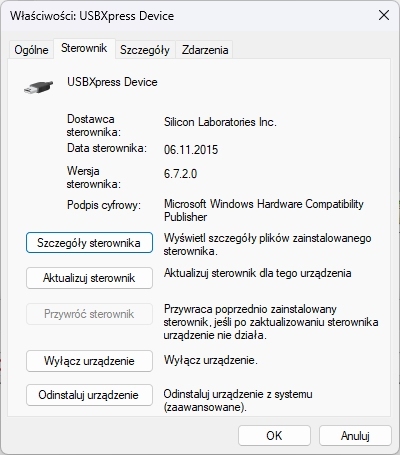

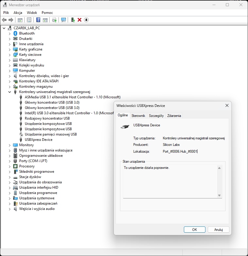

                                  Below also a screenshot in the device manager showing the USB005 Adapter - it is called USBXpress Device, the second screenshot shows the driver for it, it should install automatically:
                                  Click image for larger version  Name:	USB005_DeviceManagerView.jpg Views:	0 Size:	200.5 KB ID:	3502654 Click image for larger version  Name:	Driver.jpg Views:	0 Size:	72.3 KB ID:	3502656

                                    oh well, I see, so maybe thats my problem. There is no dedicated header on my board (Asus Crosshair VIII hero). It seems the chip is connected to a SMBus with many additional devices and DACs.
                                    Maybe I should try to disconnect the bus? But as the chip can talk both SMBus and I2C how to tell to use I2C?
