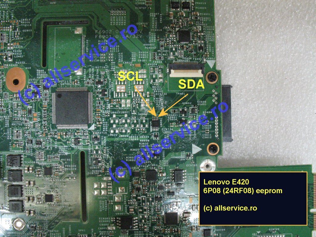

      Lenovo E520 Bios unlock
      HI ,
      everyone lenovo e520 bios locked plz help me to unlock
        • 20674
        Re: Lenovo E520 Bios unlock
        Originally posted by salmanlxm
        HI ,
        https://www.badcaps.net/forum/showth...20#post1012650
        Lenovo E420, E520
        These ones use SP08 eeprom (same as 24RF08).
