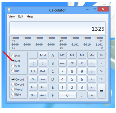

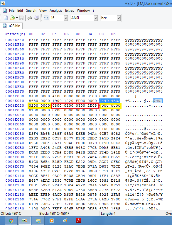

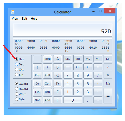

            How to determine ME region version using calculator (view>Programmer)
            1. open bin file with Hex editor (HxD freeware)
            2. Search Text String $MN2, the red box is ME region firmware version
            3. -08 00 = 00 08 = 8
            -01 00 = 00 01 = 1
            -03 00 = 00 03 = 3
            -2D 05 = 05 2D = 1325
            so the ME version 8.1.3.1325
