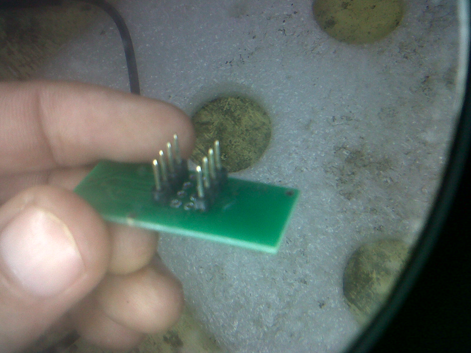

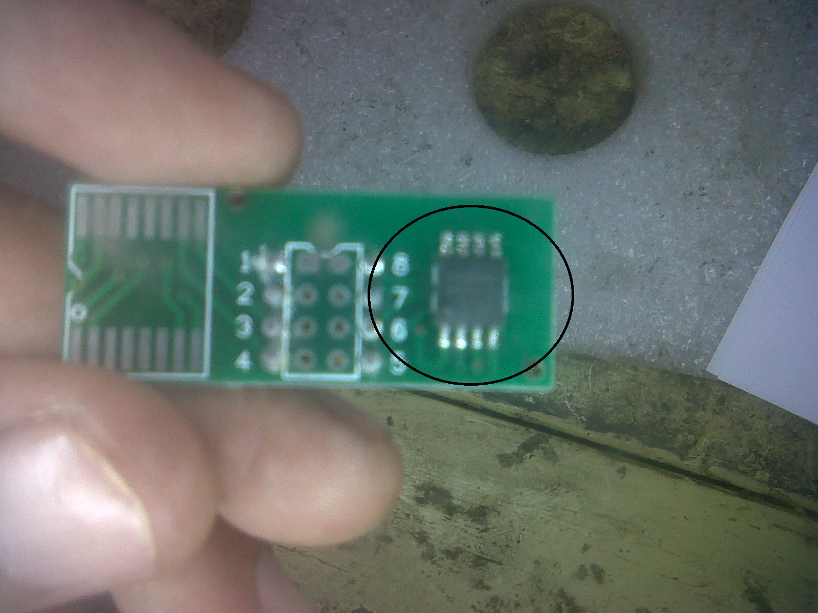

          you must remove the chips from the motherboard first. before doing so make sure the cmos battery has been removed.
          you must assemble mini board that legs are separated, unless you have soic8 208ml adapter for pinning IC
          solder the chip to mini board which have 8leg, then put into programmer

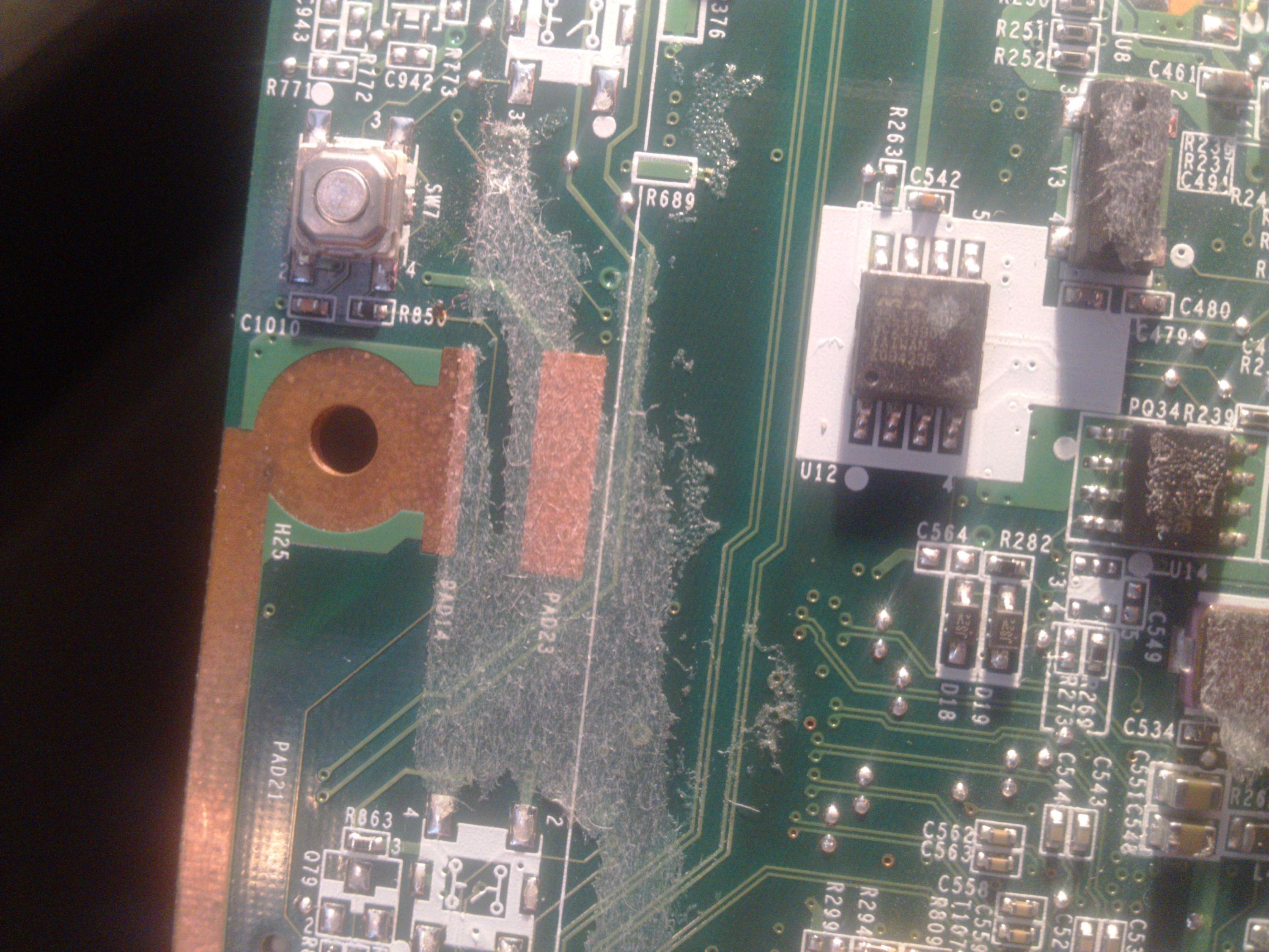

            So I found a chip on the mobo that has a big MX on it and under it it says
            2l16050
            3c233900
            Taiwan
            z094235
            I can't find any information about it online. Do you think that this is the bios eeprom?
            I've added a picture of it in the attachments

              UPDATE: The chip turned out to be a MX 25L1605D flash chip.
              I managed to successfully flash it with the rom file in the attachments and the laptop is working now!
