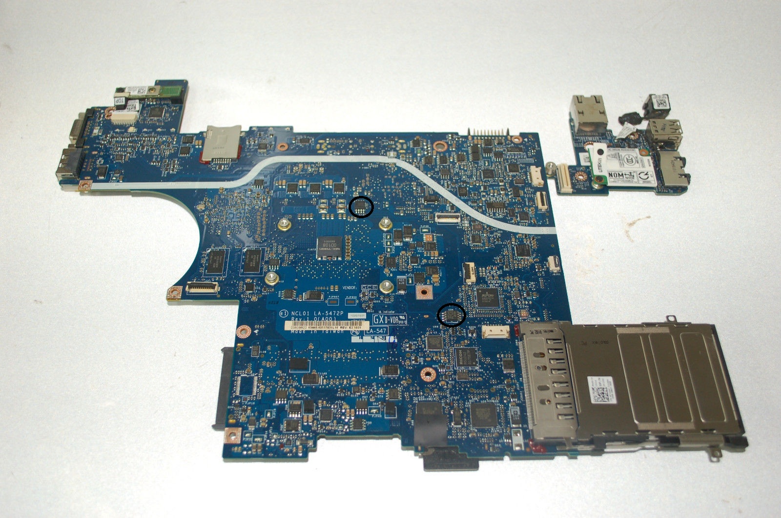

                          • wallyoz7
                            • Mar 2015
                            • 21
                            Re: Dell e6410 bios downgrade
                            sorry Nominal , I only have the bios files for Intel based laptop.
                            This picture is the location for bios chips on the Nvidia based laptop.

                                  • LatinMcG
                                    • Jun 2015
                                    • 73
                                    • USA/Puerto Rico
                                    actually the one you marked top is Bios (64).. flip board over on other side is EC (32)
                                    bottom right chip circled is something else.
