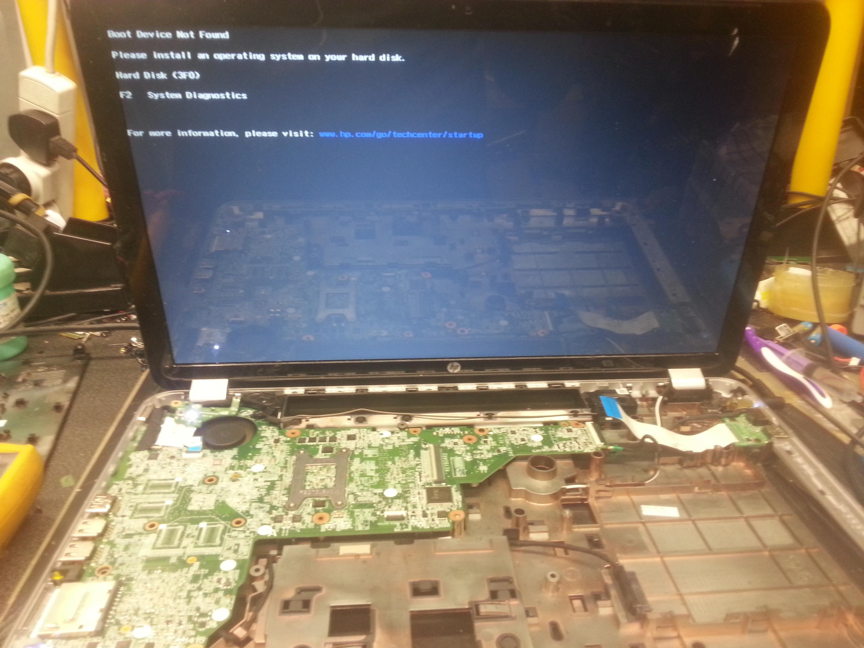

    hello dear working technicians
    can some one help me with a dump file for notebook?
    thank you

    of all people i would expect from you to post old dump or motherboard number
    anyways, backup old bios and try this, no serial, extracted from web update
    two different veriosn inside BID01982 and BID02139
    hope it helps

      Re: hp 17-e189nr
      Hahahaha i was writing to you exacly the same you said. Omfg
      And the comp did a restart and deleted 2 min of writing .
      lazy after work soo abandon and wrote from phone.
      Nvm something happen with the chip after i read it starting to give error on verify.
      Thats why i wanted to write you.
      Got the old file but tonight cuz only tomorrow i will work on that sh itty hp.
      I will attach the file with it and everything.
      Thank you
      P.s. This is foe SEO HP BIOS NO POWER NO JACK LIGHT

        Re: hp 17-e189nr
        ok, it was a joke anyway but we think alike
        if eeprom erases, writes but cannot verify its most likely faulty so its best to replace it
        you wrote that no light on power jack... that may be hardware fault but may also be the EC or EC bios... if board has second eeprom dump it as well
        if your power brick (adapter) has 3 pins, be sure to try with another known working one, sometimes middle pin get loose and it can do strange symptoms...

          Re: hp 17-e189nr
          this is the original bios!
          after i copy i try to verify and start to give me error.
          after a full erase i program it back and notebook came to life but no display.
          this is why is suspect the bios may be culprit.

            Re: hp 17-e189nr
            i can confirm that your dump is not working, but i have managed to determine bios for you
            and i fixed dmi data for you
            take attached file, erase eprom, write this file and verify... it must verify, otherwise change eeprom IC

                  Re: hp 17-e189nr
                  Perfect!
                  It sais manufacturer programming mode unlock.
                  Nvm it works im happy.

                    Re: hp 17-e189nr
                    im glad to hear that
                    if you enter bios and there is no serial num or model num the fix it with nbdmifit
                    (it should be, i copied that data from your dump)
                    that data can be found on bottom of the laptop or when battery is taken out
