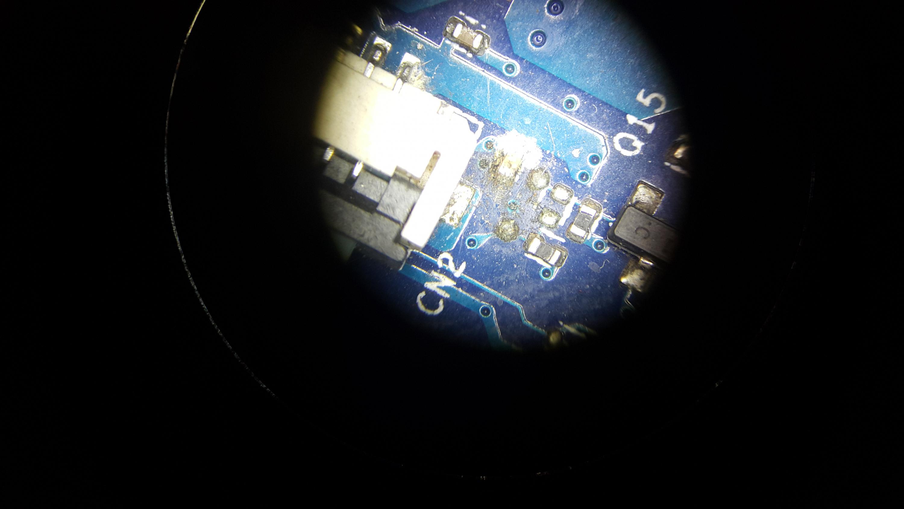

                    Thanks for your reply. i have seen no caps burned near IO , on pin 125 EC_PWRBTN# 3.3v when i press power button goes 0V.
                    The only suspicious thing I've seen one caps corroded near power jack. (see pic.) i have 3.3v on it no short but i removed this caps but no change.
                    I think definitely is BIOS issue no?

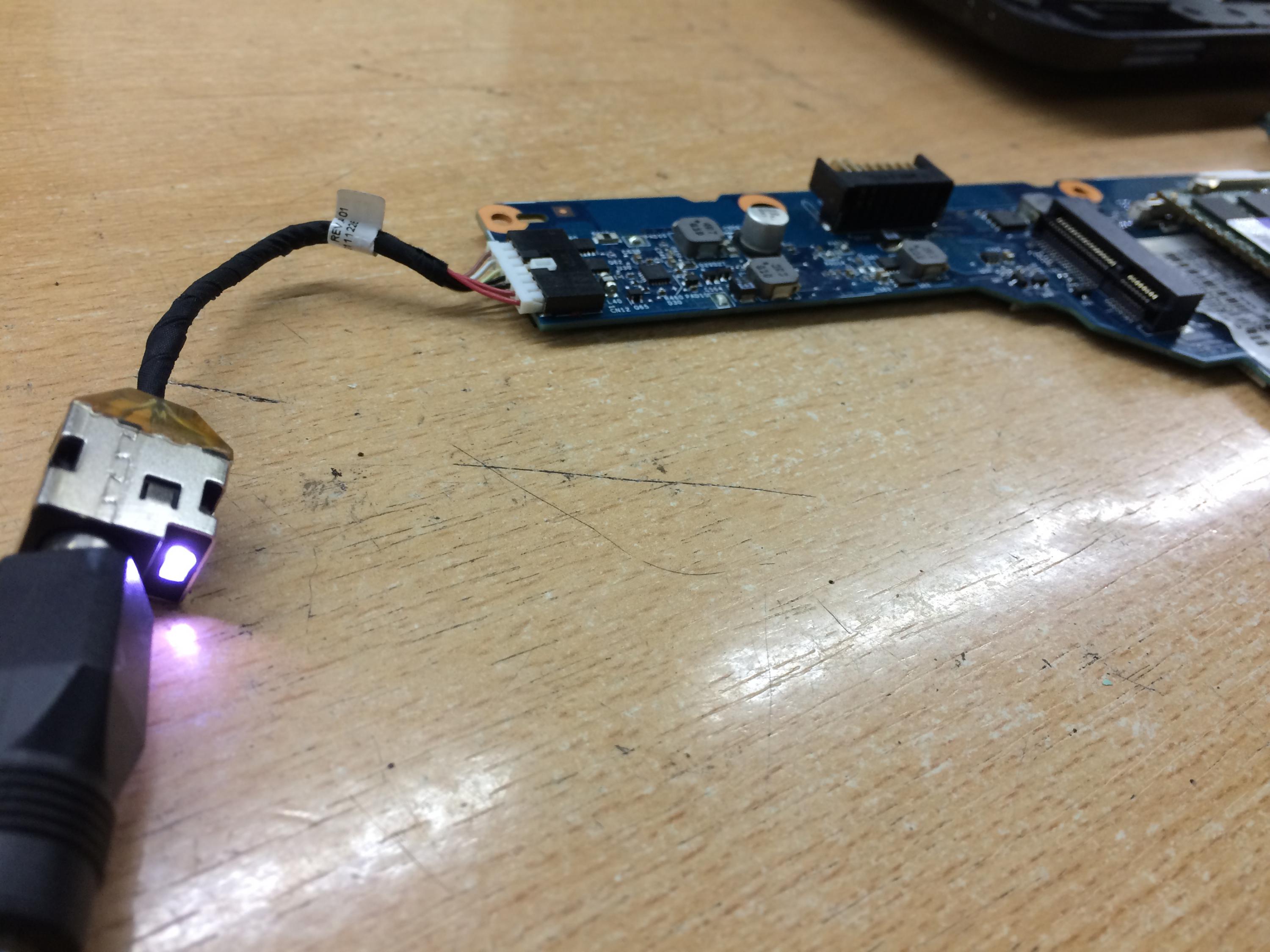

                                      Re: Pavilon G6 6050a2412801 NOt Power up
                                      Pavilon G6 6050A2412801 MB-A02 2011-04-29
                                      NOt Power up, but Light power jack.
                                      I have same problem, flashed bios but still giving problem.. please help
                                      • abhi0724a@gmail.com
                                        • Apr 2016
                                        • 2
                                        • India
                                        problem solved its charger problem, when connect new charger and checked laptop is working...
