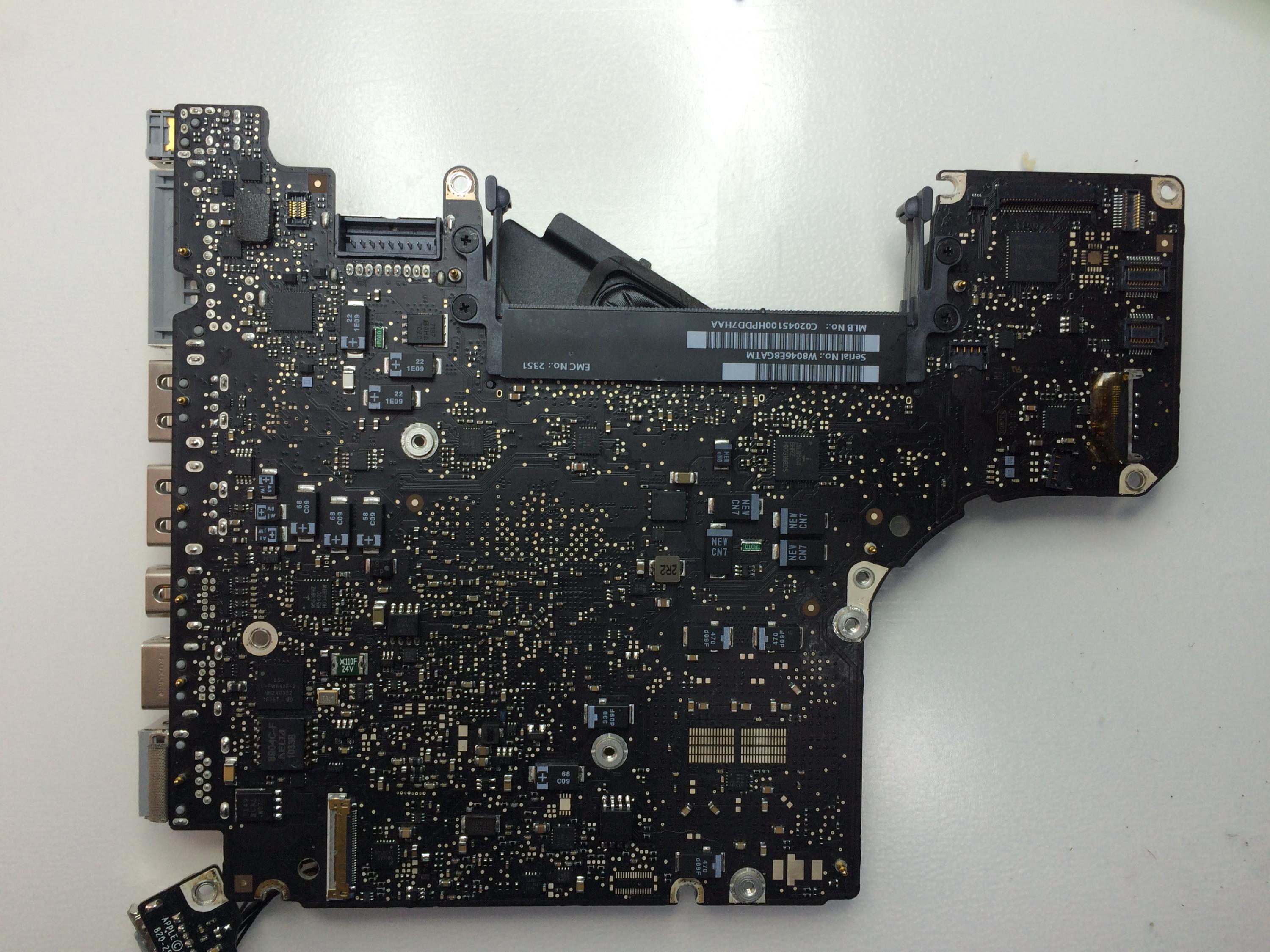

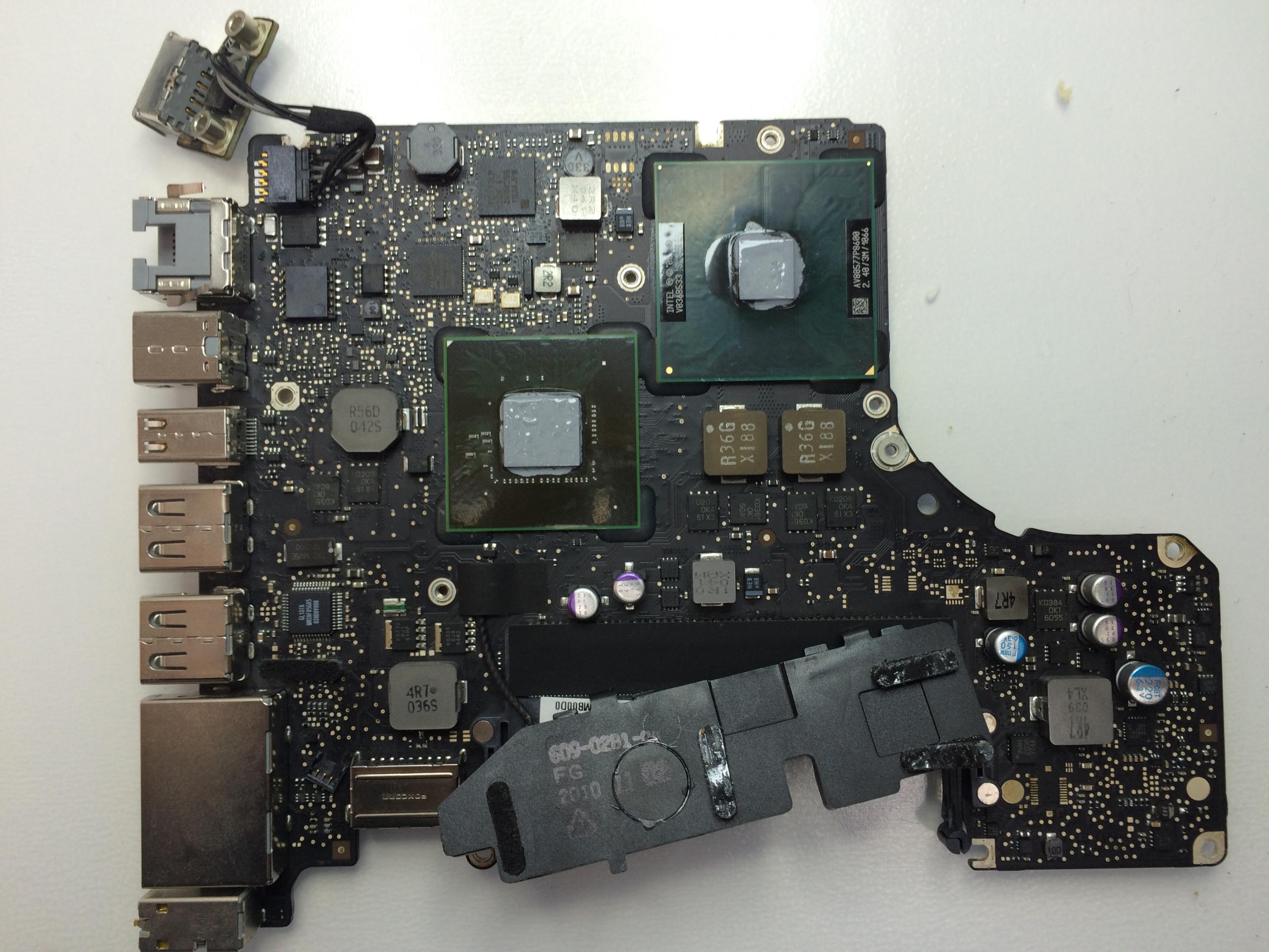

    a1278 emc 2351 bios needed ,
    i there, i got this MBP on the bench not turning on , i got orange led but not charging , charger is working fine , but computer not turning on or charging battery , even removing battery , computer still not turn on . Cheked bios this bios is a 4mb file , any clues ?
    also if anyone have a good dump for this model i apreciate.

    Re: a1278 emc 2351 bios needed ,
    just a few changes !
    the charger led is always green , once i press the battery cheker button on the left side of the chassi , there is no green led on the charge indicator . and computer does not turn on . im not use to work much on macs , but electronics is pratically all the same , but if you got a few tips were to search more first , would be nice . cheers

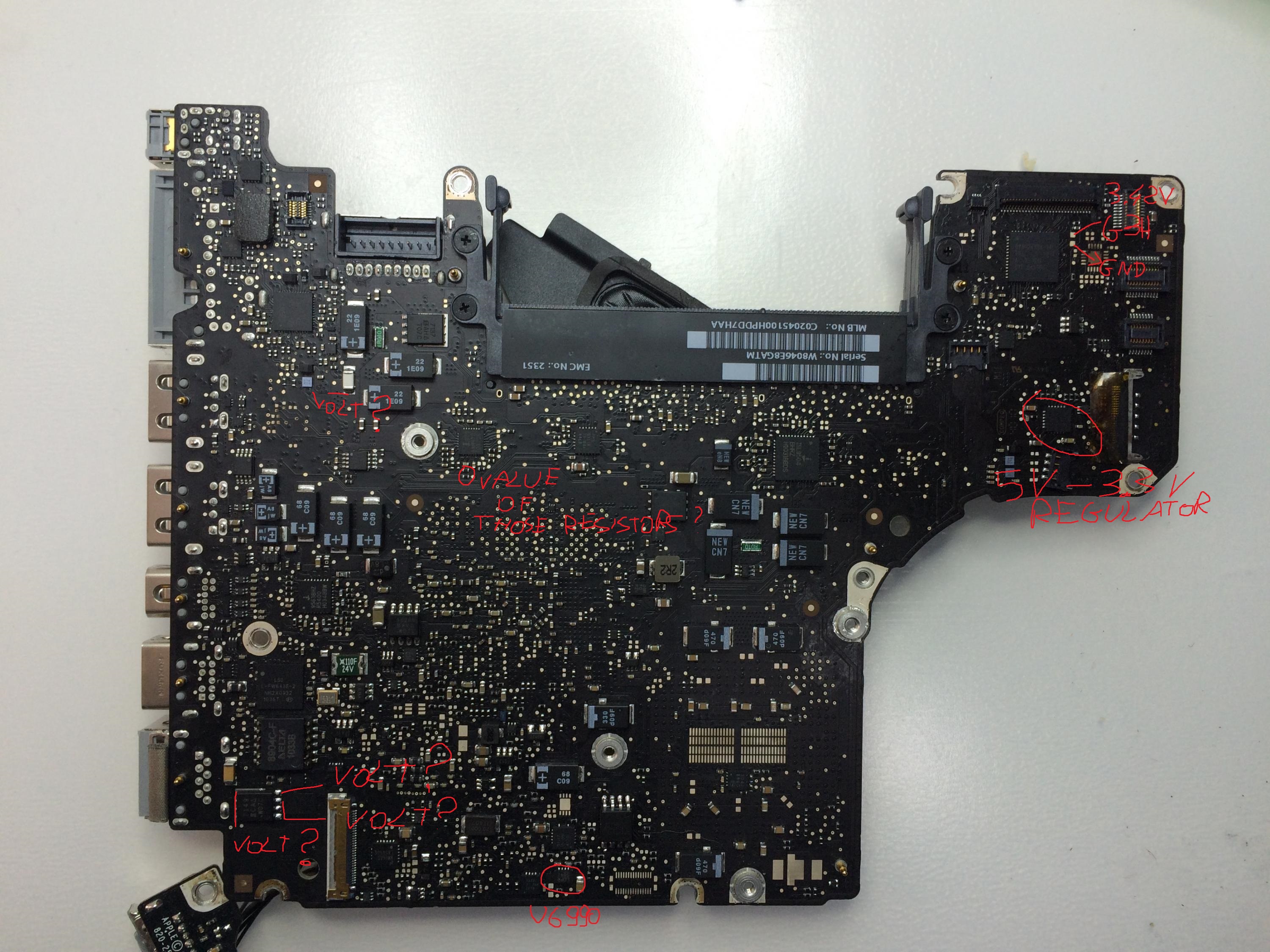

                      volt on pin 12 g3hot is low. it should be much near as 3.42volt. post volt on u6990.
                      u can find it with .brd.
                      u7000 get hot or had some corrosion ?
                      psu is fully working ?
                      volt on g3h pad in pic ?
                      if u short g3h+gnd macbook boot ? (place fan to see if it boot)
                      look image and report volt or value of resistor and component marked.
                      edit: image edited so look again.
                        i there mate , so u7000 is cold , and there is nothing hot on the board ,
                        regarding the values on the g3hot pins i got the same value 1.68v , and when shunting both pins nothing happen (drop to 0 ) .
                        pins for u6990
                          looking your voltage with coil, check also R6995 and R6996 if correct
                          on a working g3hot 3.38volt i have
                          1.22 (should be 1.25)
                          3.38
                          6.92
                          3.39
                          0
                          16.2
                          0
                          16.2
                          so all seems ok. just pin 1 is a bit higher.
                          check those resistor r6995 r6996. if ok remove L6995 and post back U6990 voltage.
                          edit: up you said on u7000 pin 12- 2,38-2,58 volt, so u sure on g3hot pad show in picture u have only 1.68 ?
                            R6995 i got 1.30 volts on the left side and on the right side 3.40 (directions seen on .BRD) R6996 0 volt on left side , 1.32 on right side .
                            on u7000 now i got on pins 12 and 13 3.40volts ... this machine is really incostant with values .
                            btw the resistors r6995 and r6996 are ok on they ohmic value .
                            yes the g3hot pad give me the 1.63 volts
                                      plug in psu, put back heatsink, put fan, remove keyboard.
                                      on the back check 3.3 and 5volt coil if volts are present.
                                      if 3.3 present, try short g3h and gnd pad.
                                      • highpulse
                                        i hate HP
                                        • May 2013
                                        • 1488
                                        • portugal
                                        on the picture you sent , you asked me to give you some value , so here they go , the first mosfet got 16 volts on both sides , the 2 resistors near the u7000 , does resistor are r7010 and r7011 , and the voltage values are
                                        R7010 4.06 left side , and 17 volts right side of the resistor arounk 30K ohm
                                        R7011 4.04 left side and 0 volts right side , around 9.3kohm (cheked with schematic and both ohm values are correct.
                                        for TPS51125 , like i mentioned with keyboard ribbon i got some values , without ribbon i got outher values
