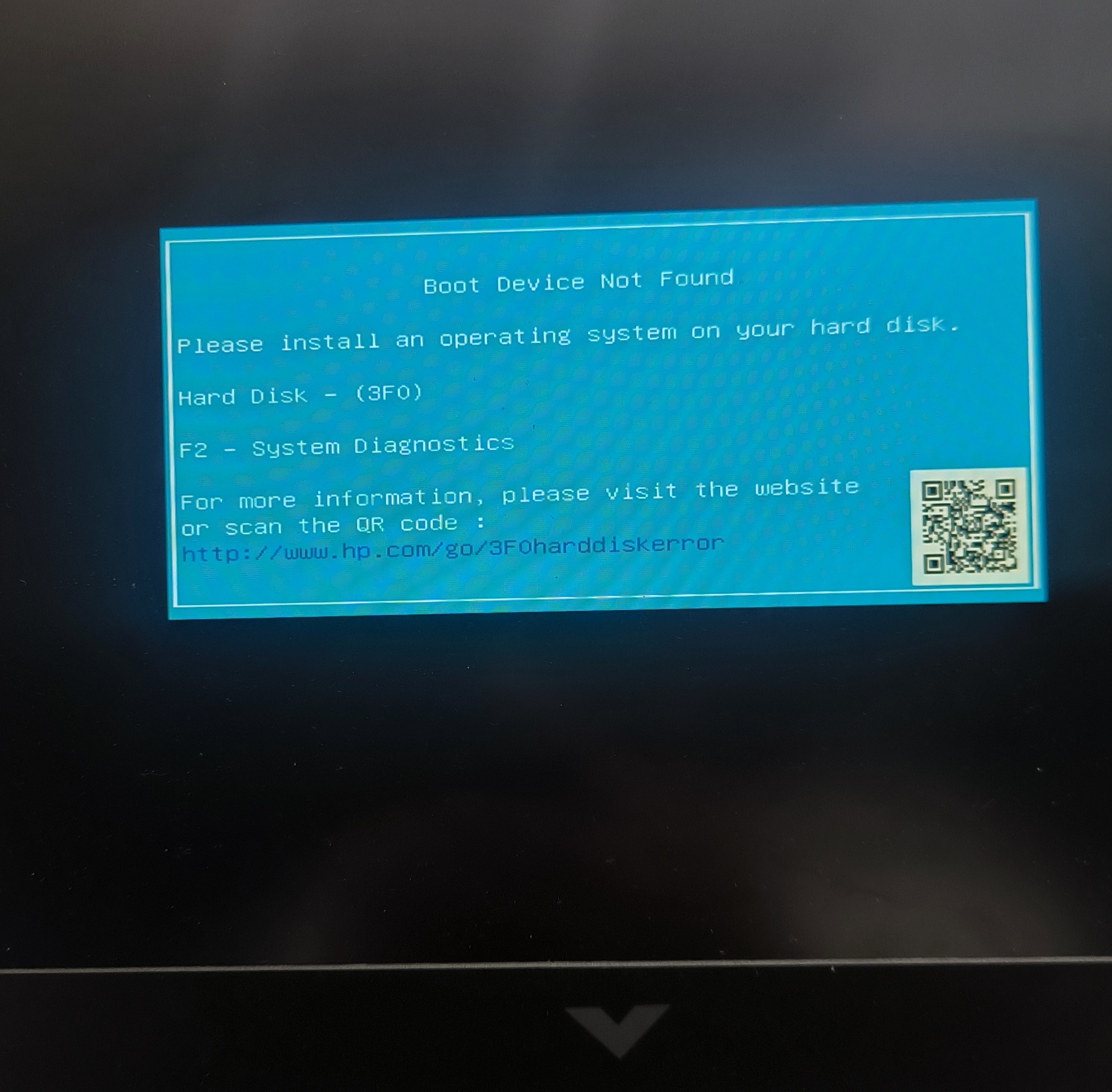

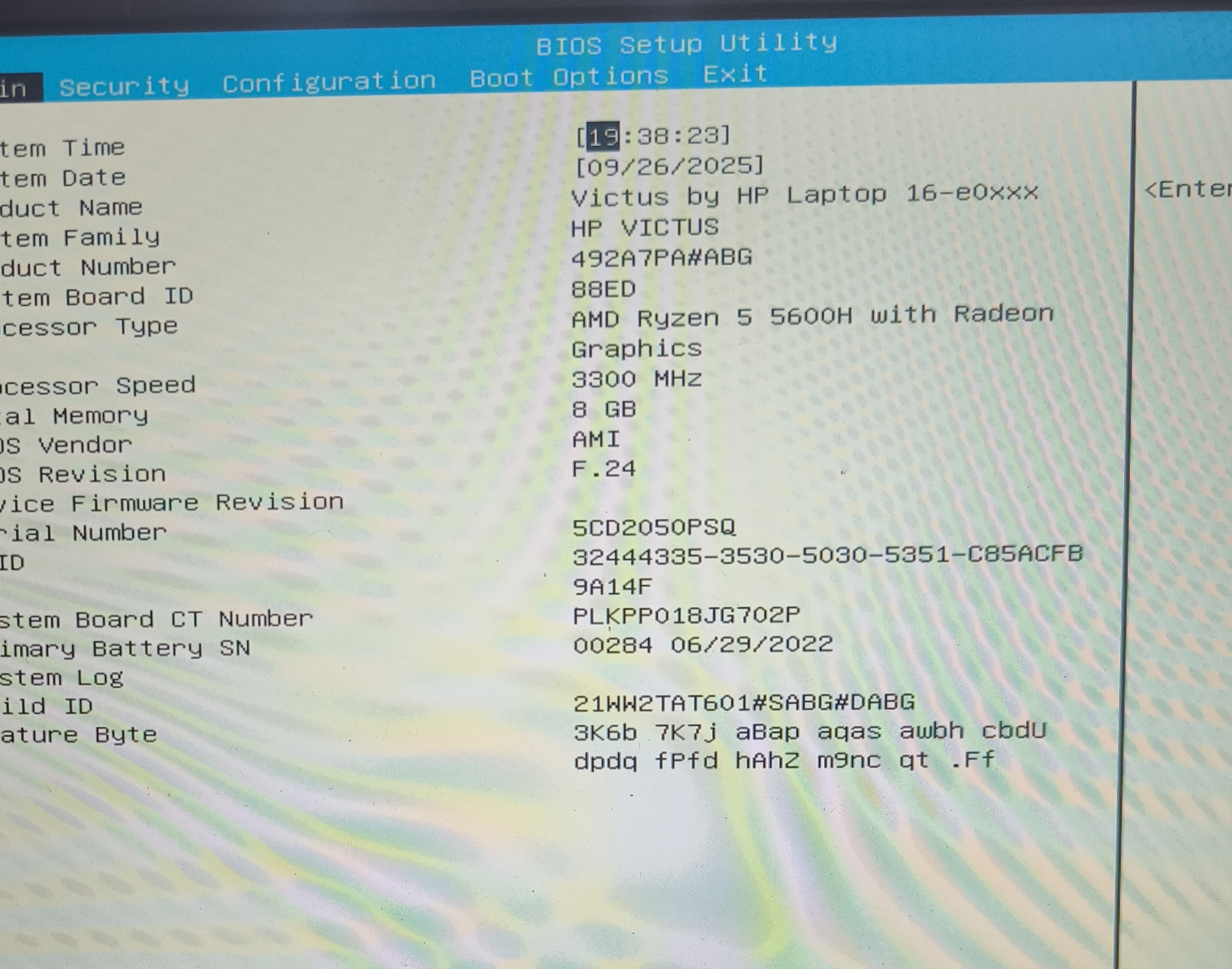

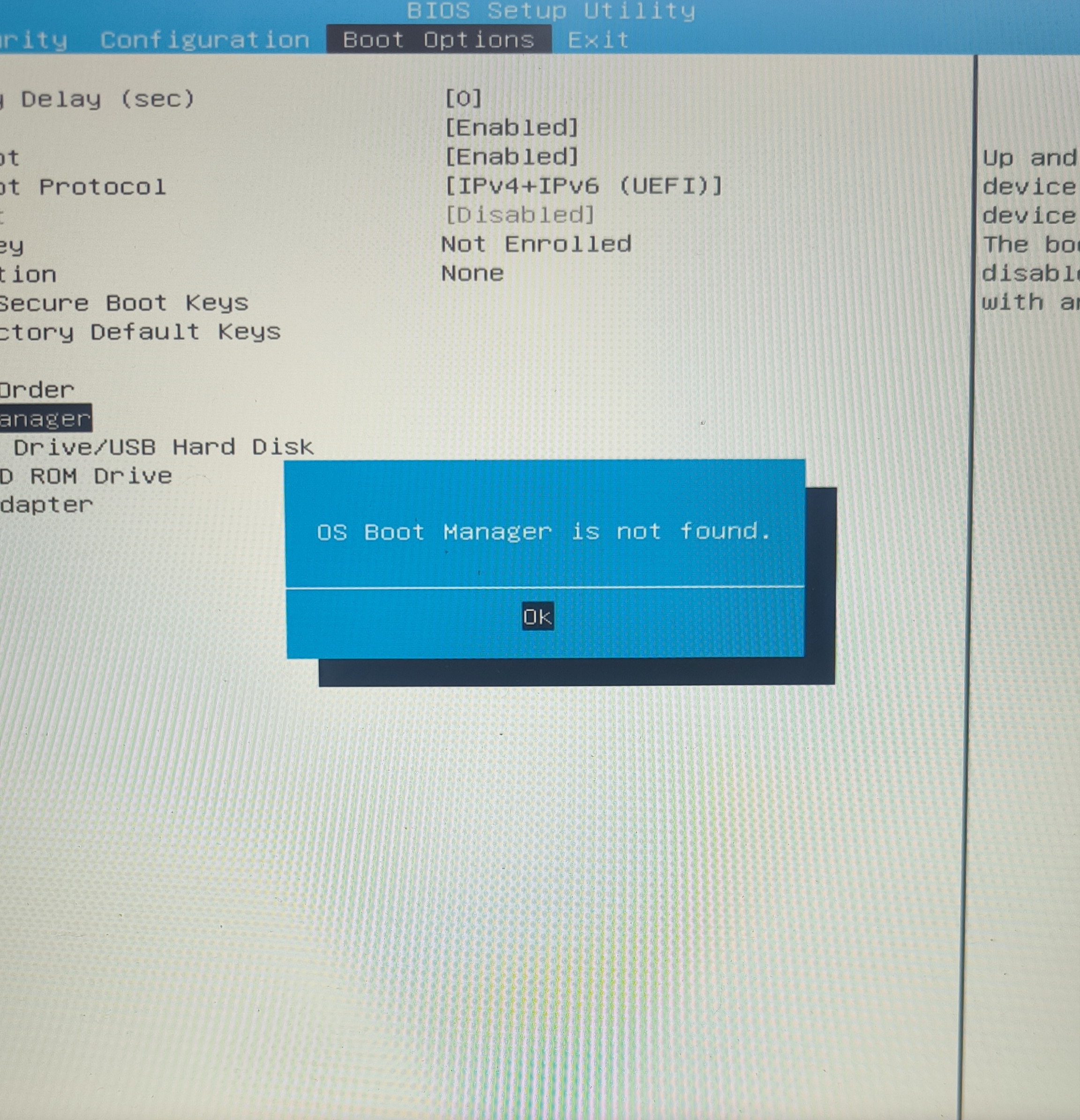

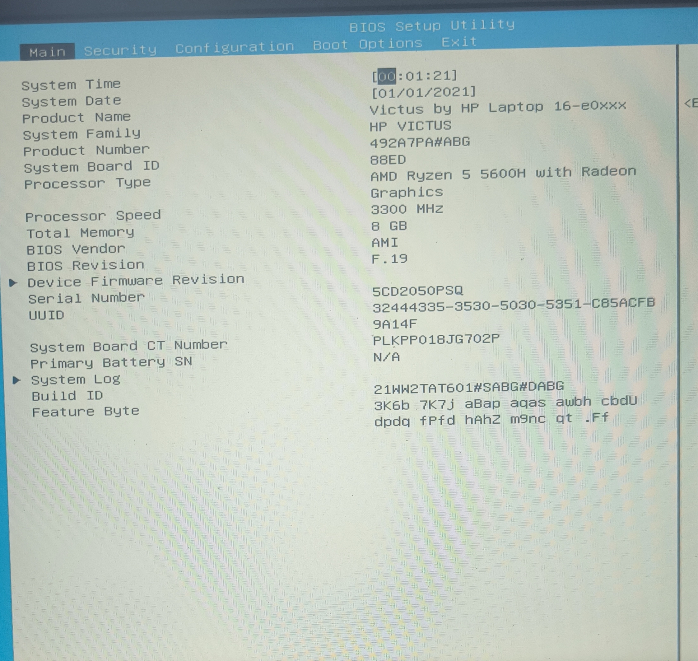

    hello dear friends
    I recently bought this motherboard and I'm having a lot of problems.
    - The Wi-Fi doesn't appear in the Network Card in Device Manager (The Wi-Fi card and the Wi-Fi work fine when I installed the old motherboard)
    - The hard drive is missing when i reboot the system and reappears when i reboot again (crtl+alt+del).
    - When I tried to do an internal BIOS update it doesn't work it always fails.
    Can someone help me update the BIOS or give me a new clean BIOS?
    hp Victus 16-e0xxx
    SN 5CD2050PSQ
    Thank you in advance.

    Victus by HP Laptop 16-e0052AX (492A7PA)

      Thank you very much for you attention 🙏 but the same Failure persists (hard drive - wifi)

        Check hardware , this is a new bios file from HP homepage.
        • Yacine007
          • May 2024
          • 92
          • Maroc
          Yeah that's what i think ( hardware issue )
          Thank you very much for your attention im very grateful 🙏👍
